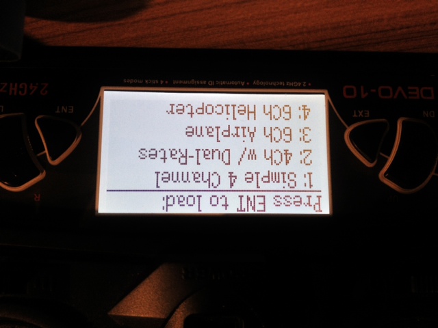

hmm.. just got to the page for loading a template, but although it says "press ENT" to load, I can't select any of the templates by pressing any of the buttons!
UPDATE: I managed to hold down one of the keys by pure fluke, and it let me in - having loaded the config file it does appear to have overwritten most of my values I've set - also, the elevator control appears to use only the front servos, which I understood to carry out aileron control only? The rear servo in the anti-rotation mount only provides pitch adjustment, and ignores elevator inputs - some more fiddling required... I can't wait to get this one in the air, but it's currently being decidedly naughty.

Replied by rbe2012 on topic Hello, and help required with a flybar 450 swash!
This question is quite old.
In the actual version it works like expected - one entry is highlighted and loaded when pressing ENT.
