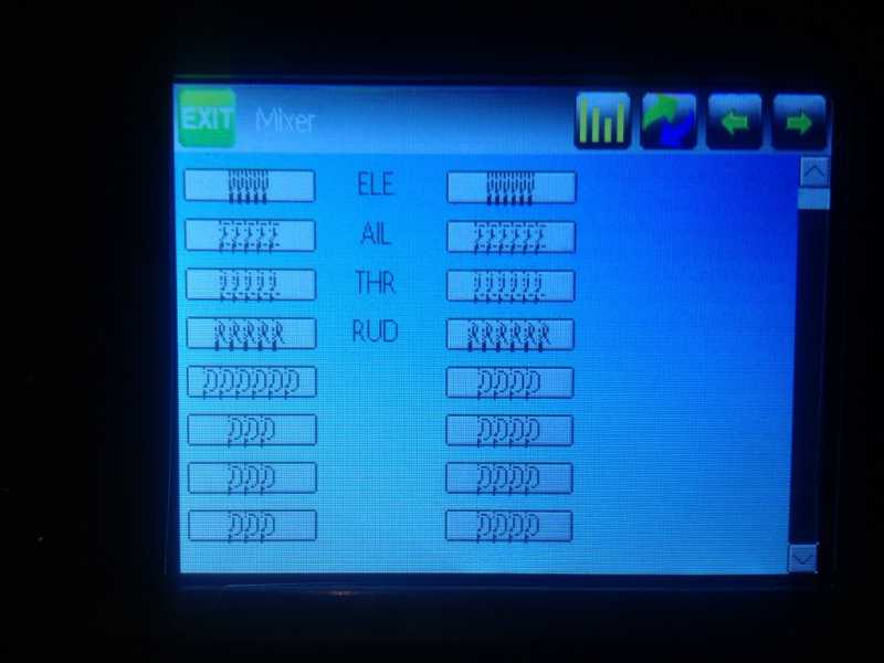

I got a 6s in the mail this afternoon and tonight I got a chance to flash it with Deviationtx. everything has gone smooth until I tried to use the tx.
All of those pretty tabs, menus, etc are texted with gibberish. Dunno what I did wrong but this thing is unusable. See the attached pic for an explanation.

Some font is missing or damaged. Try to rewrite media directory at Tx filesystem (from filesystem archive).

You were right. Problem was I had followed a link for a 2.something version of the fs, doh. With the correct fs everything seems to work well
