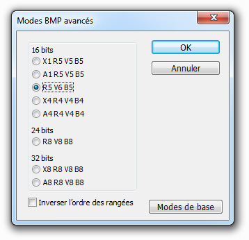

If you see any color shifting try A1R5V5B5 (or A1R5G5B5 in English program versions) - this is the normal bmp mode all deviation picture files are stored. It means 1bit for transparency and 5 bits for each main color red, green and blue.Maybe your picture is interpreted different:So light red parts can be displayed transparent and light green parts will be displayed in red.
ARGB-format:
Bit 15...0: ARRRRRVVVVVBBBBB (or ARRRRRGGGGGBBBBB)bit 15...0: RRRRRVVVVVVBBBBB (or RRRRRGGGGGGBBBBB)
--> v\___/\___/\___/ v\___/\___/\___/
A R V B ( A R G B )
