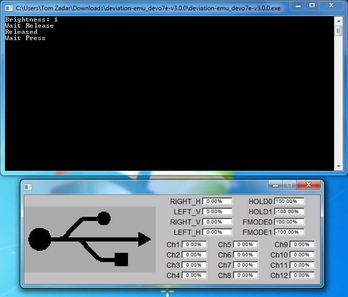

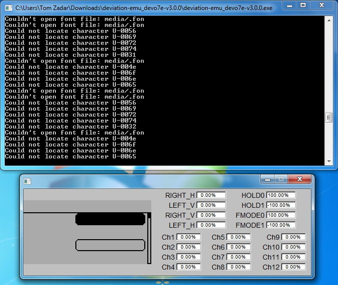

I have been using the Devo 8 & 10 emulators both versions 2 & 3 to make models to post on this site. I want to try the Devo 7E emulator again. When it first came out I couldn't get the menus to display correctly.
I just tried the current nightly builds of the emulator and file system but I can't get the menus to display correctly with these versions either.

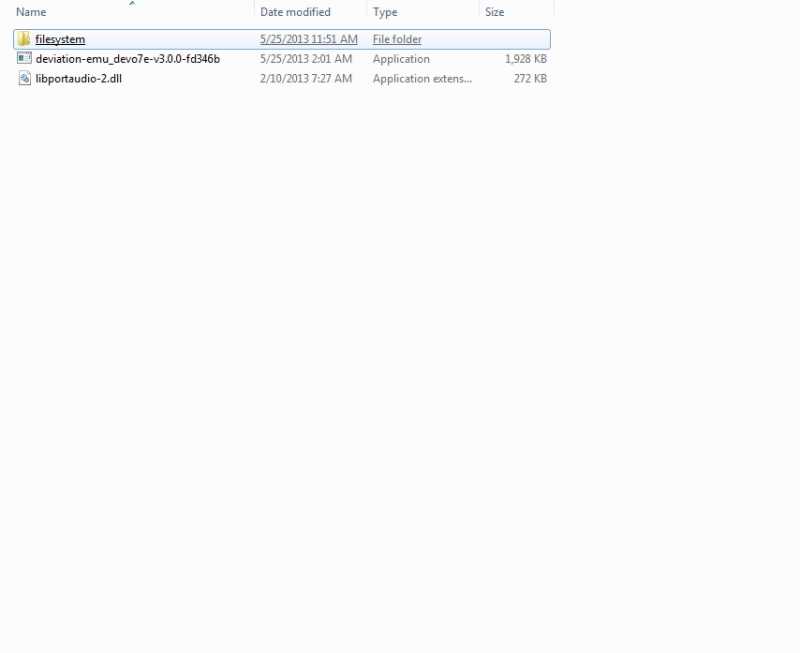

I included some screen shots of the current nightly build of the emulator and file system.

It looks as if something is wrong with the file system. You should have a folder "filesystem" contasinint "devo10" ind therein "models", "media", ...
If the mmedia directory is not present (there are the font files inside) you get this USB symbol (to point you to an unformatted USB filesystem when you connect a real Devo to your pc).

Rename devo7e folder to Devo10
libportaudio-2.dll
deviation-emu_devo7e-v3.0.0.exe
filesystem\devo10\
media
modelico
models
template
tx.ini
errors.txt
libportaudio-2.dll
filesystem\devo10\
media
modelico
models
template
tx.ini
errors.txt

Thanks rbe2012 and vlad_vy.
Renaming the devo7e folder to Devo10 worked.
