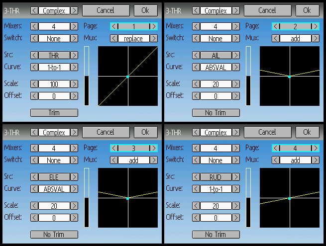

with the original firmware there is the option "mix to throttle" to maintain rotor speed when operatiing the Aileron, Elevator servo, and Rudder servo
is it possible to reproduce such a mix?
" Add XX% of THR when AIL ELE and RUD operate "

Firstly welcome to the fantastic new world of custom firmware for radio, and now the serious things began
To do what you want you have to make a complex mix with 4 mixer on your throttle channel:
- The first one is the throttle himself (a 1-to-1 curve while work perfectly)
- The second and third is for aileron and elevator respectively in my example: it’s an ABSVAL curve with the scale set at XX% you want (20 in my example).
- And for the last one for the rudder compensation you use a 1-to-1 curve agan with the scale at XX%. You may be have to change the type of curve for the rudder compensation because I’m not sure for this one.

Merci en fait c'est bon ça fonctione avec ton image !
juste j'ai modifier en " ABSVAL " pour le Rudder aussi
j'ai aussi changer pour 5 au lieu de 20 sur les 3 chaines AIL/ELE/RUD
Merci a toi amis patriote
Thanks , finally that's good ! with your picture!
I just modify "ABSVAL" for Rudder also and 5 instead of 20 for the 3 chanels AIL/ELE/RUD
Thank you very much
