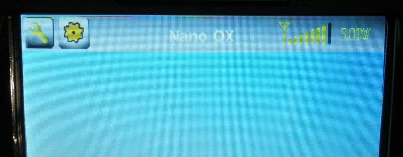

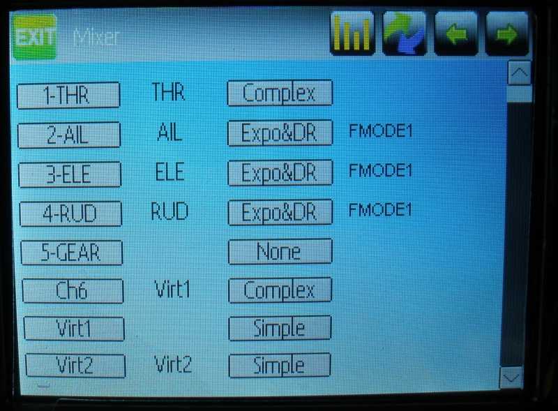

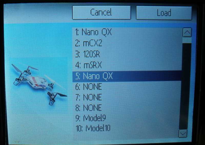

Replied by ChrisLevo on topic Devo 6S to Devo 8S
Thank you both.
I did that, and now have a sparse GUI.
I have shown the opening screen, and what happens when you touch the icons on the left, and the model name.
Can anyone please tell me what I did wrong?
Chris

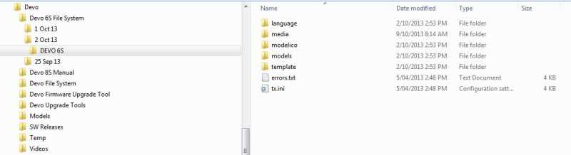

24 Oct 2013 03:14 - 24 Oct 2013 03:19 #14912
Replied by vlad_vy on topic Devo 6S to Devo 8S
Empty Main Screen? Seems you use wrong filesystem. Are you sure that you use filesystem with the same version as firmware?
Check missing 'layout' folder (and files inside it) at filesystem. At least you have to get default layout for new GUI, but you got empty screen.
What firmware file do you use?
What filesystem file do you use?

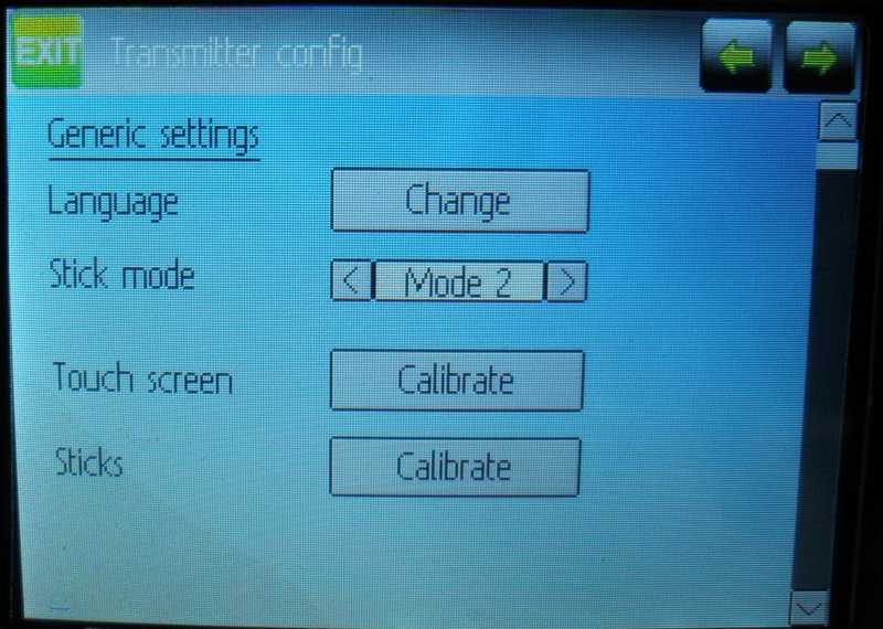

24 Oct 2013 04:05 #14914
by ChrisLevo
Thank you, Vlad.
I don't know why the Media folder had not loaded, so I reloaded it, and all works fine
I just bound to my Nano QX, and dual rates and SAFE/Agility mode switches work fine.
What I do get at start-up is a message "Ch1 is -95%, safe value is -100%" and I cannot change this by recalibration of my sticks.

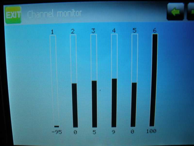

25 Oct 2013 04:25 - 25 Oct 2013 04:32 #14939
I don't see anything wrong in throttle channel. What do you see at Channel monitor for throttle channel? Range of change has to be -100% to +100%.
When you calibrate sticks, do not press on stick at end points, it can be resulted with wrong end points values.

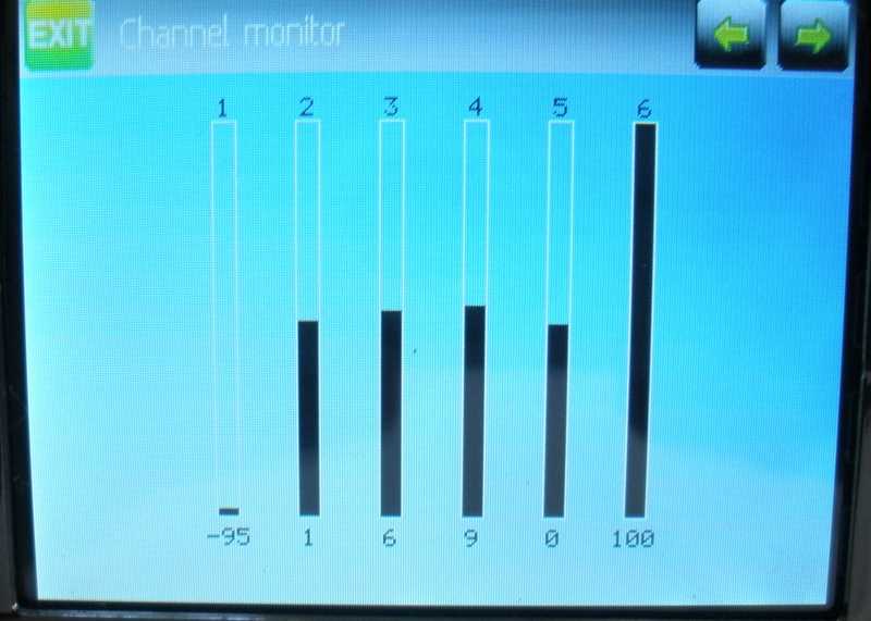

25 Oct 2013 06:50 #14941
by ChrisLevo
Thanks, Vlad.
Screen shot attached - Chris
25 Oct 2013 07:27 - 25 Oct 2013 11:23 #14943
You need recalibrate sticks. Elevator and Rudder also have not zero points.
It seems you have problem with stick calibration.
1) Center all sticks, press ENT
2) Move all sticks to max and min (do not press on stick at max and min points), press ENT
3) Check all sticks movement and zero points at Channel monitor.
Last edit: 25 Oct 2013 11:23 by vlad_vy.

01 Nov 2013 05:57 - 01 Nov 2013 05:58 #15184
You have problem with stick calibration. I don' know the reason. Try flash original firmware and library and do stick calibration with original firmware. Then check it in 'Monitor'.
