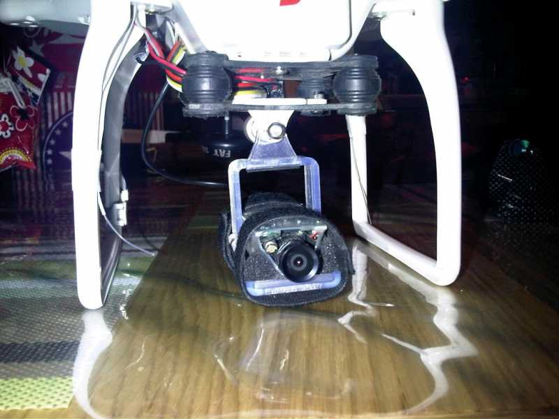

I am using a RX1002, look at the picture, both antennas are going on opposed legs. It is my first installation of a RX but I guess should be OK.
Let me know if you have any comment.

The antennas should be arranged in a right angle to each other, e.g. one (the last 30mm) parallel to the ground, the other pointing to the ground.
For a Phantom used as a video platform (I guess you do not fly 3D) it will be even better to arrange both in parallel to the ground, but in a 90 degrees angle to each other.
The transmitter antenna may not point directly to the quad. If you arrange the rx antennas as described above, the tx antenna should be in the same plane as the revceiver's - means also parallel to the ground. With this construnction you will always have the strongest signal at the receiver.
Having both rx antenna in parallel as it looks alike on your photo is quite the same as if you have only one - both will receive the same signals.
Having them orientated as I wrote above you will never have both pointing to the transmitter and you have the best signal.
If you have both rx antennas mounted vertical (bad idea as said), You must have the tx antenna vertical too - they always must have a common plane. If you have rx and tx antennas in a 90 degrees angle to each other you will have a minimal signal.

Yep, it looks OK.
They might be installed with a bit more different angle, but since it's a quad, it usually fly horizontally...
Where is your transmitter's antenna pointed?

No, then those positions are not too effective.
The antennas of the tx and rx should be parallel for the maximum range.
If you have your rx antenna vertical, so you should point your tx antenna up.
If you bend it horizontally, you should arrange the rx antennas like RBE described.
However don't bend only the end of the wire (without the shield) to horizontal direction, but leave some shielded part with it, and don't bend it sharp...

Unless you fly 3d, your antennas are fine vertical as they are on the picture.
Just make sure your tx antenna is also bend up vertical and held 90deg with the line of sight to the quad.
Do not place one 90deg or horizontal, it will effectively disable that antenna while flying in a horizontal orientation.

Almost.
In the horizontal plane you have to point the two rx antennas perpendicular to each other, so at least one always have a parallel portion to the tx.
But since you probably mostly fly your quad horizontally, now it is enough if you point your tx antenna up...
