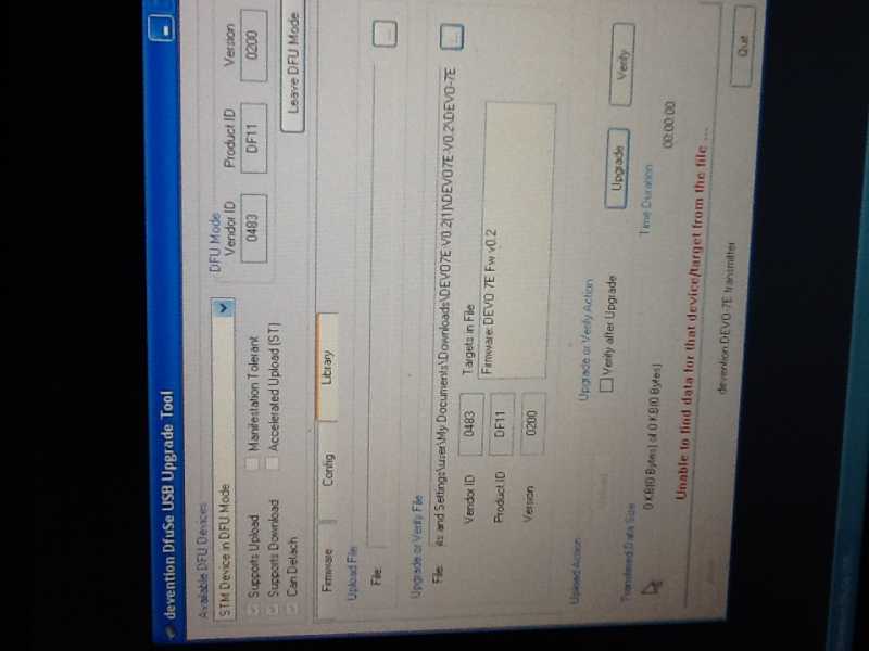

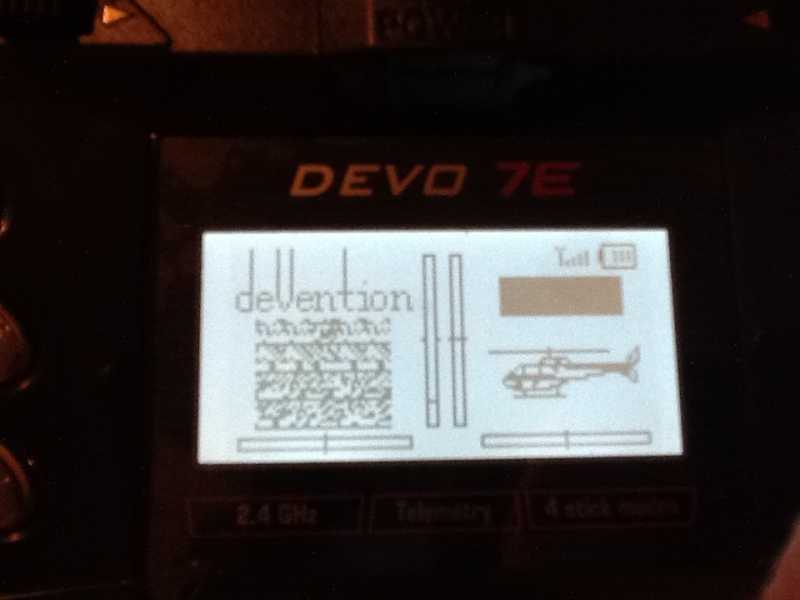

Long story short,bought a super cp with devo7e have had it for 3 days,everything worked great but wanted to use my tx for my Mcpx as well,downloaded deviation and didn't really like it,went to return original firmware and now my screen has large blocks on it and I can't read it at all!! I've tried 10 times to switch it back to the original but it won't go back,then I figured I would just put deviation back on and live with that,all I get for deviation now is the picture of the helicopter!!!! 3 days and my TX is not useable
anyone help me please!!! Read the FAQ and nothing seems to work.

Ya I've done that 10 times,I go to the walkera site and download the Devo7E firmware version 0.2,then upgrade it and its still the same?? When I go to upgrade in the library it says it can't read the data??

Ya,I've never done upload,it's always been upgrade,when I try it in library it says "unable to find data for that device/target from file" Now all my files in deviation say cannot read,files are corrupt WTF???? Should have just left everything alone now I'm screwed and have to buy a new one hahahahaha.

At Library tab you selected firmware file, not library file. You have to select 'DEVO-7E Lib v0.1.dfu'.
With Deviation firmware, you need first format removable drive, it is corrupted after flashing original firmware.
