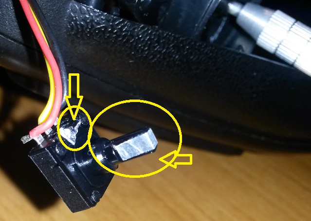

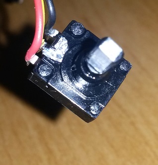

Took me an hour but it was worth it!!!!
I have added some thin, flat metal sticky tape to the pot sticks... all of them. And it simply worked. After a calibration I get 0 difference on all pots.
I added 2 layers to the horizontal and 1 layer to the verticals.
Different plastic parts... different level of sh!tness in mold quality.
There you go - nice design, sh!tty build quality.
From now on my flight will improve

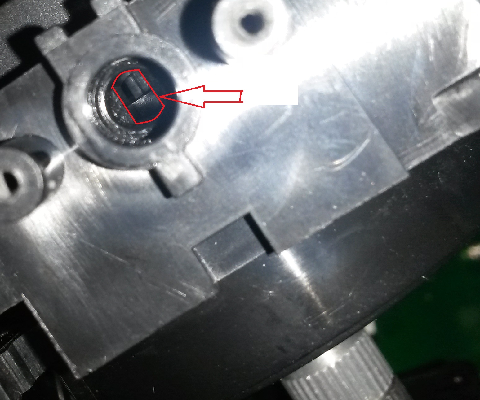

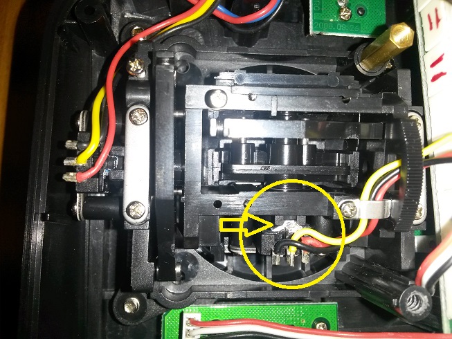

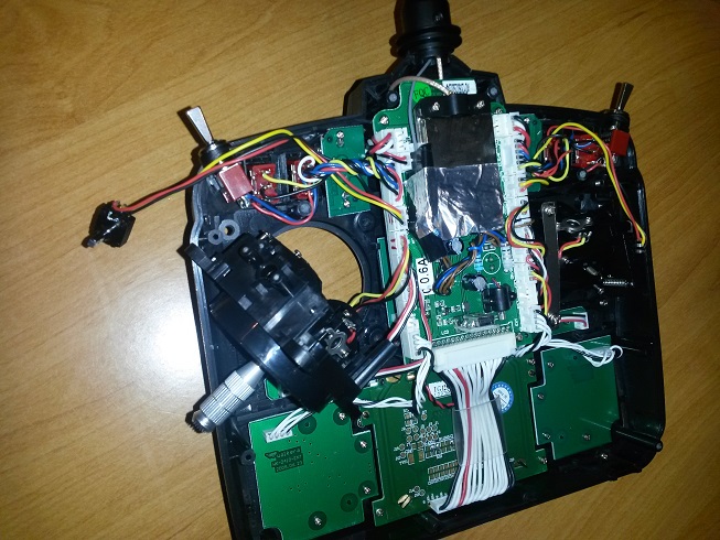

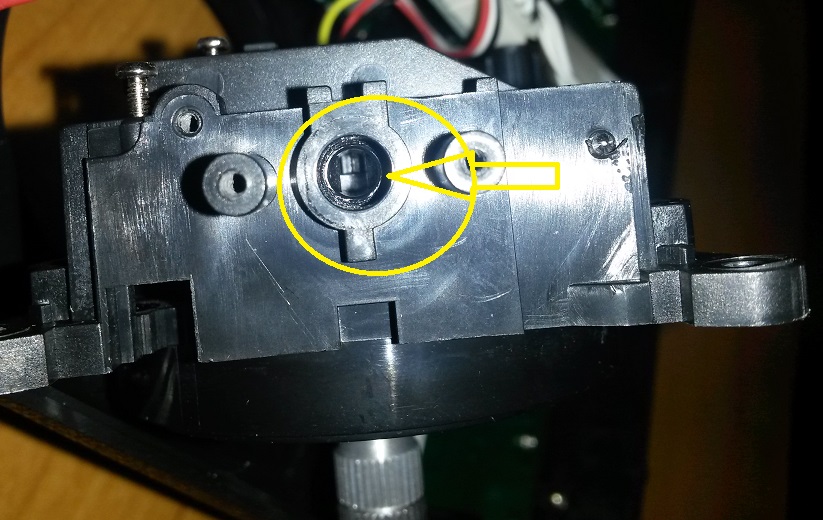

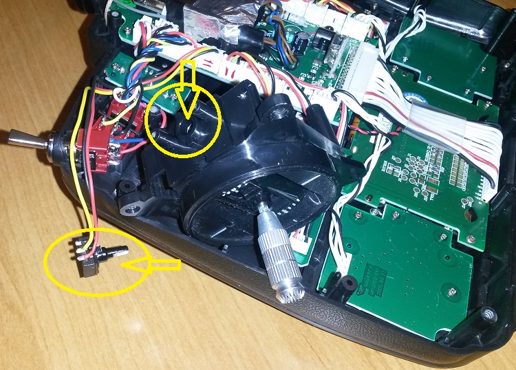

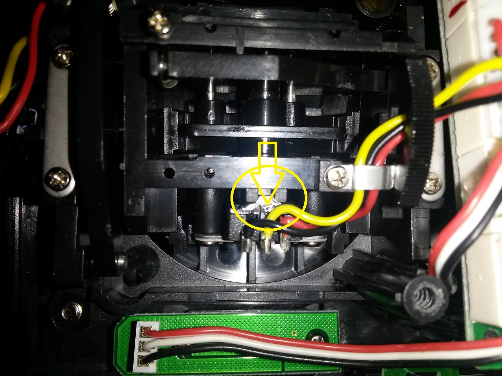

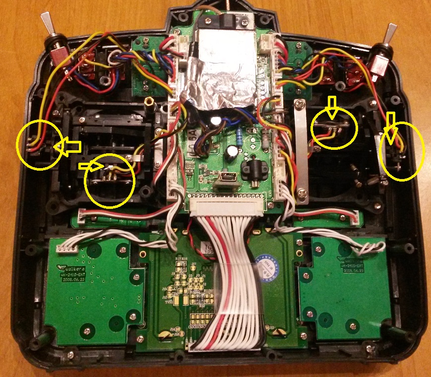

I took the radio to bits and made some pictures today. Hang on, I'll post them tonight.
cheers, bm
cheers, bm
- billmester
- Posts: 215
18 Feb 2014 20:44 - 18 Feb 2014 20:47 #20539
by billmester
Replied by billmester on topic Devo10 horizontal stick centering issue
Last edit: 18 Feb 2014 20:47 by billmester.
