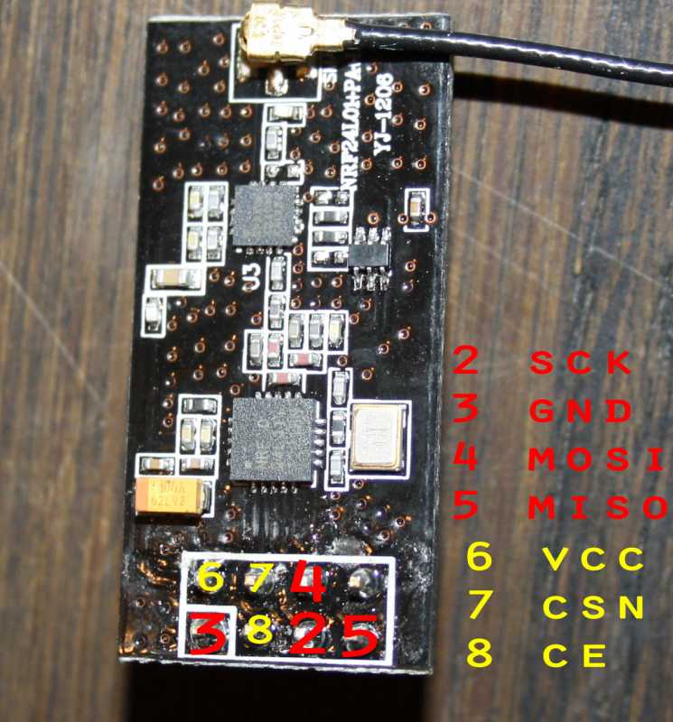

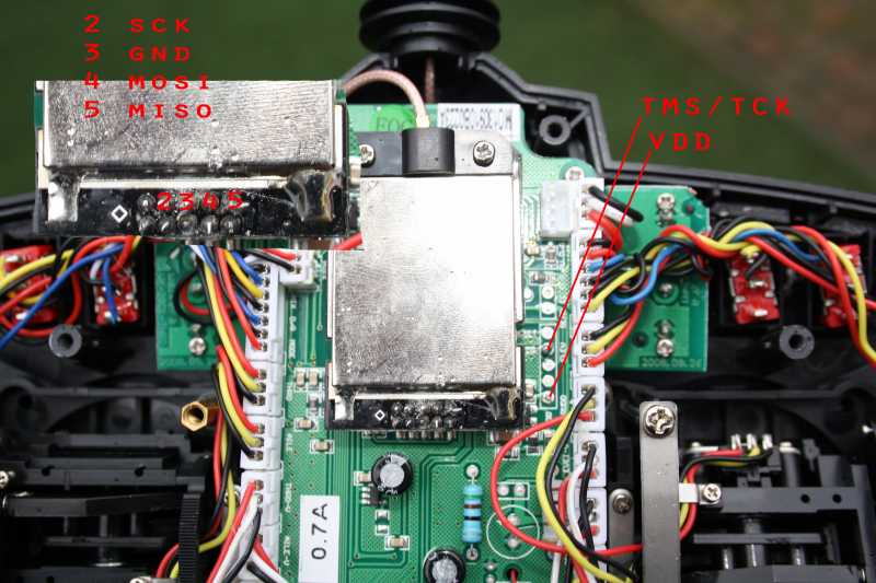

27 Dec 2013 16:17 - 27 Dec 2013 16:18 #17108
by HappyHarry
Replied by HappyHarry on topic devo 10 nRF24L01+ Hisky
ovres VCC and CE from the module go to VDD on the TX, and CSN on the module goes to either TMS or TCK depending if this is your first module or second, if it's the first module you've added then use TMS, otherwise use TCK
thanks pb, i'll ping victzh and ask him to have a look
