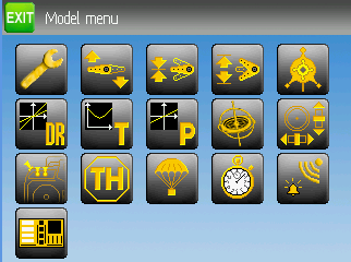

So, I'm considering using the icon menu from the 'Standard' GUI for the advanced GUI (rather than having the circular menu traversal we have now).
Specifically I mean this:
Though of course it will only have the icons related to the Advanced GUI. I need to make a decision about this quickly, as I'm finalizing the documentation now, and this decision impacts that.
Let me know what you think.

Why not? But it will be more difficult to distinguish 'Advanced' and 'Standard' GUI, particularly for novice.
Probably, be worth at least to change the title to 'Model menu - Advanced' and 'Model menu - Standard'.
As for me, it is good as is.

Not much you can use from that menu: the model setup, trims, timers, telemetry, main page config and the not yet on your picture datalog.
All the others are implemented with the mixers or are on the channel setup page.
However you could use them duplicated: the reverses, subtrims, travel adjusts, and even the swash options, but that should be visible only if it is a heli config...

It's a good idea to have a similar way of using one gui or the other. This will make the change easier for advanced newbies.
As Vlad mentioned I would clearly state which mode is actually used. And FDR's idea of disabling some of the icons which do not make sense for a particular model type is also a good idea.
Maybe this is the chance to get the plane flyers better integrated since they can not use the standard gui. I would recommend to add some "switch buttons" in the first row where we can choose between heli/atd, heli/adv and plane/adv (with a marker what is actually selected and a 'are you sure'-dialog wen trying to switch) (perhaps with the "load template" button nearby). This will give us the freedom to place different buttons with different pages behind in the rest of the page.
If we go this way we could also add a tx config button on the model menu page to have it all reachable from one page.

I am not sure I understand correctly, but I don't see the value of a menu system based on the Standard GUI icons unless you change the sub-pages it links to, to support only that menu function/item.
The logic behind Deviation's advance GUI is channel based, not function based as with the Std GUI and Walkera firmware
For instance - If I select Subtrim the proposed "advance" GUI menu page, I would expect a list if all the servo channels and a Subtrim entry for each.
Or do I completely misunderstand what you propose?

I don't think it is valuable to show icons in a disabled state as it would make the Advanced GUI appear less powerful than the Standard one, and would just add confusion. I would also not change any functionality or page definitions over what they are now. I want to just make a small change reusing existing code, and not make any significant changes that will destabilize the codebase this close to release.
All you would get would be a new menu when you pressed the model icon that is similar to the standard-gui menu but with only icons related to the advanced GUI. Notably these:
*Model
*Mixer
*Timer
*Telemetry
*Trim
*Datalog
*Main Layout
(new icons are probably needed for 'Mixer' and 'Datalog') and I'd probably ask FDR to put those together for me.
The upside of this change would be a consistent interface, and faster to get to some pages.
Th downside would be that it is harder to use with physical buttons and takes more presses when using them.

For touch screen it will be the same. To see all 7 'Advanced GUI' pages I need to press 'Next' button 6 times, with new 7 icons it will takes 14 presses.
I think with icons 'Advanced GUI' will be more complicated to navigate. Too few items for navigation.

Honestly I can't understand half of those icons, and I don't know how you could present the info in a pictorial sense; using text seems a lot clearer and quicker to decipher, unless the user has been using the icons for a while?

Ok, so I guess it'll stay the way it is for the upcoming release.
