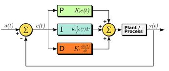

PID is a control system abbreviation and describes a 3 element (law) control configuration or algorithm:
P - proportion control law
I - Integral Control law
D - Differential control law
When flying an RC model there are a large number of closed-loop control loops that in fact may already be use PID control algorithms, eg. inside every servo on the model, inside the gyro and FBL controllers. On the highest (outer) level the pilot is also part of the closed control loop and the pilot is in fact is the learning control element closing the loop to keep the model in the air.
Deviation and other programmable TX's all provide a programmable P term (loop gain or scale/range). The I and D elements however require high speed, fixed period or continuous analogue feedback to work properly (the y(t) above in the diagram) otherwise it dynamically affects the D and I gain terms. The low cost telemetry we have cannot provide this level of feedback nor provide the reliability required for safety purposes.
This is where Drones and UAV comes in, their sensors, control algorithms and control/feedback loops are all local on the model and you have a remote command feed to initiate the required actions - the mission critical control functions are not distributed across the TX and Model.

Thinking about it we already have the PI components in the RC control loop and it might just benefit to an open-loop feed-forward D term, eg. the gain increase the higher the rate of stick movement.
Replied by RandMental on topic PID tuning/setting on the actual transmitter
PhracturedBlue wrote: ... Instead, what we'd need to do is to use the rate of change to compute the curve. The problem is that we are sampling at a very high rate, so detecting rate of change isn't so easy.....
- The P-term provided by the TX Scale/Range and Expo settings
- The I-term provided by the Pilot - based on the movement history/trend of the model, corrections are applied and on a plane the trim buttons are used to remove the constant offset corrections
- The D-term based on the stick rate of change.
The D term would thus reduce the gain (scale) at slow stick movements, i.e. you would have the normal 100% scale and anything slower (than a threshold to set by each pilot) the gain is proportionally reduced
Last edit: 05 Jan 2014 13:32 by RandMental.
