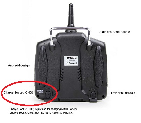

17 Feb 2014 09:09 #20436 by Mmon77
No, it's on the other side of the TX from the trainer port:
I use it to charge NiMH batteries in mine as well. I don't know if it's a "smart" charger or not, so I mostly use it for short periods of time to top off the batteries. I use a standalone charger to properly charge them
