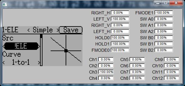

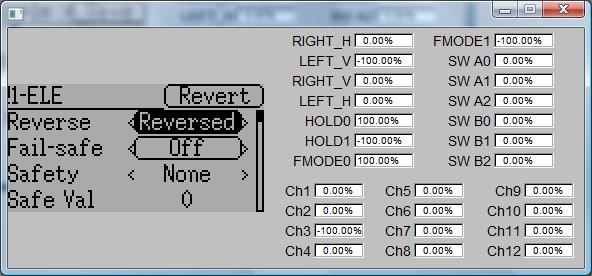

I am having a problem getting the kk2.1 receiver page to show the correct inputs from my radio. I am using a Devo 6 channel rx, and 7e radio.
I have all channels going the proper way i.e elivator up it shows up on the kk2 board.
The problem I am having is on some channels they move the proper way but instead of the channel showing, say -100 to 100 is is reversed and shows 100 at the bottom of the scale and -100 at the top which is backwards to what I expect.
If I look in the transmitter monitor / channel Monitor / stick input, I get this for all models on the radio and they all work ok.
Ail 100 to -100
Eli -100 to 100
Thr -100 to 100
Rud 100 t0 -100
Is this what it should be, or should all channels read -100 to +100, reading for example, throttle full off, -100 full throttle 100. This is what I would expect but I get rudder and ail reading 100 to -100 and eli and thr reading -100 to +100.
My question is should they all read the same range and if so how do I change them to do so in the radio, or is this what it should be .
I hope you can understand me, I am confused and it is hard to explain.
Any help will be appreciated, it is strange not all channels have this behavior only aileron and rudder.
Gary
