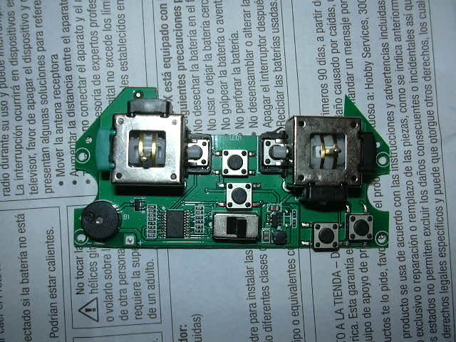

- Birdman
- Posts: 280
22 Feb 2014 14:14 - 22 Feb 2014 14:15 #20737
by Birdman
Replied by Birdman on topic help changing tx ini please
pic shows where i cut pcb, rest is in tx
will dig it out if anyone wants more info
Bm
Bm

- John-Boy
- Posts: 65
22 Feb 2014 14:51 #20741
by John-Boy
Replied by John-Boy on topic help changing tx ini please
Any pictures of your connections to the cutout board? Thanks...
