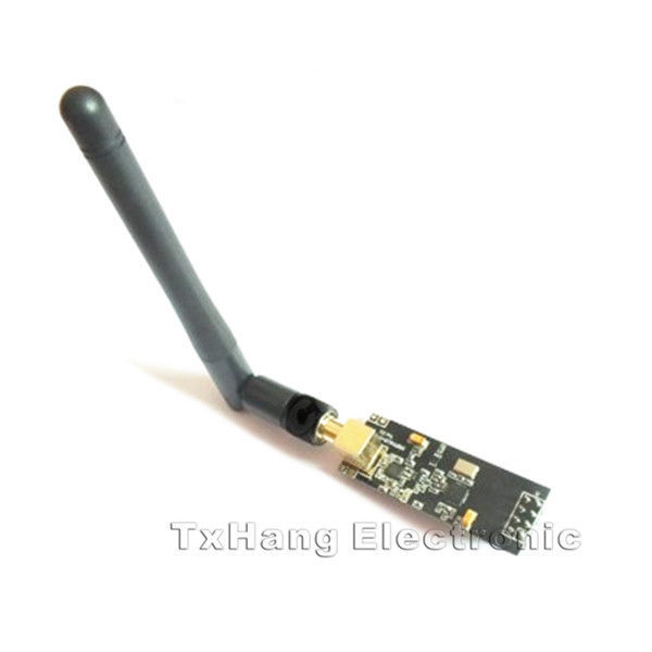

Double check your antenna soldering on your nRF24L01+ and/or all your soldering connexion.
Hi SeByDocKy !
I'm Israel (the guy woh ask you about the INI file :) )
Thanks for your help, I'll check the soldering of the antenna and the connexisions.

I've checked twice the connexion and everything it's OK, I've tried to fly the JXD 388 with the antenna out (to improve range) and doesn't works...I'll try to put the last nightly, if it doesn't works I'll give it up...anyway I've a Hubsan X4 on the way.....
