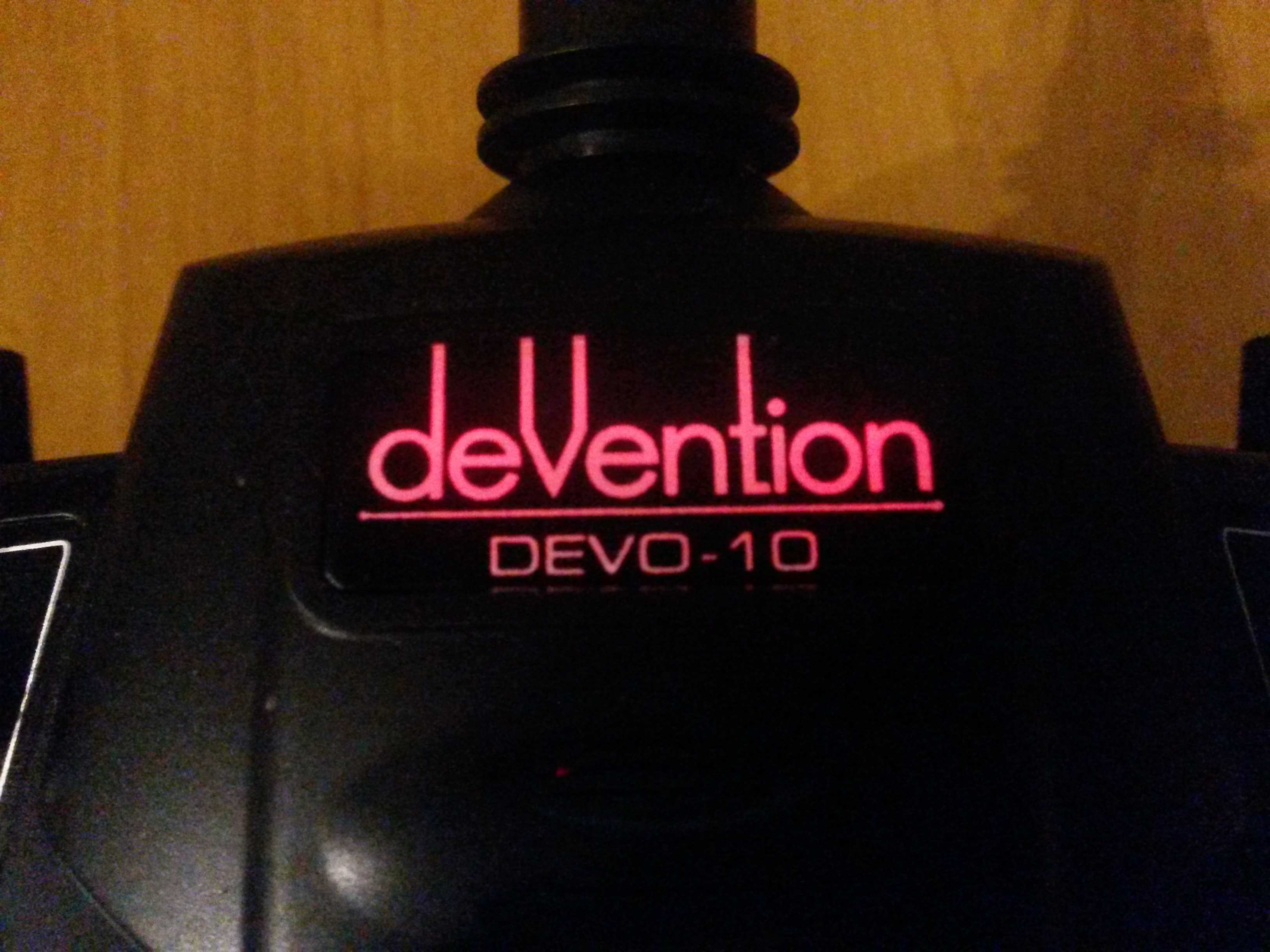

Has anyone installed a single led power on light on a Devo 10?
I keep forgetting to turn the radio off sometimes. I ruined 1 Life battery pack already.
I also have a Devo 7e i would like to add a led light to.
Thanks for any help.

Take a look on the picture of this post
www.deviationtx.com/forum/how-to/1881-an...cement-devo-7e#20331
You will see where you can pick up the 3.3V and the 0V to plug a LED (don't forget to serialize the led with 51 Ohms resistor).
This is for the Devo7e.
(With a multimeter, it's not difficult to find 3.3V and 0V in the Devo 10)

I do have the PowerOn Alarm set to 5 minutes together with vibration always a good help.
When I see the mods I think I must open the box with the LED's now
