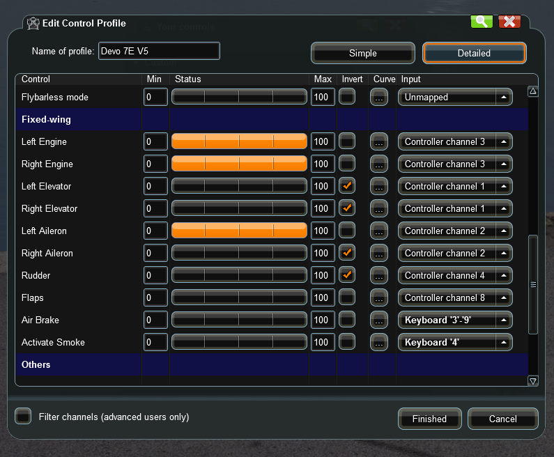

I see no "PIA" : once calibration is done, it is done and set ...
For AIL, no need for a TX switch : just REVERSE the appropriate AIRCRAFT AIL channel in the "EDIT PROFILE -> detailed" menu (CTRL+C then "edit => detailed") ...
Hope this helps.
