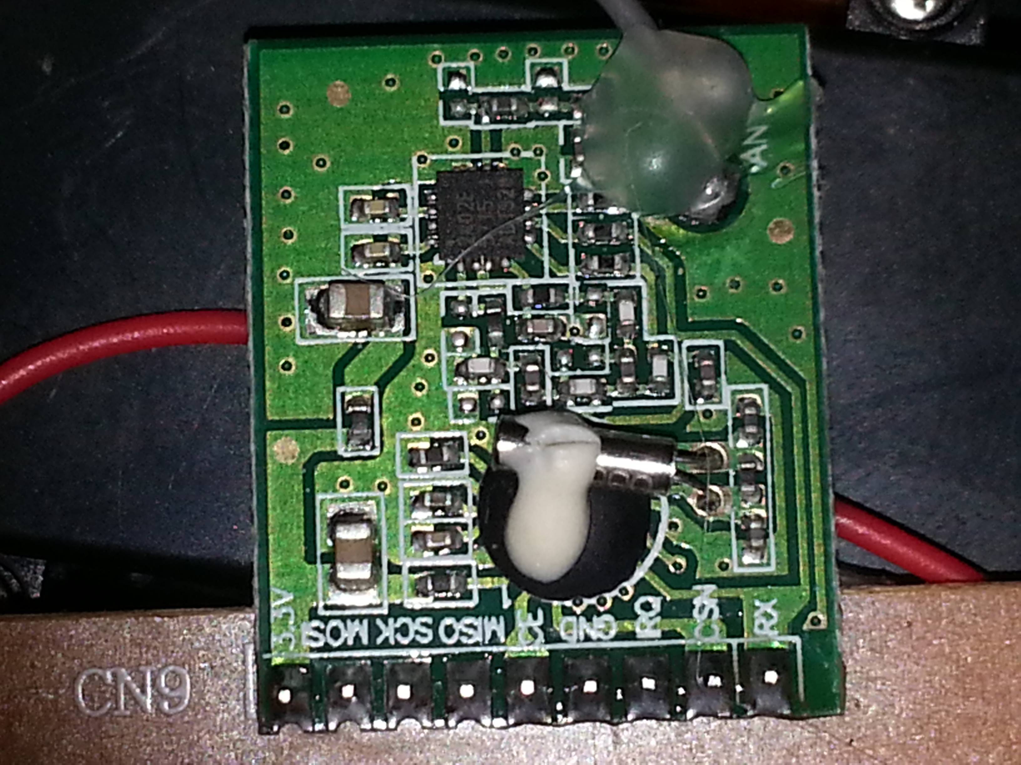

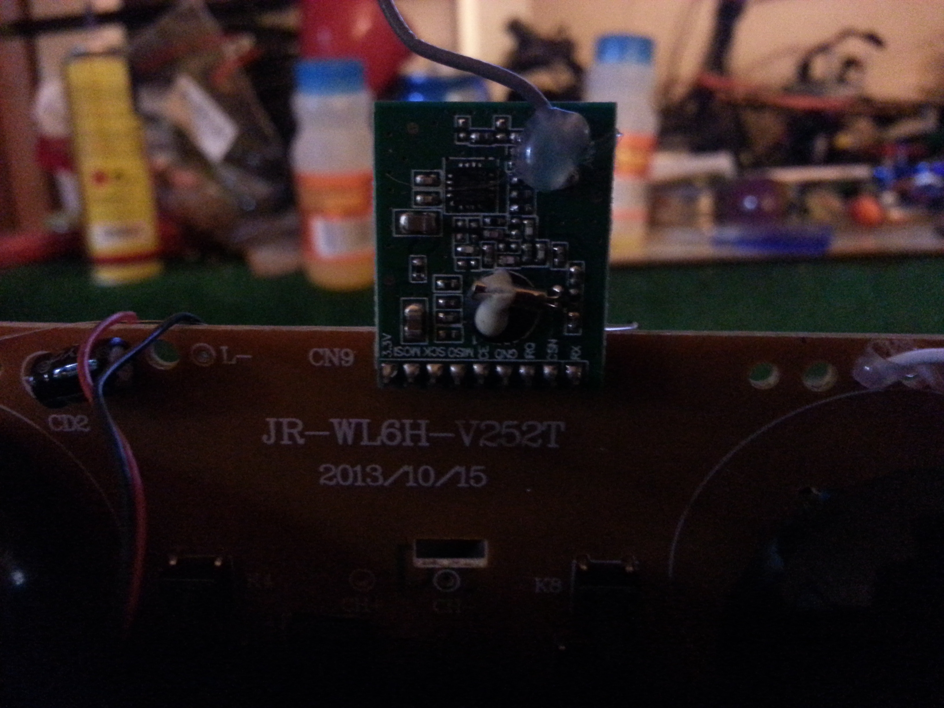

I opened the TX here is best pics I could take help me if you can

ABE-2.4GPA-3A is on the back of chip having trouble uploading the photos
27 May 2014 17:57 #23706 by PhracturedBlue
Replied by PhracturedBlue on topic V252 "Pro" different protocol?
With a CE, CSN, and IRQ pin, it is almost certainly an NRF24L01 chip.
27 May 2014 19:18 #23709 by PhracturedBlue
FYI, anarchy had issues posting pics, so here is a higher quality image he took that makes the traces visible:

27 May 2014 20:23 #23713 by victzh
Replied by victzh on topic V252 "Pro" different protocol?
VDD_PA circuit is also suspiciously close to nRF24L01.
