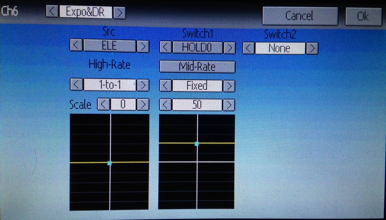

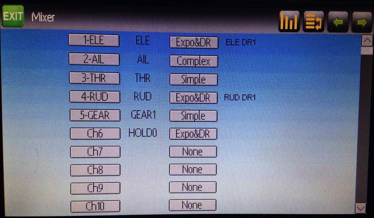

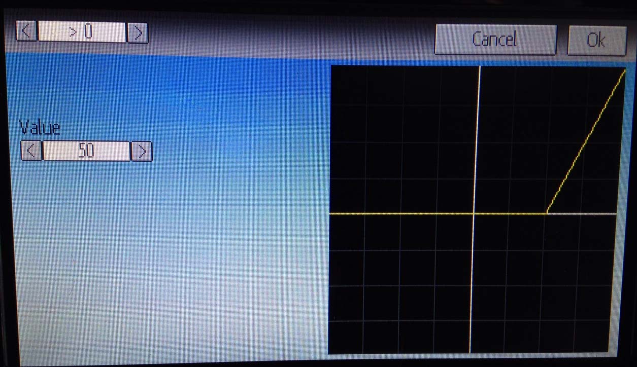

08 Apr 2014 07:27 - 08 Apr 2014 07:32 #22236
by lcn
Replied by lcn on topic How to assign a switch on Devo12s to do a specific
Thanks,
I've tried to follow your advice, but nothing happens when i switch HOLD0 on, on the channels view.
Ch6 has been assigned to HOLD0
Here is what i did so far, did i missed something ?
Last edit: 08 Apr 2014 07:32 by lcn.
08 Apr 2014 08:12 #22238
Replied by FDR on topic Assign a switch on Devo12s to do a specific action
Not what I meant.
Do the following:
- select the Ecpo&DR mixer template (done);
- set the source to the ELE stick and the function to 1-to-1 or EXPO;
- set the switch1 to HOLD0 (or HOLD1 if you please);
- click on the middle-rate button to unlink it's function from the first graph and select the fixed function for it, also set the scale to 50%.

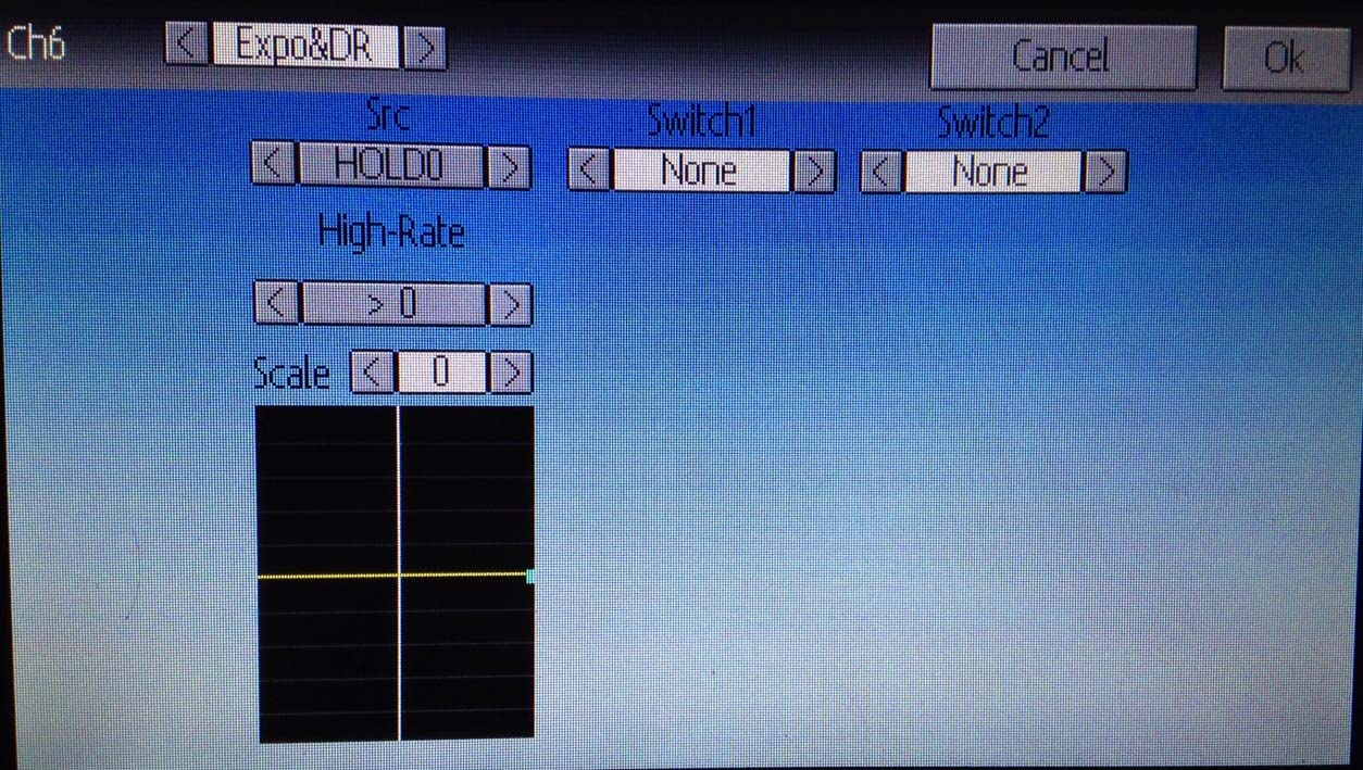

08 Apr 2014 21:29 #22250
by lcn
Replied by lcn on topic Assign a switch on Devo12s to do a specific action
Now, when i manually activate the switch on Ch6 to 'HOLD0' position, the channels view show HOLD0 = 50%
But Ch1 that is elevator does not get changed and stays as it is.
I though ELEVATOR channel would also be set to 50% , but looks not .
Is this normal ?
Here is the capture of my setting.
Is this normal ?
09 Apr 2014 04:35 #22257
Absolutely.
If you made this on channel 6, it won't effect the actual elevator channel.
This was only a demo to show you how to do it.
Now if you do the same on Ch1 you will get what you want.
You can delete the demo from Ch6 by selecting the mixer template "None".
However if you want just a fixed vale on throttle hold, there is also a simpler method:
- go into the channel config page;
- set the safety switch to your throttle hold switch value;
- set the safety value to the desired value;
... and that's it...
