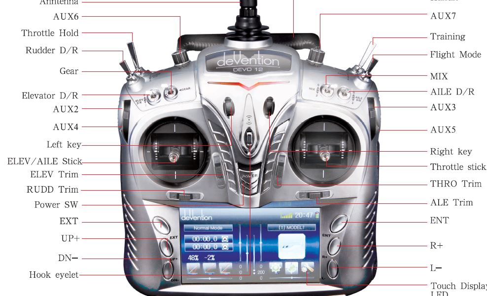

But, what are names for side potentiometers on Devo 12s , I can assign them to a channel
These haven't any name.

Replied by vlad_vy on topic Trouble with AUX7 potentiometer
You can check that at "Input Monitor" screen.
