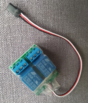

- Maco33
- Posts: 18
17 Oct 2020 06:58 #76893
by Maco33
Replied by Maco33 on topic Sequential output channel signal by a switch?
Hi boys, I need help. For my module (see photo) I have to program the exact pulse function on Devo7e (Deviationtx). I have a three position switch and I start in the neutral position (middle). I need: When I switch to one position, I need to transfer a precisely defined pulse (eg 5 seconds) to relay 1. Then I switch to neutral. When I switch to position two (from neutral), I switch relay 2 to the defined pulse length.
Thank you for any help.

- Gerry
- Bbrad
- Posts: 194
18 Oct 2020 03:45 #76896
by Gerry
FFS (Forever Fixing Stuff)
Replied by Gerry on topic Sequential output channel signal by a switch?
This topic may have some insight for you.
www.deviationtx.com/forum/7-development/...rs-to-channels#29092
- Maco33
- Posts: 18
18 Oct 2020 16:43 #76898
by Maco33
Thanks Gerry, it's amazing, but I will need many evenings to understand and apply
The important thing is that I already know that it is possible
