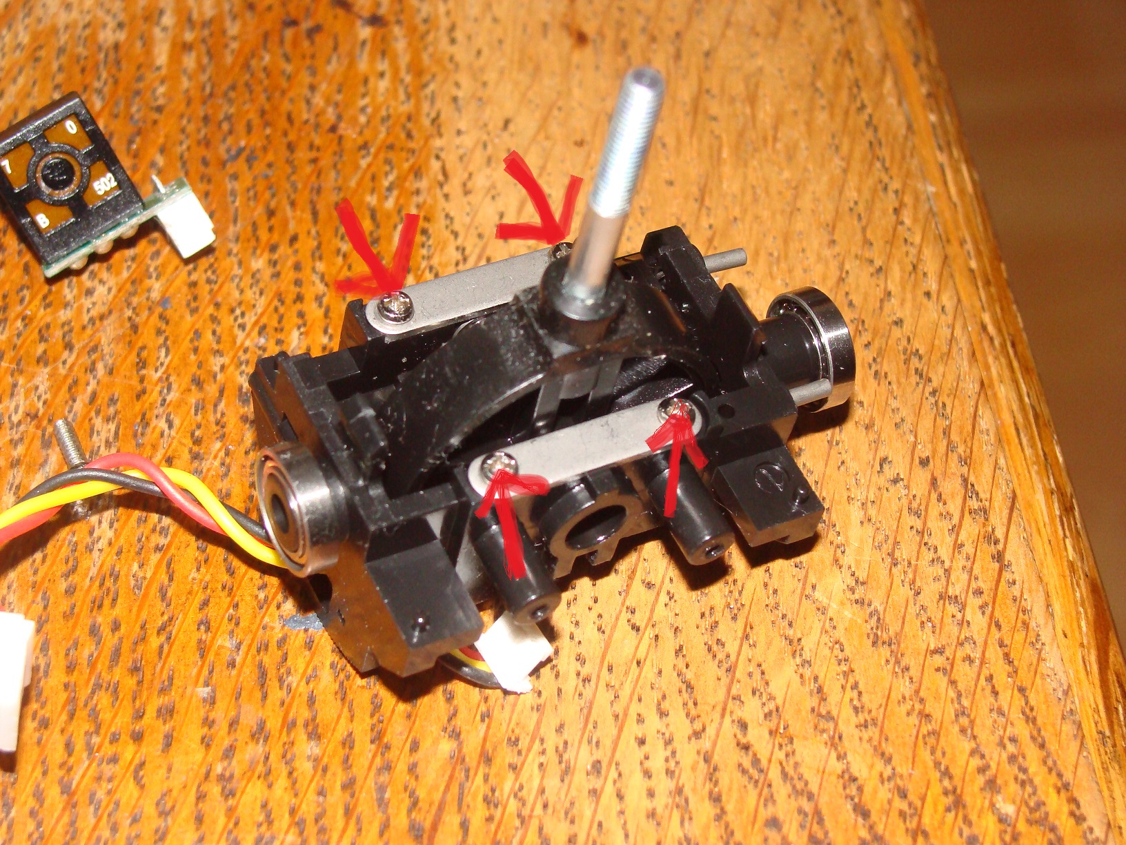

want to share with you some experience on my Devos (7 & 8s)
if your Heli don`t fly as you want, it`s not always you or your Heli or the Firmware of your Devo
notice on my Devos-Channelmonitor that the "Rud and Ail"
centering is not 100% correct and sometimes it moves a little pit
without moving the Stick.
The Probleme i found, is the ball-bearing for the Stickaxes can move up and down.
A very simple fix for that: take out your Stickmodule and fix the four Screws see on the picture. If you fix the Screws don`t forget to control that the Axes can move free and the ball-bearing can`t move up and down anymore
After fix the Screws don`t forget to calibrate your Devo
That`s it - the new flightexperience is amazing
and sorry for my bad english, but i think you understand me

i fly now more than 20 hours with this fix, and every day i`m surprise
what works now when m flying my helis

we aleady discussed a bit in another forum. What was actually the noticable change after you tightend the screw, apart from that the monitor now shows no erratic behaviour anymore. You said it was a whole different experience to fly. Can you describe this more precisely? Was the heli drifting before?
