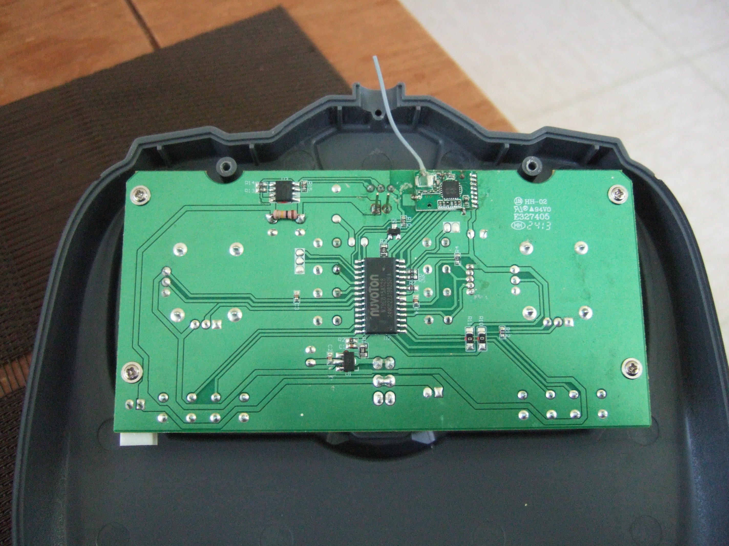

I cannt bind the esky 150 even if I installed the nRF24L01+PA+LNA chip. Will there be an update for Devo 7E to bind it correctly? I'm a mode 1 flyer, totally cannt fly mode 2 default transmitter:(

The Esky 150 protocol works for the Devo 10 radio. Binds fine.
But the Devo 7e won't bind when using that same protocol.

Thanks for all the reply. Yes, it doest not bind the heli. Try Fix ID and None also doesn't work. :(

Concerning the Devo7E problem, ... I can feel it's a syncrho problem.
I mean maybe by increasing/decreasing some time delay used during the protocol setup....

Funny, no other protocol has this problem. As I don't have the heli, even the receiver board, I can't check it. I was amazed that our distance debugging worked for the protocol reverse engineering, but this case seems to be harder. You'll need to get traces from Devo 10 and Devo 7E and we'll need to compare them and find the difference.
