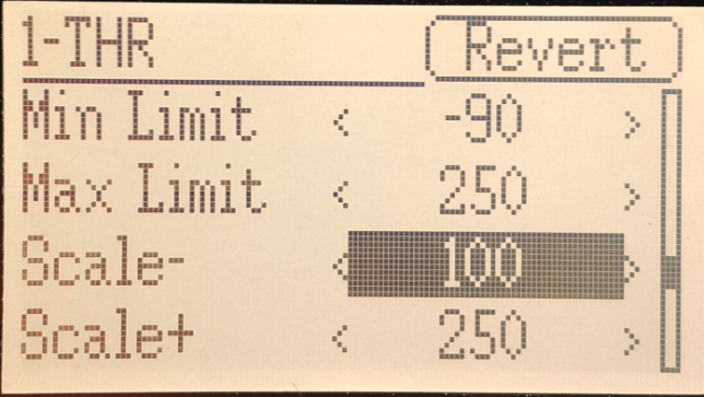

Got it working! Had to set max throttle and scale+ to 250 like the attached.
