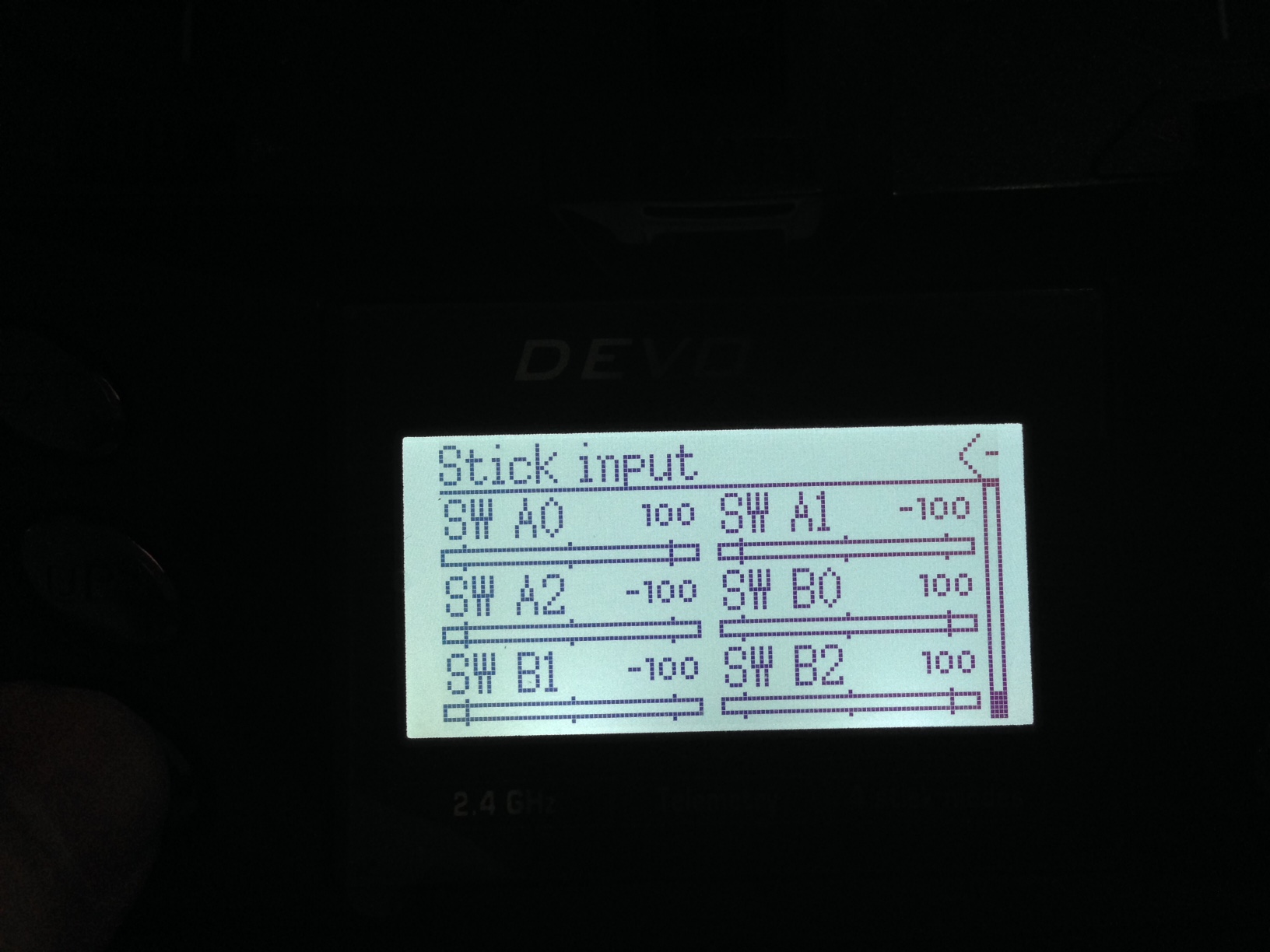

- ColdBrew
- Posts: 15
26 Feb 2016 20:22 - 27 Feb 2016 09:48 #43710
by ColdBrew
Replied by ColdBrew on topic Devo 7 E extra switches problem. now FIXED
hi guys, sorry to ask here, but i have a similar problem as iznogoud44, but my problem is on the SW B2 switch, i can't use SW B2 anymore. it always back to SW B0 when i put the switch down.
as you can see, when the Switch UP : SW B0 and SW B2 is 100, this is should be SW B0 100, SW B1 -100, SW B2 -100
i notice this problem when i finish my LED (on/off) mod, before i doing this LED mod, everything is fine, all switches work as it should. all i can remember is, when i doing LED mod, i accidentally pull out the brown cable on the 3x2 switch and i didn't realize about that and turn on the transmitter to test my LED mod is working or not. so when my LED mod is done, i check all the cable connection and find this brown cable is broken, so i fix the solder and put them back together, but after that i can't use SW B2 anymore. i already try to swap the switch, but it still the same ( so the switch is fine ) i assume something wrong in the transmitter hardware (because i turn on the transmitter with the broken brown cable .. maybe?) not the firmware, i already try to reinstall the deviation NB with the latest version, and still did not work. anybody can help me please? can this problem fixed? or should i buy new transmitter?
regards,
update : not only the SW button, but i can't use the TRIM button too (AIL Trim and ELE Trim) so i decide to remove all the mod (NRF24L01 + 3x2 Switches) and still doesn't work, next i try to install stock firmware. surprisingly... the trim button works again!.. after that, i do all the mods again and install the latest NB deviation without changing hardware.ini just to check the firmware is good and test the trim button. and yes it still work. so i edit the hardware.ini to add NRF24L01 and 3x2 switches,,, WELL all is good... all trim button and switches works like it should... so the problem is fixed. but i don't know why, maybe there's a hiccup in the NB firmware. so if anybody have similar problem, try to reinstall the stock firmware. and see if there any change.
cheers...
Right Switch (SW B)
Up: SW B0 100, SW B1 -100, SW B2 100
Center: SW B0 -100, SW B1 100, SW B2 -100
Down: SW B0 100, SW B1 -100, SW B2 100i notice this problem when i finish my LED (on/off) mod, before i doing this LED mod, everything is fine, all switches work as it should. all i can remember is, when i doing LED mod, i accidentally pull out the brown cable on the 3x2 switch and i didn't realize about that and turn on the transmitter to test my LED mod is working or not. so when my LED mod is done, i check all the cable connection and find this brown cable is broken, so i fix the solder and put them back together, but after that i can't use SW B2 anymore. i already try to swap the switch, but it still the same ( so the switch is fine ) i assume something wrong in the transmitter hardware (because i turn on the transmitter with the broken brown cable .. maybe?) not the firmware, i already try to reinstall the deviation NB with the latest version, and still did not work. anybody can help me please? can this problem fixed? or should i buy new transmitter?
regards,
cheers...
Last edit: 27 Feb 2016 09:48 by ColdBrew. Reason: The problem is FIXED.
