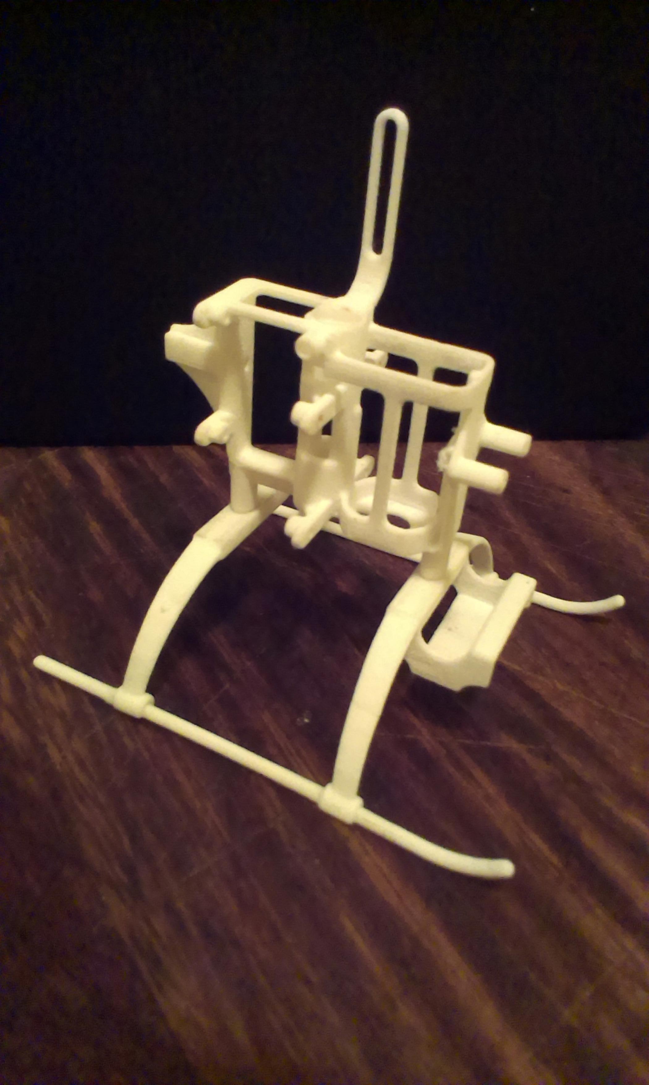

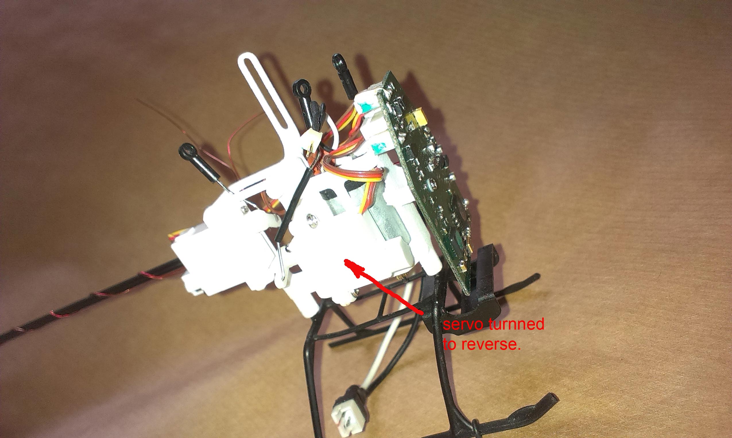

general help question. I have built new mcpx frame that takes HK-5330 1.9g digital servos. I can reverse the servo internally but is there a way using the very powerful mixing capabilities of deviation fw to do thae same? any suggestions welcome.
I have added a couple of pics. image 1 shows servo turned around with long link-arm.
to reverse these servo is a pain so to be able too use deviation to reverse the sevo would be an advantage. image 39 just frame.

have tried every permutation of reversed servo eg 3 servos 2 position
(norm)+(rev) 8 different positions none of these reverse the servo. which is front right hand side. this servo always moves in the opposite direction thought i may be able to use some type of replace mix? not to sure.

I think you have to reverse the hardware otherwise the onboard flybarless system doesnt work
