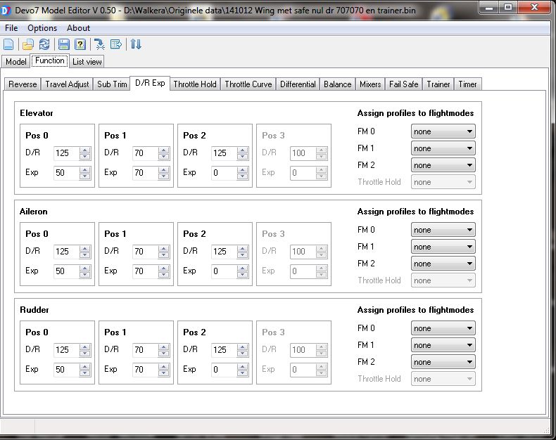

Although there might be an option if editing in Excel or something similar to change parameters, because you have a better overview of the settings. Like the Devo 7 editor (screenshot attached) makes things quite easier.
I think that is not possible?

Somebody could certainly design an editor since it is just a plain text file, but I don't believe anybody has bothered to replicate such an editor for PC. You can use the emulator if you want to run the actual TX editor on your PC with the keyboard.
