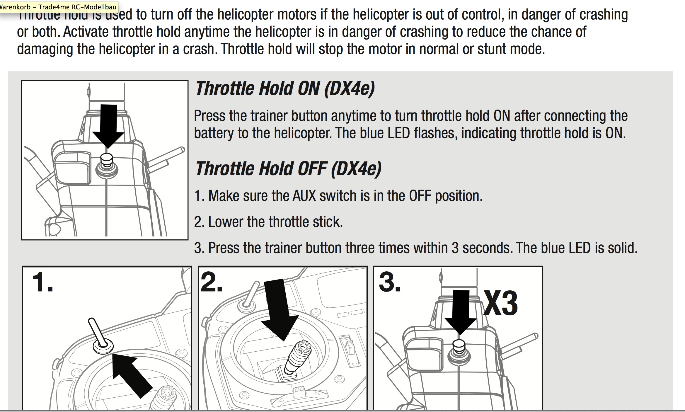

It seems to me, that the MCPX is in "throttle hold" (in the manual described as "throttle hold/motor off) mode.
For explanation: On my DX4e if i push the trainer/bind button one time, its throttle hold. Then the motor goes "off".
On my DX4e Transmitter then i have to push the trainer/bind button quickly 3 times. After that motor is on.
(See picture of manual)
