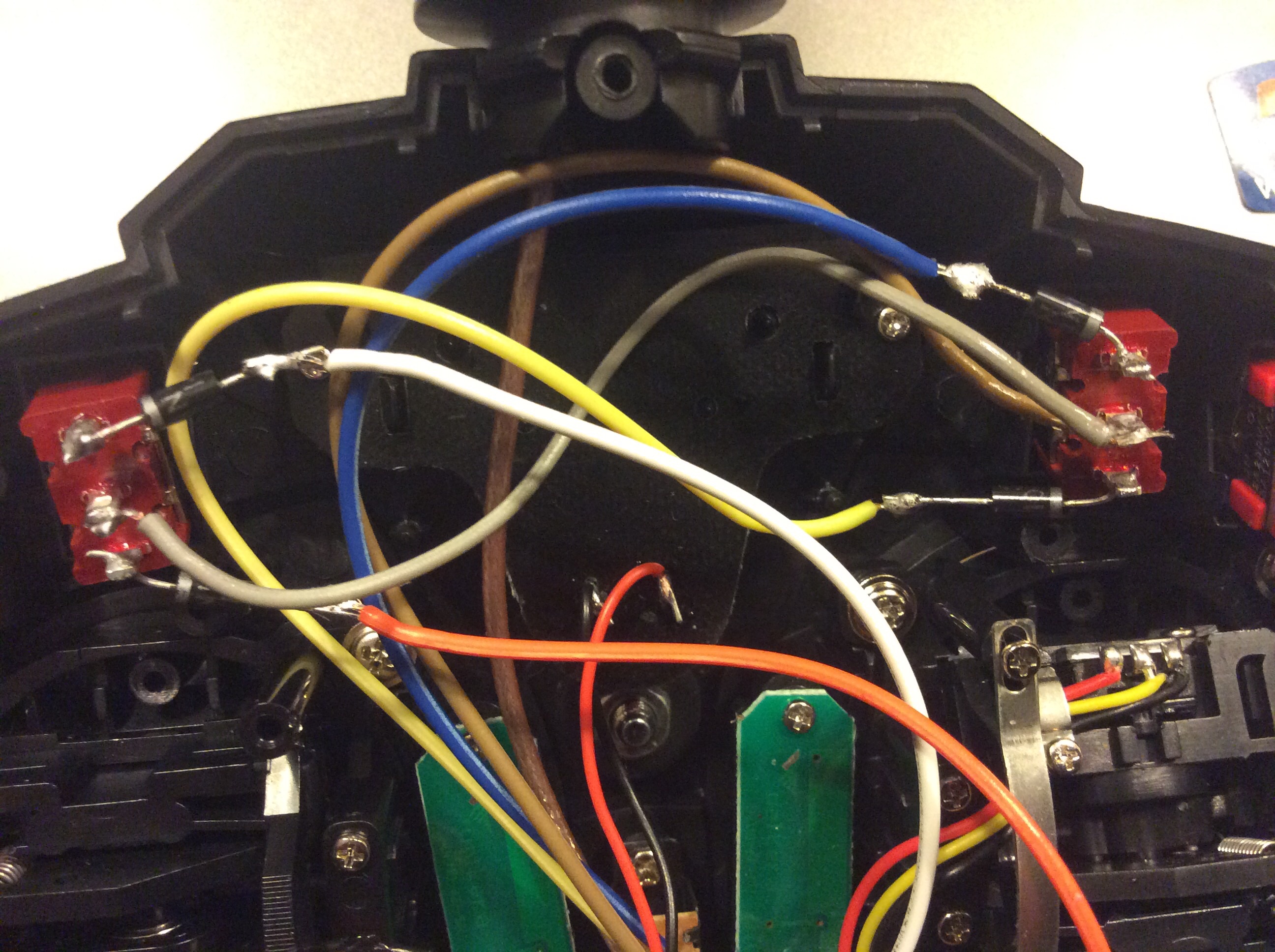

I`m using the "until September" version you provided on the TX and I use Notepad++.
The diodes has the line nearest to the switch. Maybe my diodes are the wrong type? This is the diods I`m using:
Replied by norvik on topic Devo 7e, missing multimod, nightly
Last edit: 15 Dec 2014 20:01 by norvik. Reason: Picture

Standart diodes. I used small fast switching diodes 1N4148.
Wiring looks ok.
Wiring looks ok.

If the switches are wired wrong you probably won't see them in the switch assignment menus or on the Stick Input screen under Transmitter Menu ->Channel Monitor; if they are wired right but the diodes are wrong, IIRC they won't show up AND it seems to affect the trims.
Can you take a photo like the first one in post 27019 above? Maybe at least we can confirm the wiring.
