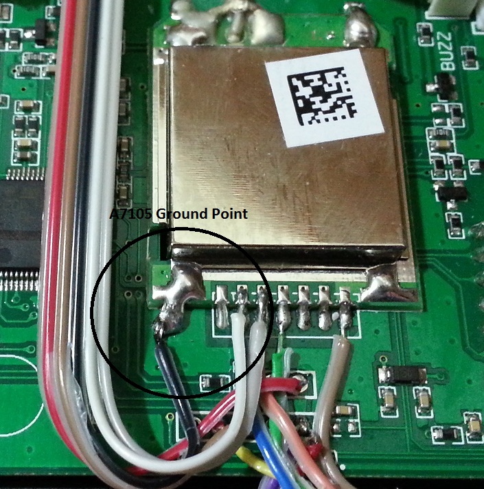

BTW, to be sure, take GND from the GND pin of the CYRF and not from the main pcb. That´s what Neuer_User did....who knows...

Yeah, will be interesting to see, if there is a different type of module with non-working GPIOs.
aMax wrote: Ok, I am curious how it will work.
No, it would be great, if you could first try it with GND from the main pcb. So we have the same wriring.
Actually, I don't think it will make any difference. There is only one GND on the A7105 and all signals are relative to this GND. RXen and TXen are not interfaced with anything from the main board but everything is internal to the module. Theoretically, it cannot make any difference what GND you take.
Let's see what comes out.
Cheers
Michael

Neuer_User wrote: Theoretically, it cannot make any difference what GND you take.
Agree,theoretically you are right.
But MY module is working, so why should I rewire? There is not only one
added module inside... too much work.

aMax wrote: But MY module is working, so why should I rewire? There is not only one
ABSOLUTELY. I wasn't addressing you here. I meant it for Durete, as you told him to wire it to the internal module. Sorry for the confusion.

I have my a7105 grounded to the shield of the internal module.
We will see how it works when receive my Hubsan X4 in about 2-3 weeks.
I think the ground point is not the problem...
