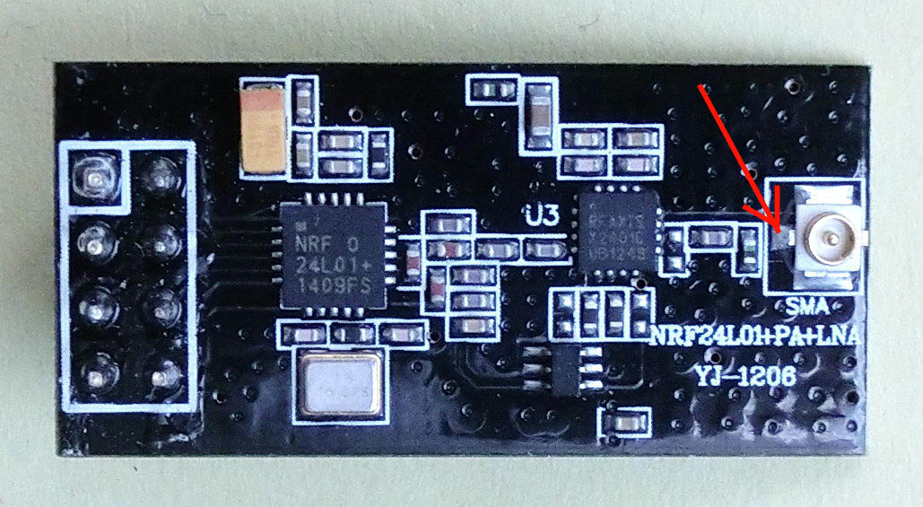

I have a working module in my Devo 7e, but not the "recommended" one (antenna printed on the board). Since all these modules are cheap I purchased some of the right ones, but without antenna (don't know why . . .)
But as far as I can see it shouldn't be a problem to solder an antenna wire, the soldering point is shown on the picture.
Question : What do you people think ? How long has the wire to be ?
TIA
Gerhard
TIA
Gerhard

What you've drawn the arrow to is only 1/2 of the antenna connection, it has a + and a -, aka the center pin and the shield. The arrow you've pointed out is the center pin, the body of the connector is the shield. You can solder a piece of antenna wire if you don't have one with that style connector but for best performance it should be shielded and make both connections, don't just use a single wire whip if you can help it.
You can often find those exact antenna on old 2.4ghz wireless networking gear and you can find that mini-coax antenna wire in almost anything that uses any type of wireless comms.

Why solder when you can simply use one of these antennas
www.goodluckbuy.com/150mm-frsky-2-4g-rec...compatible-2pcs.html
You can't find a much cheaper 2.4G antenna anyway, and that one (or similar ones on eBay) will just snap on
Or, if you prefer, you can use something like this www.ebay.com/itm/1x-2-4G-2-4GHZ-PCB-Inte...w-BK39-/251748634777 , both styles work just fine (the eBay preview doesn't work for me: ebay.com/itm/1x-2-4G-2-4GHZ-PCB-Internal-Antenna-To-U-fl-IPX-Connector-10cm-Cable-new-BK39-/251748634777)

Thanks a lot for reply
@Cereal_Killer
I had checked the solder points with an instrument therefore I do know where the hot spot is
@robka
Of course buying an antenna isn't an issue, just wanted to know.
Generally the radio is used for tiny helicopters so the range of the radio doesn't matter.
Maybe : The unit needs a capacitive load (long shielding of the antenna) for best results.
@Cereal_Killer
@robka

I thought that it wasn't a good thing to use these modules without an antenna attached? I've seen that warning like on MassiveRC's page:
www.massiverc.com/PrestaShop/en/331-4g-n...ireless-module-.html
I was just wondering....
Jim
Note: NEVER power on a video transmitter\receiver without the antenna installed. You will burn out the module if you do and will void your warranty.I was just wondering....
Jim

"These" modules have the antenna printed on the board. What they don't have is an amplifier.ohaya wrote: . . . it wasn't a good thing to use these modules without an antenna attached? . . .
- ohaya
- Posts: 47
19 Feb 2015 14:22 #28891
by ohaya
Ok, thanks. Maybe I was mixing up reading the posts. I thought the one that was linked was one with a PA and an SMA antenna connector.
Replied by ohaya on topic Antenna for "recommended" NRF24L01 module (Devo 7e
