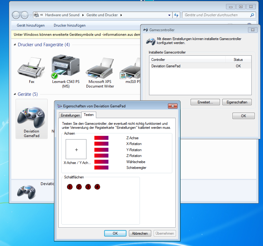

You are running MS-Windows?
Then maybe you need to calibrate something like "gamepad device" in device-manager before doing any calibration in HELI-X

Thanks for that. Found the calibration for the game controller but it registered exactly the same.

- Zaphod

Awwwww dammit. Did the Windows calibration of the Deviation Gamepad and it failed repeatedly on the rudder. Played a hunch and changed the USB cable and FMD it worked!!
