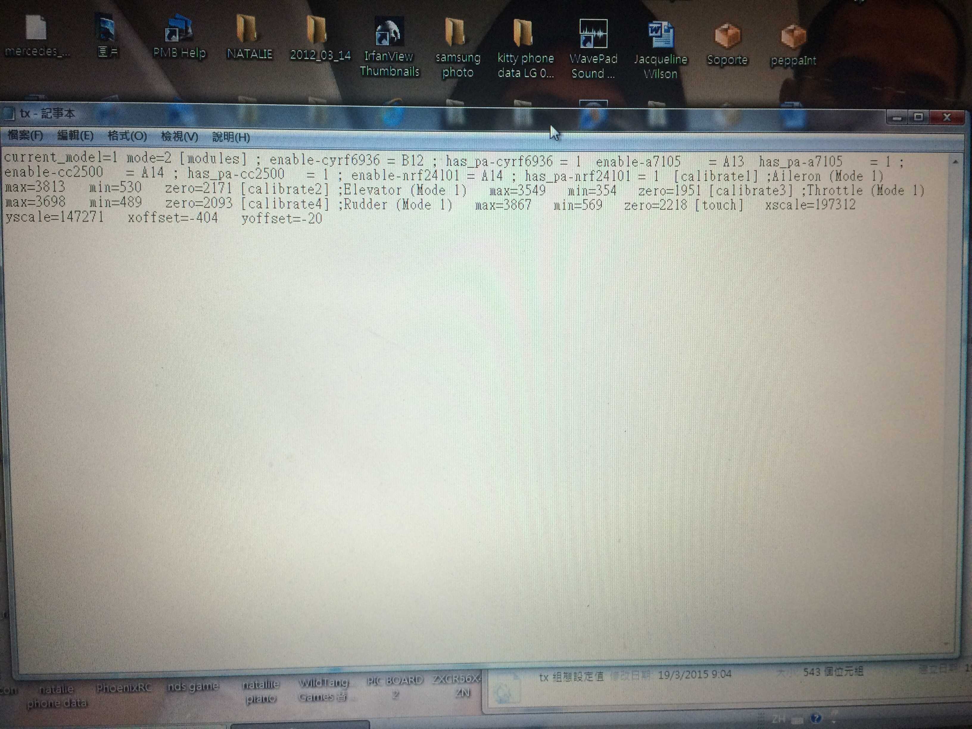

my control only hubsan and flysky show with (*)and can not bind i install A7105 module,i think is ini file setting problem who can help me.my setting is ; enable-a7105=A13 ;has_pa-a7105=1;

Remove the ";" from these lines. Lines beginning with a semi-colon are comments, so remove the semi-colon. The lines should be:
enable-a7105=A13
has_pa-a7105=1
Replied by Deal57 on topic walkera devo 10, 40.1cannot bind hubsan and flysky
vickyjim007 wrote: my control only hubsan and flysky show with (*)and can not bind i install A7105 module,i think is ini file setting problem who can help me.my setting is ; enable-a7105=A13 ;has_pa-a7105=1;
enable-a7105=A13
has_pa-a7105=1

Note that you should only uncomment the has_pa-a7015 line if you actually have a PA. Turning it off makes the Tx think it can control the power output when it can't, which will give you a setting for power that does nothing, and make you think you can do a range check when you can't.
