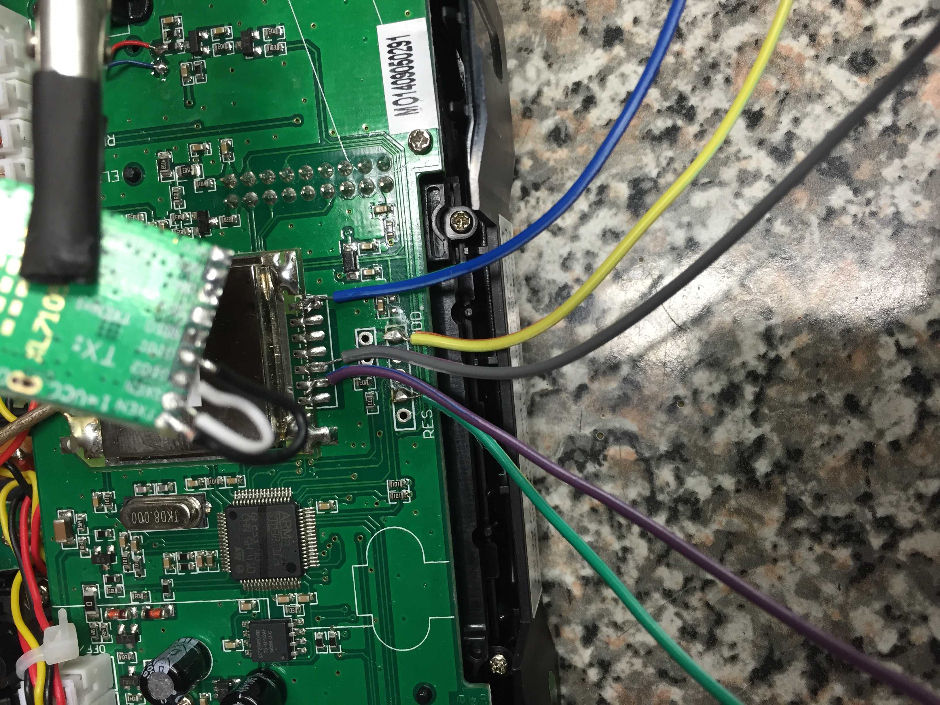

Need some help guys. I apologize for bringing this up again but I have read tons of post here about adding the a7105 module but I have not been able to get it right. First I used to "old" wiring diagram but had issues. It would not always bind right away and sometimes it would lose bind during flight. I just tried the "new" wiring digram put could not get it to bind at all. I did enable the a7105 and PA in the ini file. I just unsoldered almost everything and decided to start over. So if you guys would not mind taking a look at the picture and telling me where to put each colored wire? Would really appreciate it.

So I just soldered it up again using the "new" wiring. initially it bound to the hubsan right away. I flew for about 90 seconds and the motors stopped and it fell. Unplugged battery and turned off devo. Turned dev back on.....plugged in hubsan battery and it bound right away and flew for about a minute. Now it won't bind at all. WHAT AM I MISSING HERE??

Problem solved. Ordered a new A7105 module. Works great with hubsans now.
