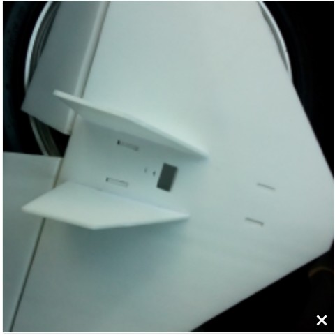

Right now, i have build this :
This is, delta swapable from flite test.

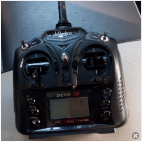

And this my transmitter :
Devo 7e with deviation 1.7 firmware.

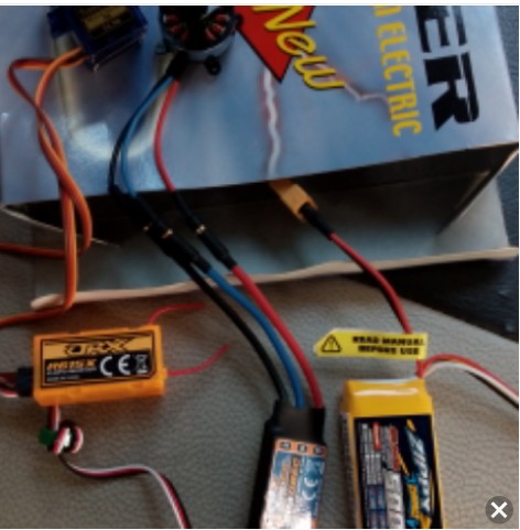

And also, this my electronics hardware :
And my question is, what should i do to make all of this to become dual aileron and dual elevator.
