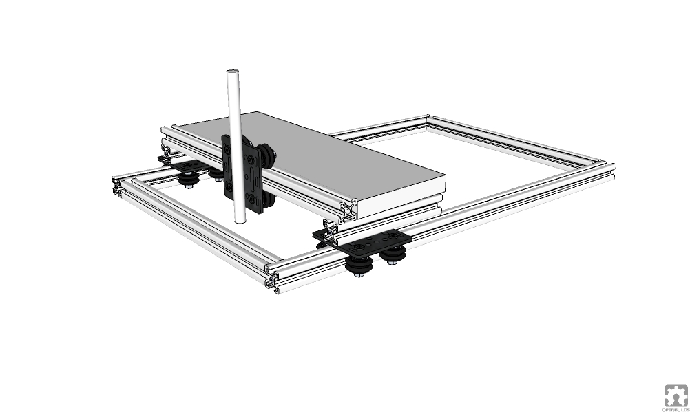

I already have a bunch of 2020 v-slot 2020 extrusion around, so I thougt I'd make mine out of that. I whipped up a quick sketchup to see how it'd look:
Building it out of extruded aluminum is certainly more expensive than SadSack's link, but since I have most parts lying around, it won't be too bad. I just needed a few extra wheels and the gantry plates as well as a better pump, a foot switch and needle bearings. I am still trying to decide how big I need it. I think I'll make mine a little smaller than vpapanik's. roughly 500mmx250mm which should be plenty large for any board I am likely to hand-assemble. Once the spare parts come in, I'll try to throw it together and hopefully have it working before it is time to assemble the next iteration of the UniversalTx board.

Looks the part.
I would add a witness guide IE print out of each individual values on pcb. So you know with out thinking where next part goes.

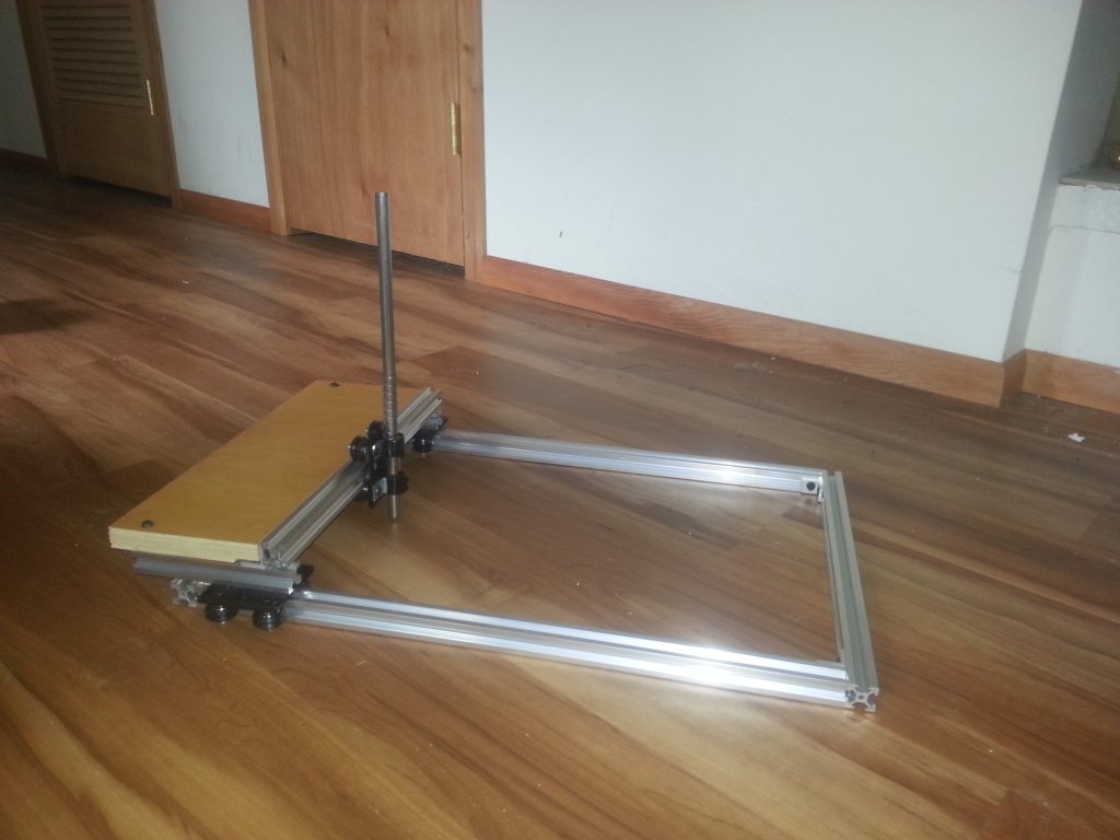

I built the p&p frame:
it seems to work well, except for the spring-loaded vacuum tube. The needle bearings don't work really well for sliding in and out. I tried a steel tube instead of aluminum but it didn't help much. So I still need to work on that still. I also need to 3d-print some end caps for the vacuum tube.
I ordered some linear bearings and a matching tube, which will hopefully take care of the issue.

yep, that is exactly it. In this case, I use an aquarium pump (which can easily be reversed to a suction pump), so not too much flow. I'm planning to use a foot-switch to control it, because from prior experience I found that any movement of my hand tends to cause jiggle that mis-aligns the part. The vacuum assembly is spring-loaded and can rotate and move in the z-axis, which makes it easy to precisely align parts.
I found that the needle bearings can work ok if you use 2 AND you get them precisely aligned. I did that by abutting them, and now my tube slides easily enough, but I still plan to replace the assembly with linear bearings which should be more precise.
As far as motorizing it, I think this isn't the best design for that. The complication in pick&place is the machine vision which identifies whether the part has been picked up and its orientation. They aren't easy tasks to solve. But for prototyping, I am hopeful this machine will make assembly much less stressful. We'll know in a couple weeks once the next generation of boards come in.
Now that I have all this equipment, I may run another round of multi-module boards using SMT components.
