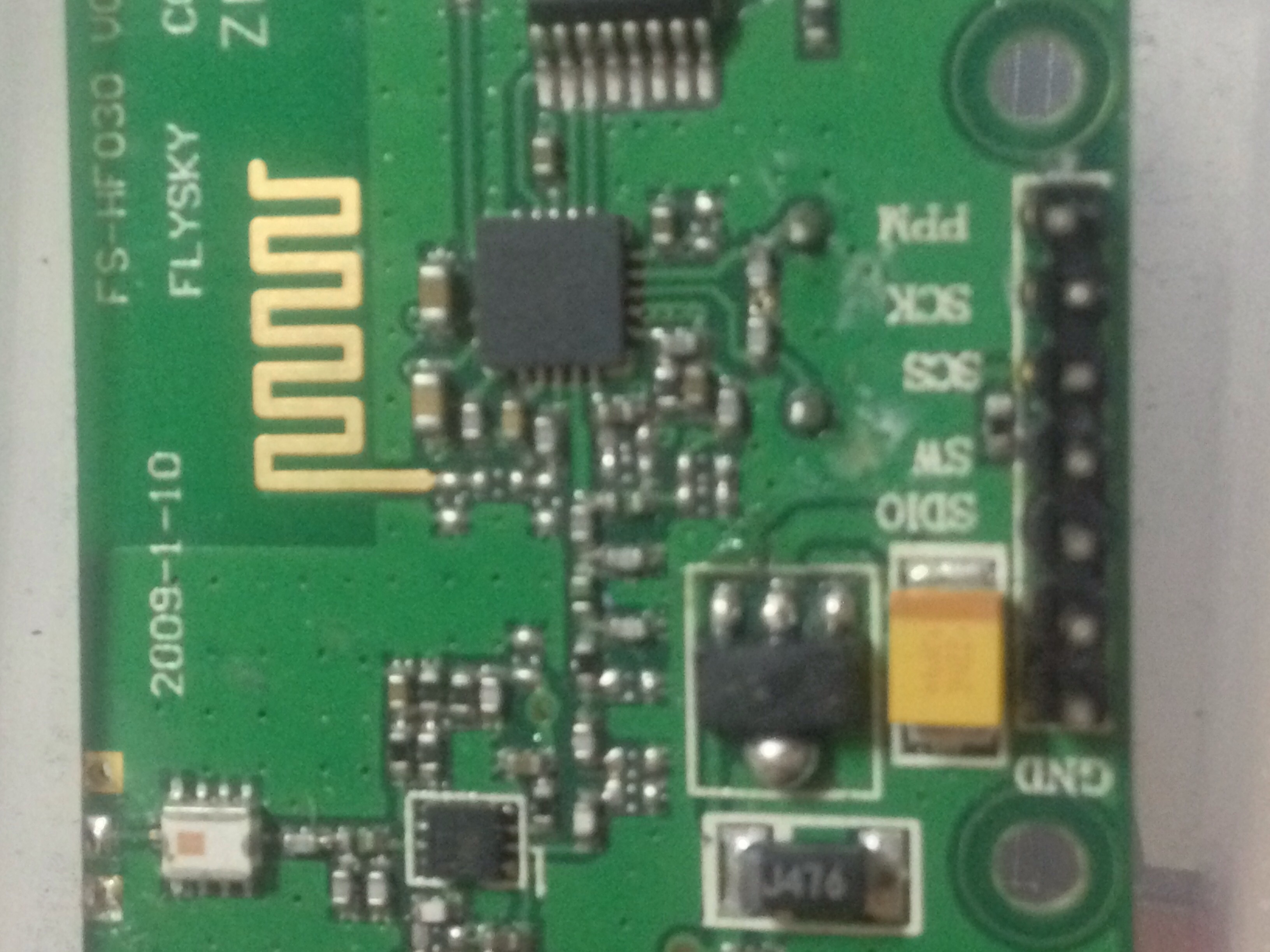

Yes typo for sure, I meant the regular STM32f103c8t6, it's the most common Dev board on eBay with 32k. So the Discovery would do the job? Well my biggest concern, and the main reason why I reached out to you guys is your Master RF Crack/Development Skills. I would love to eventually computerize an FG series, but I really need to get a KN protocol module together ASAP, as I have a v966 on its way, and like nine Eagles they use different chips, and protocols for different aircraft without any mention, nor rhyme or reason. I have plenty of Nrf24 modules to use if they infact communicate with the Beken, and if there is some way to pull that code and use it together with a ppm decoder code to make a module so I can fly it sooner than never. Perhaps I'll stumble upon brand new stock transmitters for it for $4.99 as I did for Nine Eagles, So I bought one of each and the TX specified on the box of the plane was the one that didn't work! Oh Ive noticed on my stock Flysky 9x module that there are 2 seperate antennas that do not do the same thing, the PCB antenna isn't connected to the A7105 but there is a jumper to I assume use it? I know you cracked that protocol and if I remember there is the possibility of 2-way or telemetry. Would this be the reason for the PCB antenna? My other stock 9x module hade the interference sheild, so I couldn't compare. Well thank you so much for the information, it is truely appreciated.

Awesome! I am very familliar with the multi-protocol thread by Medic I may have his name wrong, so I have actually used that tutorial for a few modules I have made myself, and I do have the proper Nrf24l01 tx module. Is there one that's better than than others, I've got a bunch of them, and different ones, I know the pcb antenna is not the best to use, as I have ones harvested from Transmitters from RTF Heli's, quads, etc. I'm guessing the module from a heli-max 230 si TX is the best one in terms of range. There are 2 ICs on the module with a wire antenna soldered on, I'm positive it's Nordic because the flight control board is a Nordic RF controlled board. I don't believe there is any difference in the Nine Eagles NE-024G TX, and it's intact, making that decision obvious. What do I need to look out for to Isolate the the KN protocol from the full code? Actually since I have a NRF24, A7105, CyRf I may as well just include those models as well, and utilize the protocols I can. I've got BNF Blade, Hubasan, Flysky receivers, and tons of DSM2 receivers and DTF. Thank you guys so much, I can't convey how much I really appreciate the info, and taking your time to help me get my problem solved, It feels much better now that I have a direction I can go to fly the V966 much sooner than I expected.
PS, do you know what the reasoning for the pcb antenna on a stock T9X V2 stock module is for?
Sam
