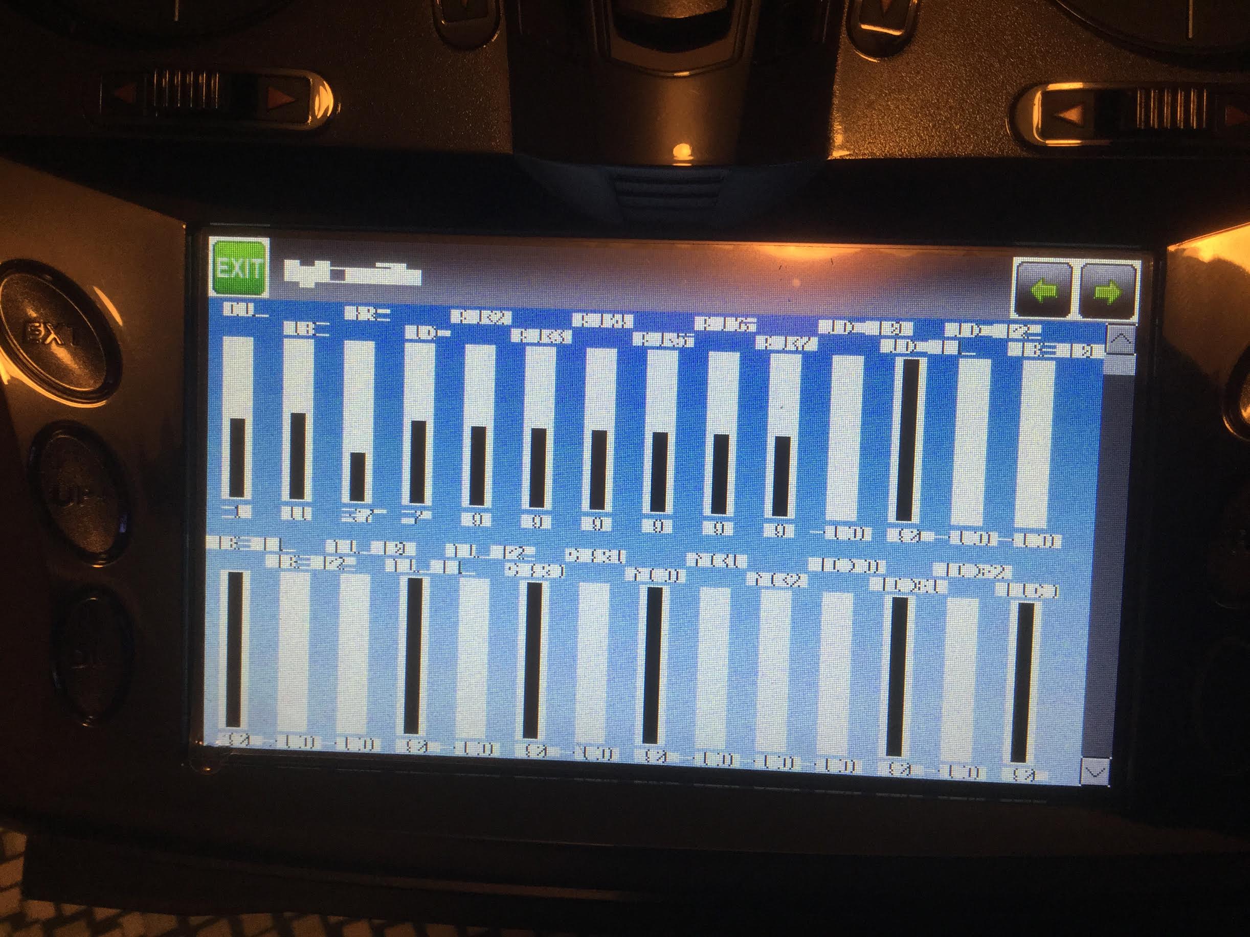

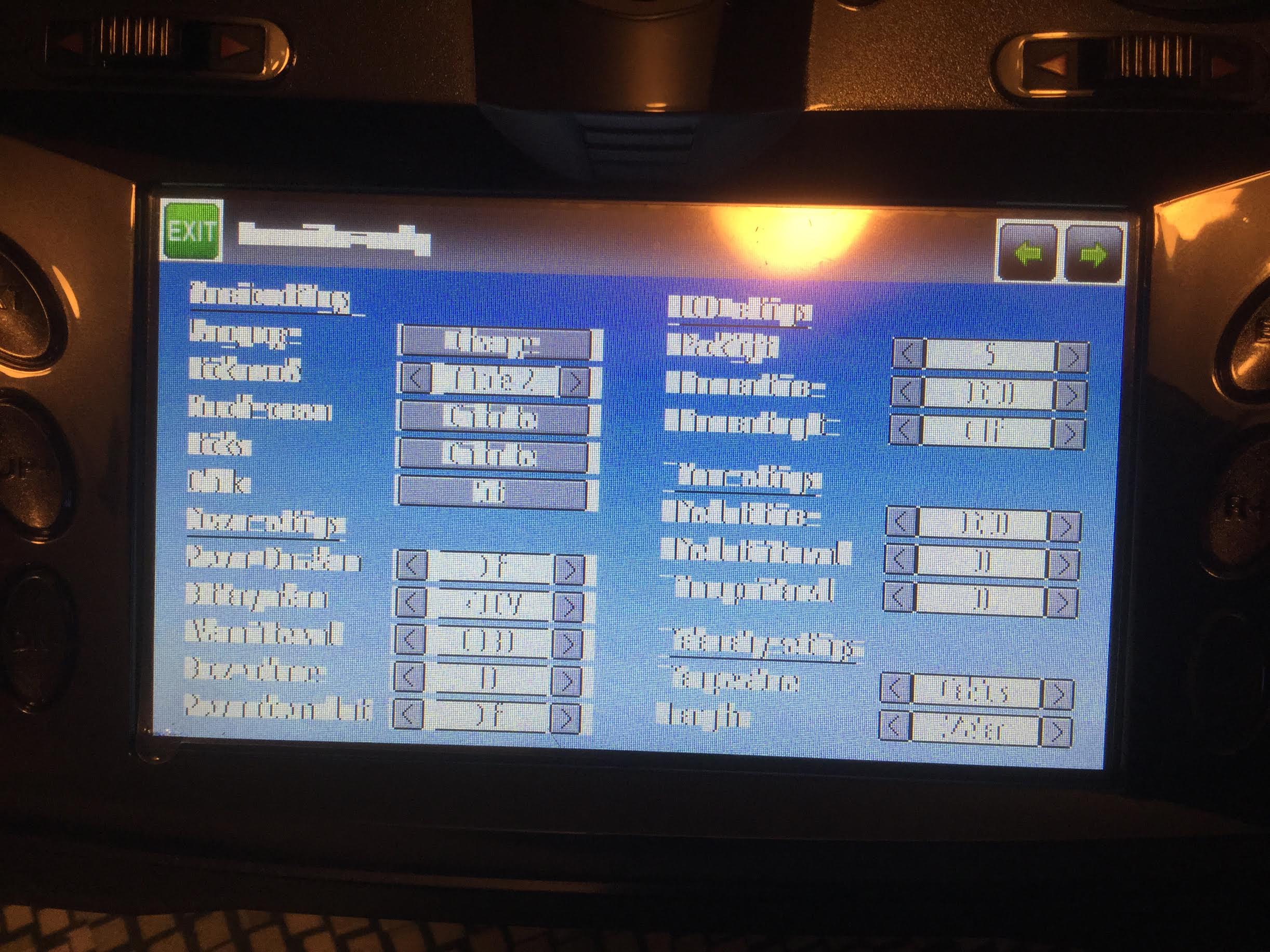

i tried everything from nightly to the latest to even the oldest firmware but after updating the firmware and the library the fonts is just messed up , can any here help me and point me in the right direction.I was able to install the deviation on my older 12s which i sold now i just bought another one but this time its a nightmare to update the firmware . Please help.

That is really weird. The white boxes around everything indicate that transparency isn't working and that white is being printed wherever transparency should be, but that makes no sense. have you put the Walkera firmware back on and made sure it works properly?
I guess it is possible they used a different version of the LCD driver, but it seems unlikely. taking a piicture of the LCD chip inside might help.
You could also try using 'verify' to check the devo12-lib.dfu was uploaded properly (make sure to use a freshly unzippped copy to verify (note, you can't verify the firmware, only the library)

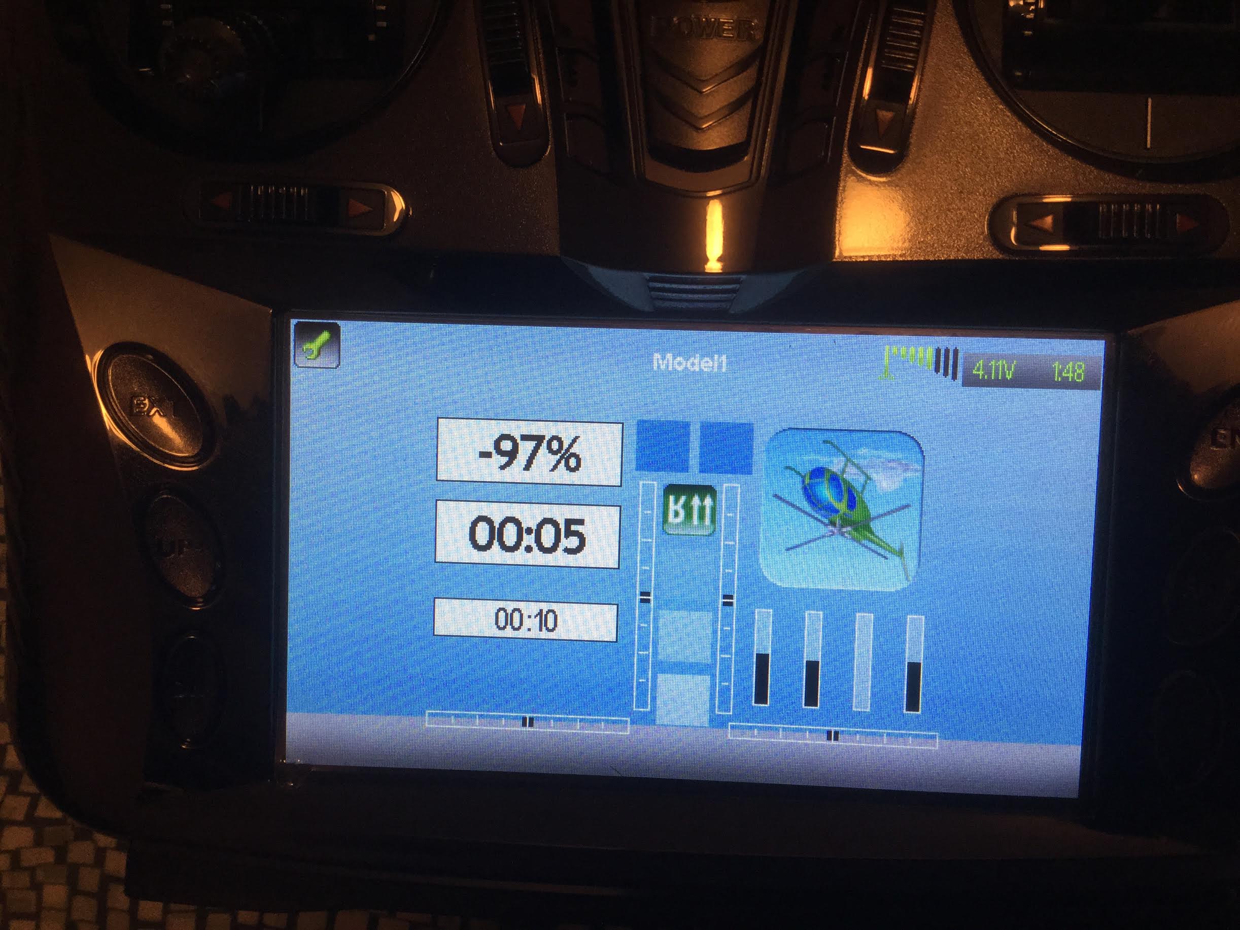

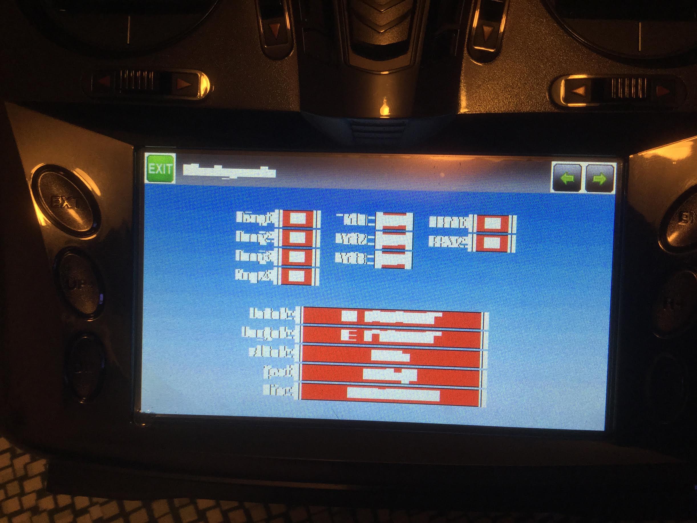

i tried installing from scratch and verified the lib file and all is good but still doing the same thing , everything works fine i just cant see the text. Here's more pics.

it definitely is the transparency that isn't working. It has nothing to do with the filesystem I think. The question is why it doesn't work.
I checked the manual for the S1D13517, and the 1.5 manual says:This is a change from the 1.2 spec which didn't include that last bit.
We normally set '52h=0x0b' and it has always worked in the past. So it looks like Epson may have made a minor revision and something that used to work no longer does.
The good news is that I am sure this can be worked around. The bad news is that I have no idea how yet. The reason we use flipped images is because the bmp format is drawn from the bottom to top. I will need to do some experimentation to figure out a reasonable solution.
A transparency function is available for image data writes. When enabled, input image data matching a specified
key color is not written to the memory. This function can be used to overwrite text and icons in display data. This
function can not be used with rotation and mirror function, the REG[52h] bits 3-0 never be set to the value 9h,
Ah and Bh.We normally set '52h=0x0b' and it has always worked in the past. So it looks like Epson may have made a minor revision and something that used to work no longer does.

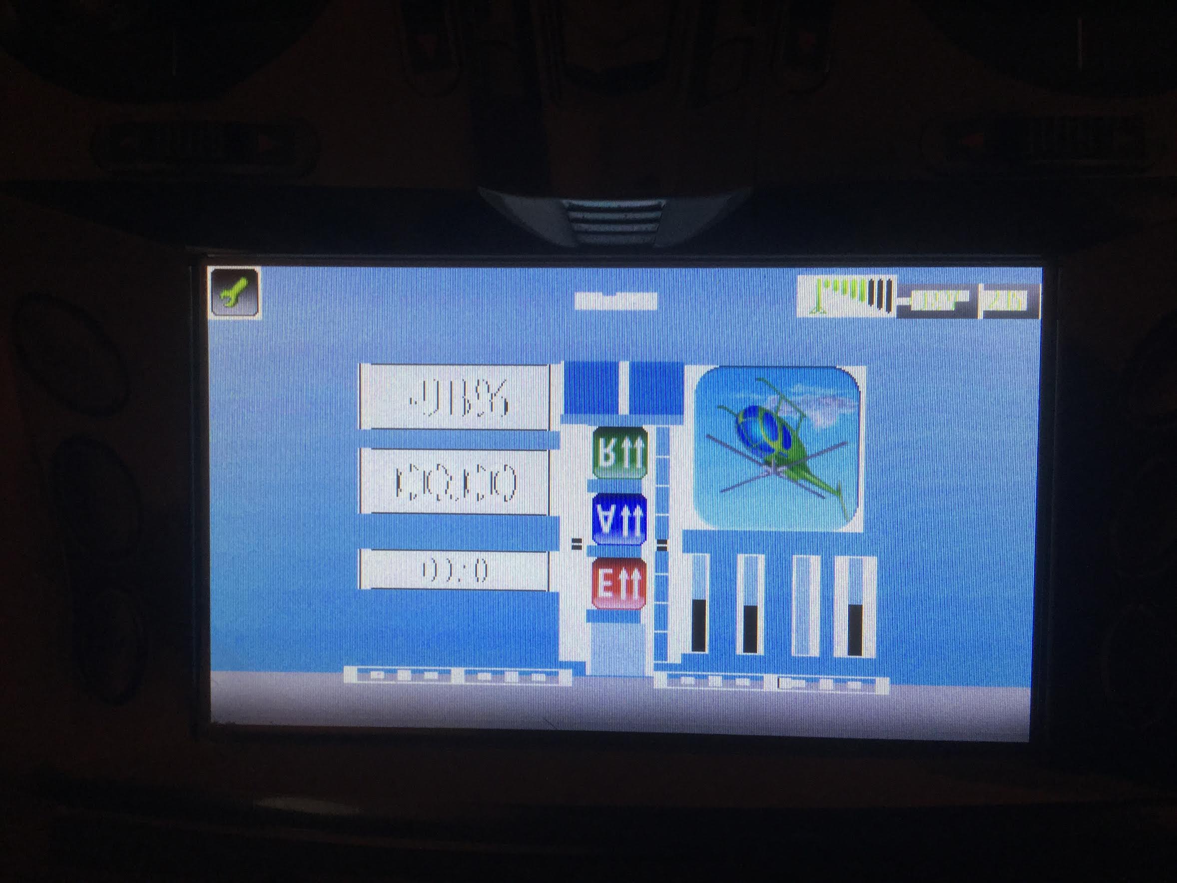

pictures are all upside down.

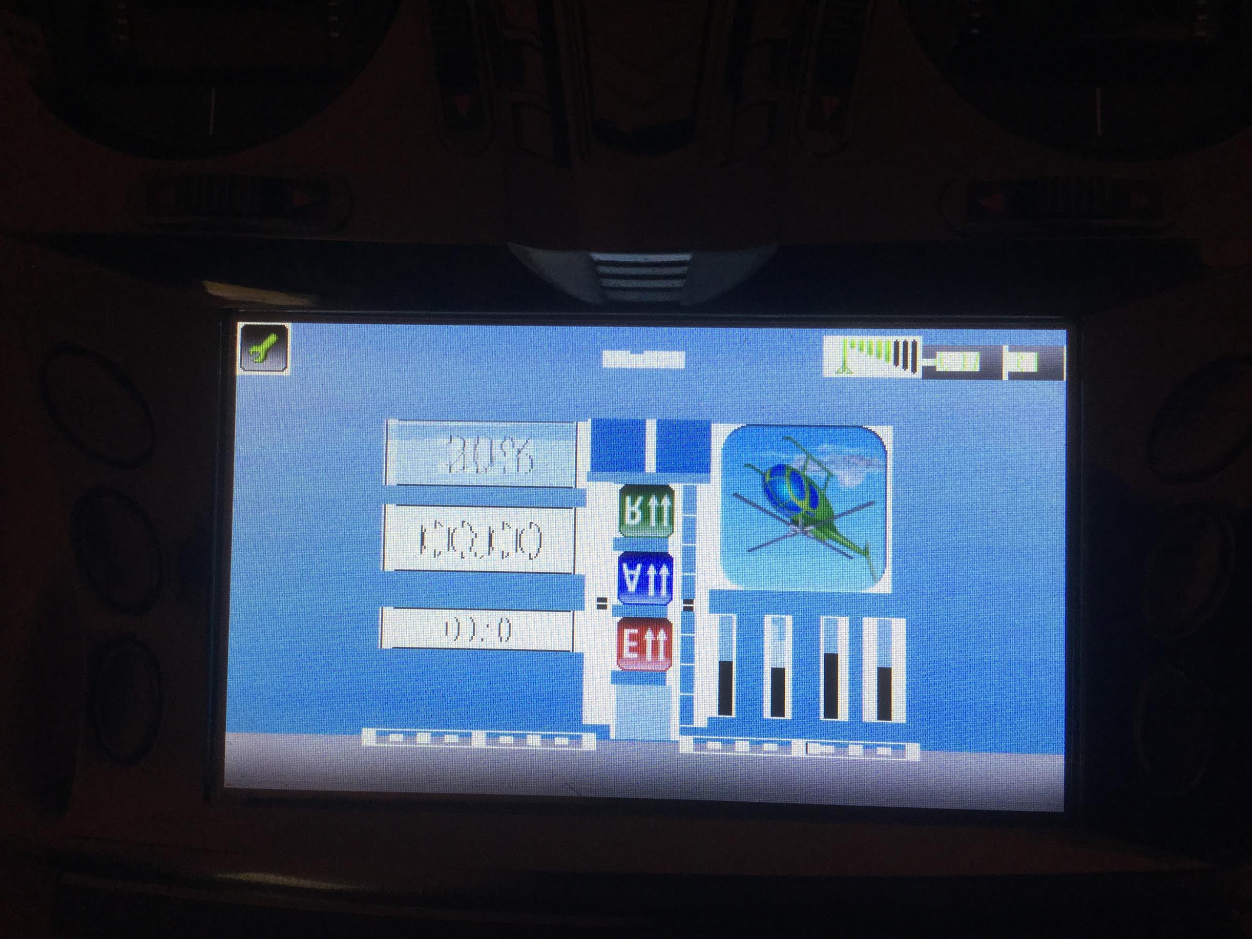

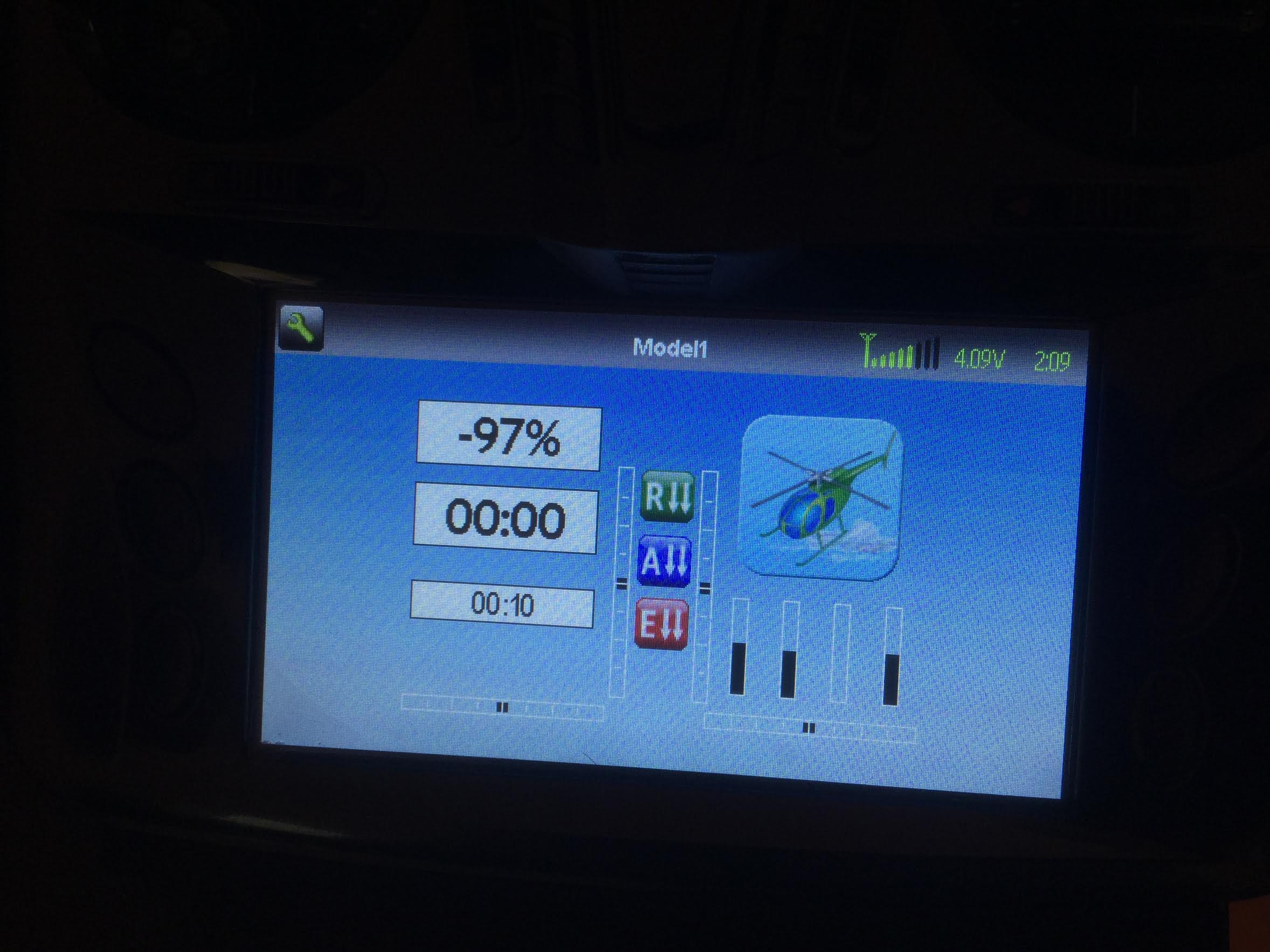

holy macaroni it worked!!!! i can see the text now although the text is still upside down but the white part is gone!!! Your awesome sir!

can you correct the text please
06 May 2015 04:01 #32155
Replied by PhracturedBlue on topic Please help Devo 12s fonts is out of wack
can you post a screen-shot?
I want to make sure it looks as I expect.
I will then give you 2 other builds to see if they change anything. I need to know which changes I made are making it work.

06 May 2015 04:01 #32156
by mrbeefy
Replied by mrbeefy on topic Please help Devo 12s fonts is out of wack
heres the picture
- mrbeefy
- Posts: 41
06 May 2015 04:09 #32157
by mrbeefy

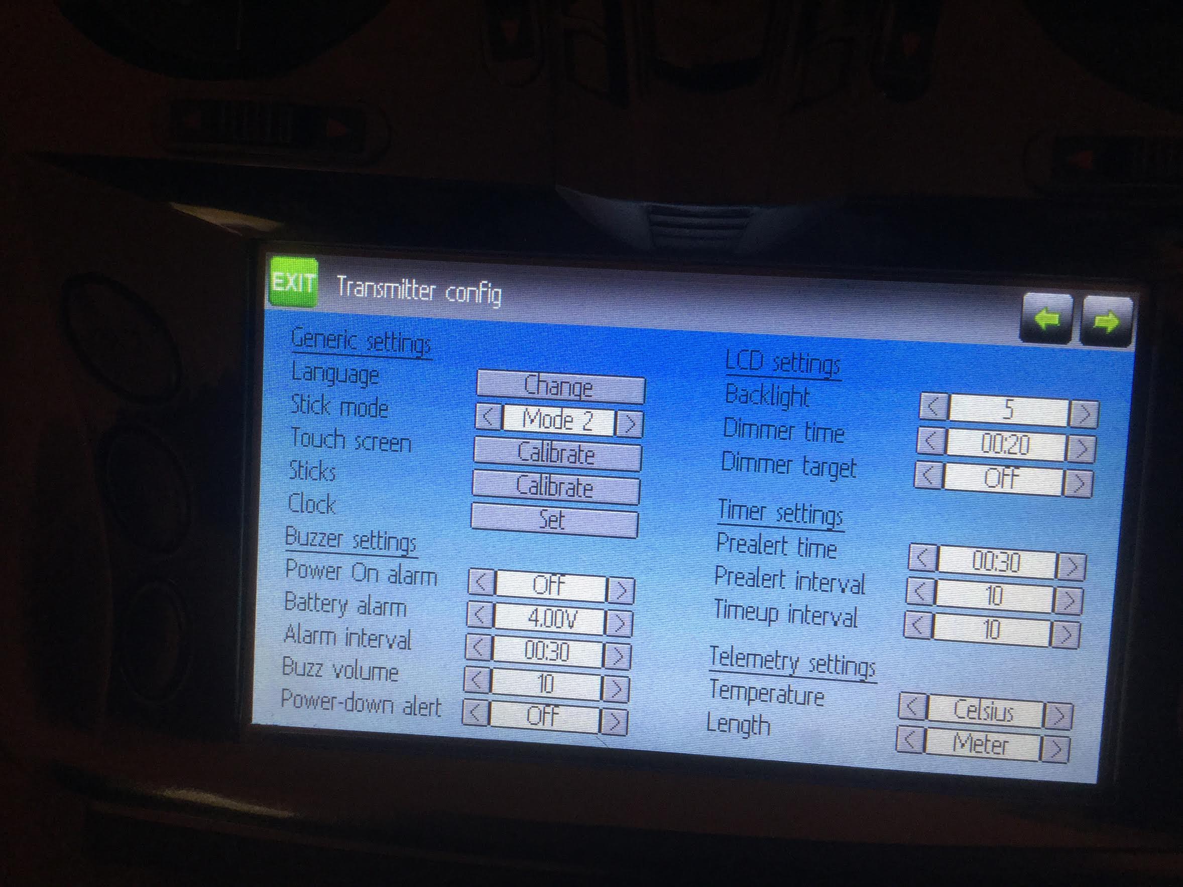

fonts are all in correct orientation just the graphics.
06 May 2015 04:10 #32158
good. that is exactly what I wanted it to look like.
The these:
www.deviationtx.com/downloads-new/catego...-devo12-lcd1-5-test3
please try both the _2 and the _3 and post screenshots of both of them they may either or both be worse than what you have now. I just need to know which change I made has an effect
The these:

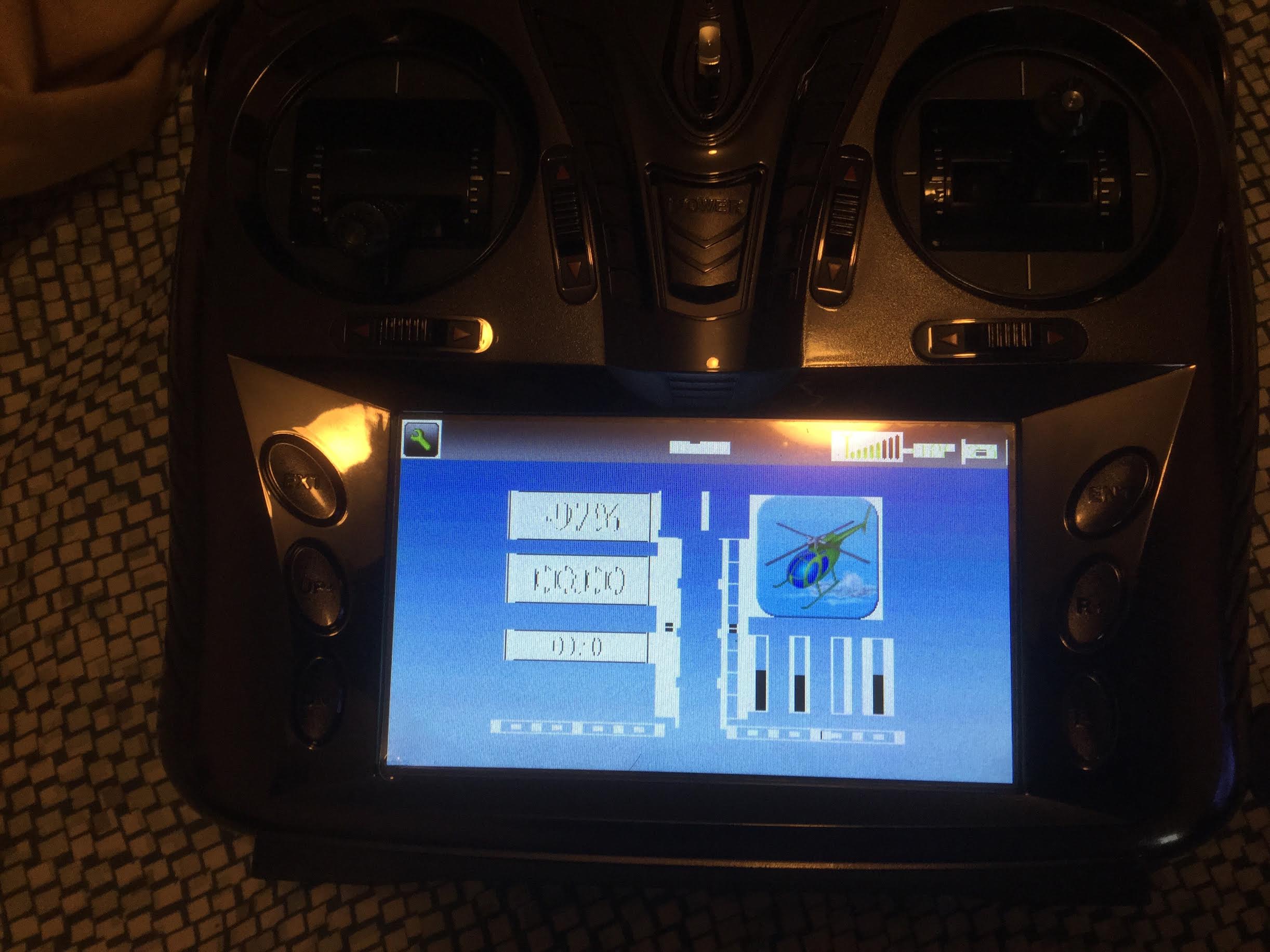

06 May 2015 04:25 #32160
by mrbeefy
heres the 2nd firmware
- mrbeefy
- Posts: 41
06 May 2015 04:29 #32161
by mrbeefy
3rd firmware , back to the same problem so firmware 2 fixes everything
