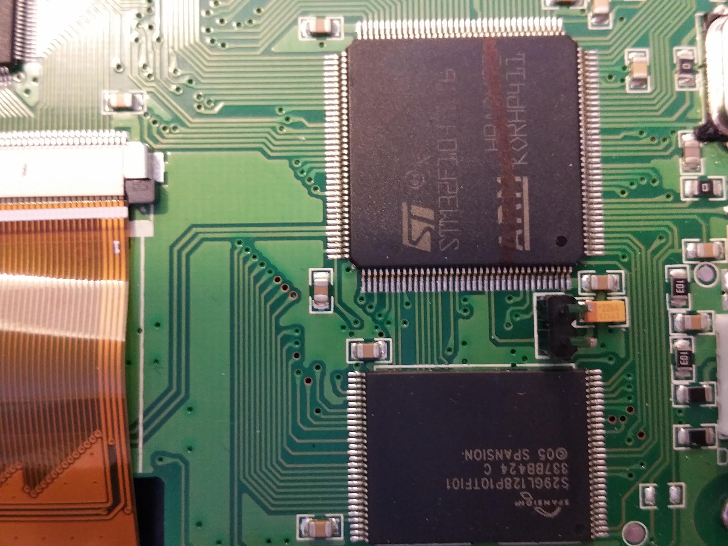

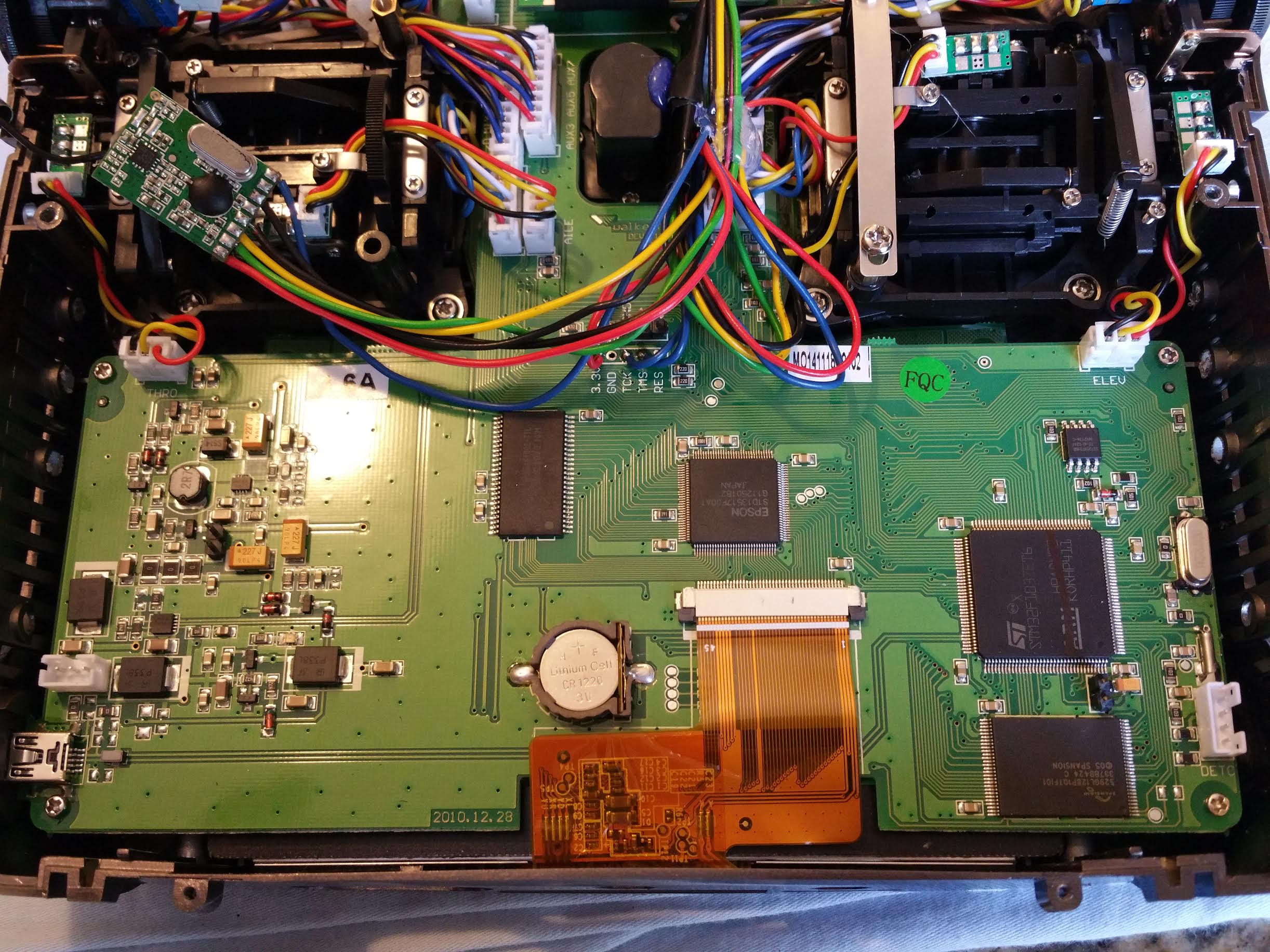

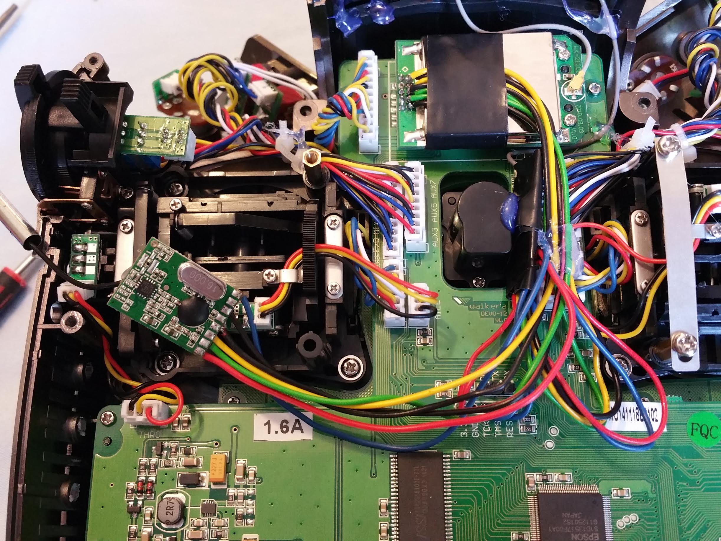

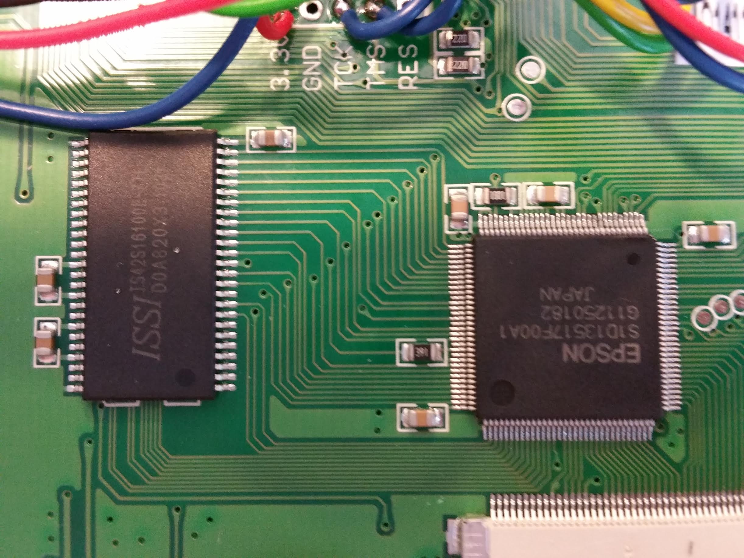

06 May 2015 16:21 #32179
Replied by PhracturedBlue on topic Please help Devo 12s fonts is out of wack
It would be helpful if you could take a pic of the circuit board to help identify whether the graphics chip is different. In the next build, I'll have it output the chip id too to see if there is any way we can detect this difference. I may not get to it until this weekend though

07 May 2015 01:37 #32194
by mrbeefy
Replied by mrbeefy on topic Please help Devo 12s fonts is out of wack
heres the pictures as promised
