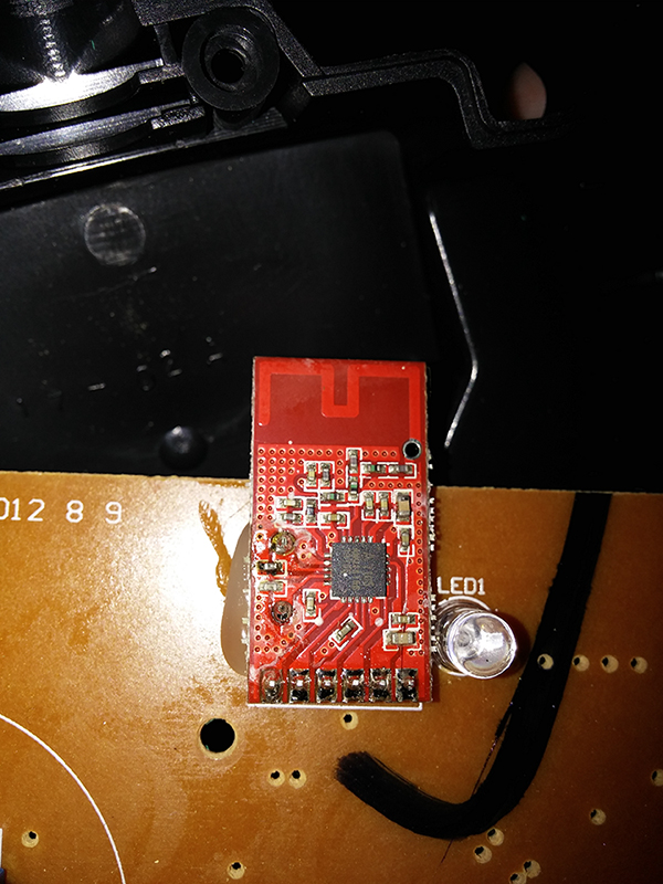

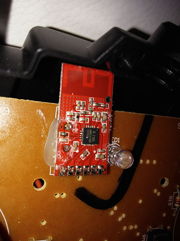

07 May 2015 01:32 - 07 May 2015 01:35 #32193
by Cedrusx
Help with A7105 module was created by Cedrusx

07 May 2015 01:38 #32195
by mrbeefy
Replied by mrbeefy on topic Help with A7105 module
absolutely, its the same exact one i used on my devo 12s
