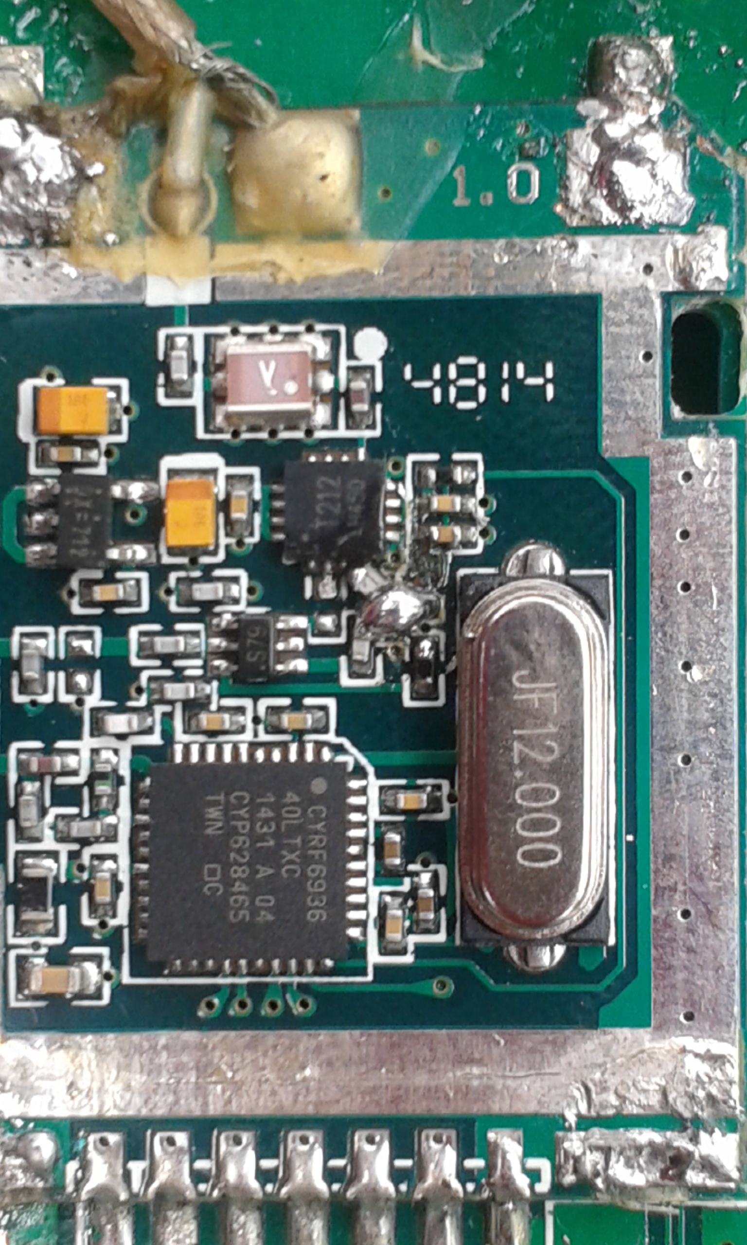

I have damaged my devo 7e stock module.I have attached some pics of it.I have no idea what to do ?
1. Can i replace Devo 7e stock module with a1705 module ?
2. IF it doesn't what to do ?
{THANKS FOR ANY REPLY]

No, you can't replace the stock module with the A7105. They are completely different things.
If you check the wiki ModuleList , you'll find links to three different CYRF6936 modules. Any of those should work. The first one is used in the Devo 6/8/10/12s, and while it won't plug into the 7e board, I believe it has been wired in successfully. Neither of the other two will plug in directly either, but they might be less expensive or smaller.
In the future, please only post once, and give people a day or two to answer.

In case the protective coating of the traces is not physically damaged, your module can be rescued by a person with soldering skills.
There are some shorts now. Removing the solder blob plus some of these solder splashes and restarting the work with a short wire will certainly help.

thanks amax ,i will try to give it for repair center.
any link for another module to replace cyrf 6936 module ?

www.banggood.com/Walkera-WK-DEVO-S-MOD-U...8S-12S-p-922596.html
That's as good as it gets, hope that helps.

... www.hacksmods.com/category/devo-2/lahiru4216 wrote: thanks amax ,i will try to give it for repair center.
Devo7e with fullsize RF module.

problem solved i ordered walkera devo s -mod module,I will try it ...
<<<<<<<<Fly Harder For More Fun>>>>>>>

Sorry Everyone for late reply.i got some problems with "account log in".i replaced stock devo 7e module with devo 8s 12s module>>>

www.hacksmods.com/2014/10/wk-devo-s-mod-module-for-devo7e/
HERE IS THE LINK FOR REPLACING 7E MODULE..
