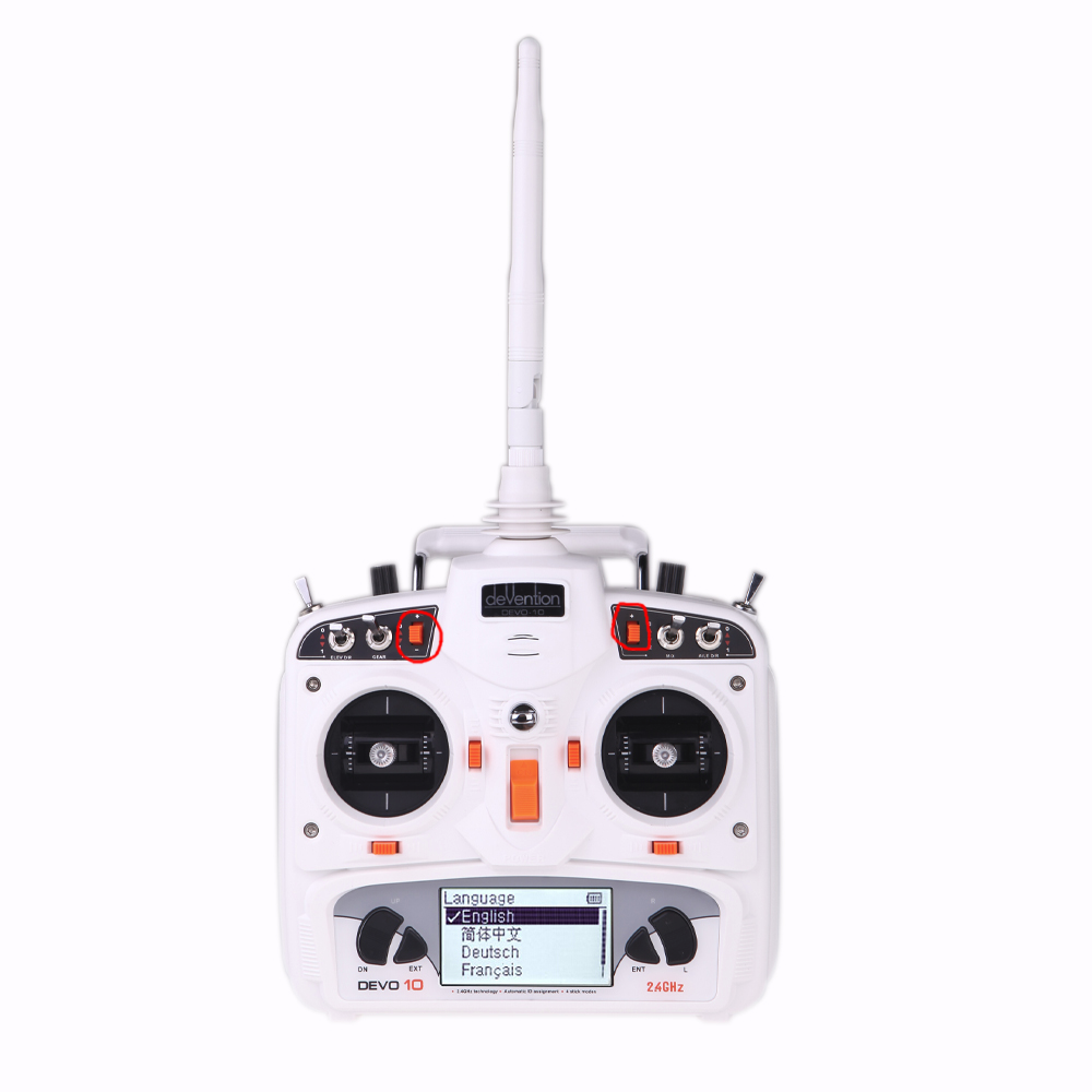

OK so im trying to use the TRIM_L and TRIM_R to control a timer but i cant figure out how to assign anything to them.
can anyone assist, im a little lost on this one.

oh, I was confused cause there's more than one set of trims, that's good cause that's what it's easy to use. So just to be clear, you're asking about the right stick left-right (AIL) trimmers? Or the left stick left-right (YAW) trimmers?
- aperseghin
- Posts: 55
20 May 2015 14:09 #32797
by aperseghin
Replied by aperseghin on topic DEVO 10 Left and Right TRIM assignment help
Look at this pic. the two trims circled
I actually figured it out. i have my upper left trim as TRIM UP = start a 5 min countdown timer and TRIM DOWN reset that timer back to 5 min

My guess would be that Cerial_Killer has devo 7e, because that transmitter does not have these 2 extra trim buttons. The other devo transmitters have those 2 extra buttons.

The top left trim is set so to control a timer. that timer starts at 5 min (or whatever i decide) and when i click it UP the timer starts, if i click it up again it pauses the timer, and if i click down it resets to 5 min.
Im going to use this as a battery flying time timer.
I could also make that timer a stop watch with start stop and reset all on that switch which i may do instead, i haven't really decided yet.
