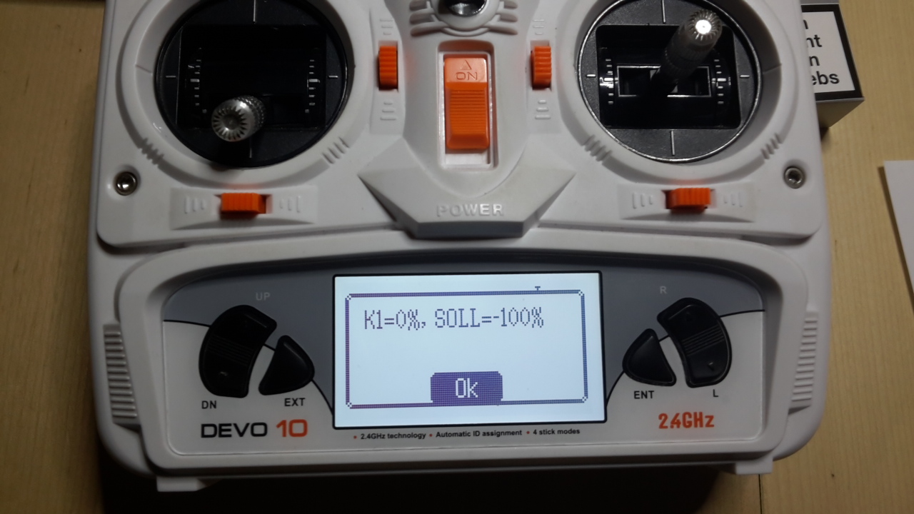

Hello together,
i have flashed my white Devo 10 with the version 4.0.1!
Every time when i power it on it shows " channel 1=0%; should=-100%".
It is my elevator stick. You can see it in the pic.
Is something wrong?
Best regards
Uwe

29 May 2015 18:12 #33194 by FDR
Replied by FDR on topic Channel 1 should -100?
This is a safety warning, that your throttle channel is not at it's minimum, which is -100%.
You are probably in the wrong mode,, like Mode1 instead of Mode2.
Close the dialog, and check the mode value in the tx settings...
29 May 2015 18:44 #33198 by aperseghin
Replied by aperseghin on topic Channel 1 should -100?
FDR wrote: This is a safety warning, that your throttle channel is not at it's minimum, which is -100%.
NO, this happens when you dont have the throttle hold turned on and your model setup keeps the throttle at 100% (like 6 channel 3d setup)
just flip your throttle hold switch.
29 May 2015 18:53 #33199 by FDR
It is unlikely that in idle up mode his throttle value is exactly the middle value.
Furthermore if he has just installed deviation, then the default model config is a simple 4ch one...
29 May 2015 20:00 #33206 by mwm
Replied by mwm on topic Channel 1 should -100?
This warning is coming from the model Safety settings, which aren't directly editable. The default setting is that the throttle output channel should be at -100, where the throttle channel setting is detected automatically. This is trying to warn you that if it goes ahead and connects, a propeller could start spinning. Turning on throttle hold, or lowering the stick in non-3d 'copter modes, or switching out of 3d mode, can all make this go away. You can also just hit Enter to connect to your model.
There have been reports (but no open issue) of a bug that causes it to get the wrong channel for throttle output. There are indications that being in the wrong mode can trigger this bug, but I don't see how. I haven't been able to recreate this. Could you please open an issue on the bug tracker in the menu to your left for this? State the version number, and upload both tx.ini and the model.ini file that's causing the problem.
And if that's what you are seeing, here's the way to fix the problem as opposed to the symptoms:
  1. Plug your Tx back into your computer.
  2. Boot it in USB mode by powering on while holding down the Enter key.
  3. Edit the file models/model1.ini (or whatever the current model number is) on that disk.
  4. Find the [Safety] section.
  5. There should be one line that says Auto=Min.
  6. Change the Auto to the throttle channel for that model, in the format Ch#. Typical is Ch3.
  7. Eject the disk, and power cycle the Tx.

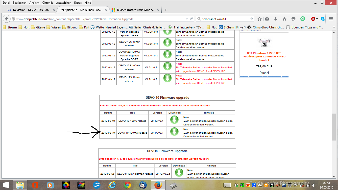

Before upgrading to 4.0.1 i have upgraded the Walkera software for 100mW. www.derspielstein.com/shop_content.php/c...ra-Devention-Upgrade

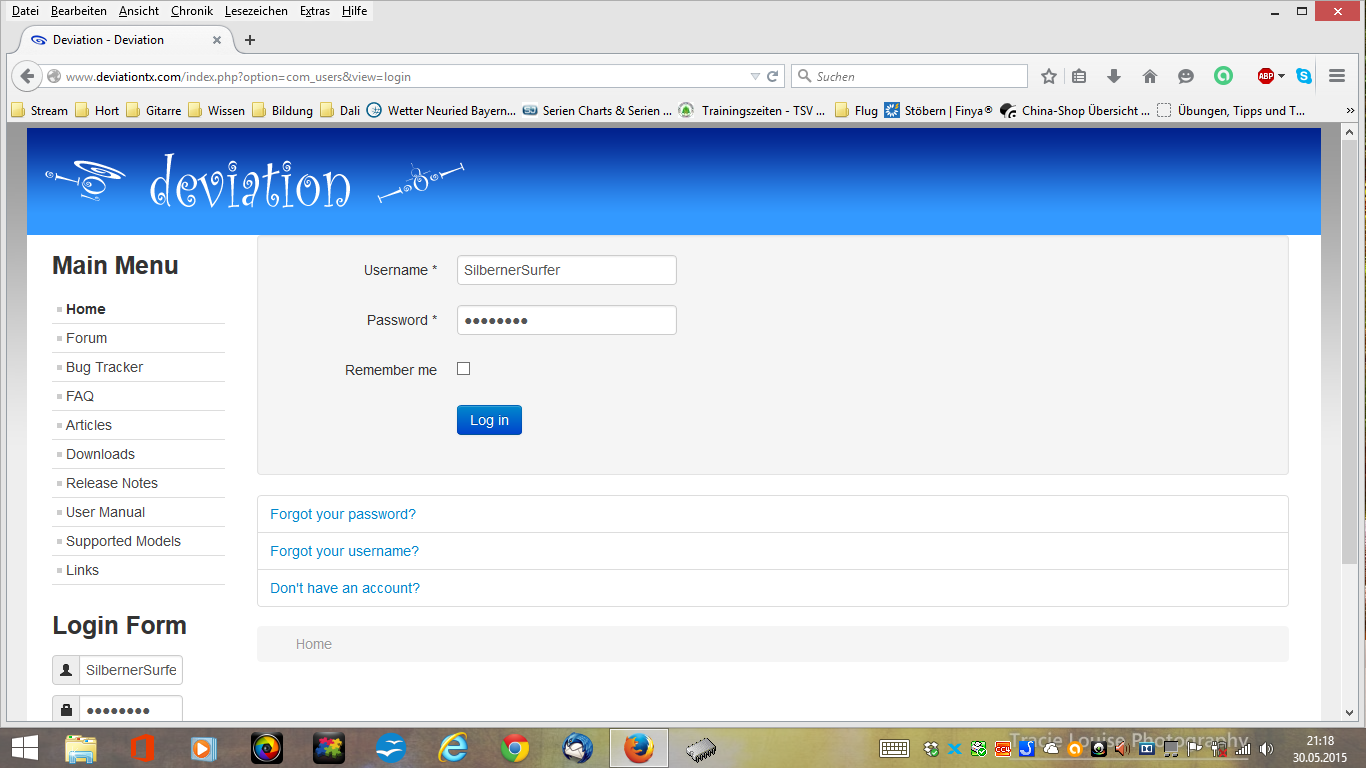

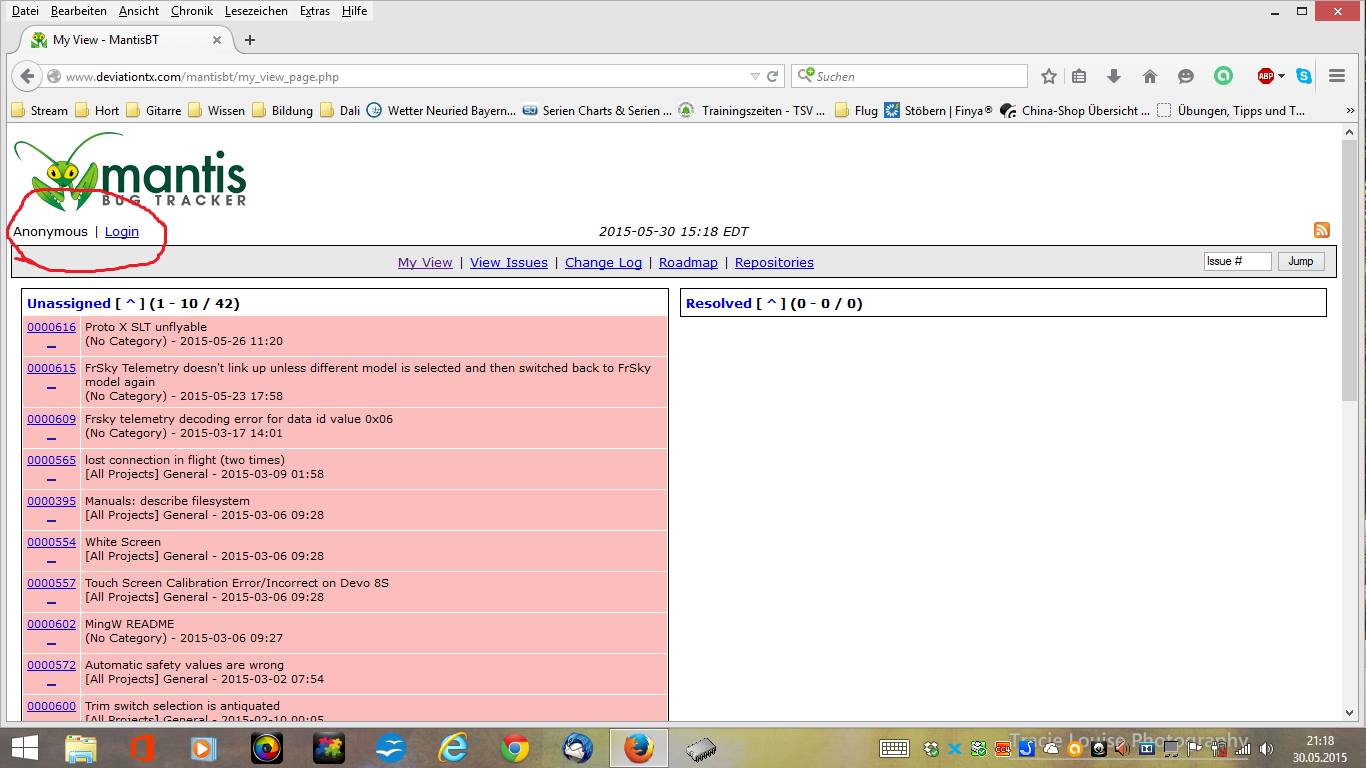

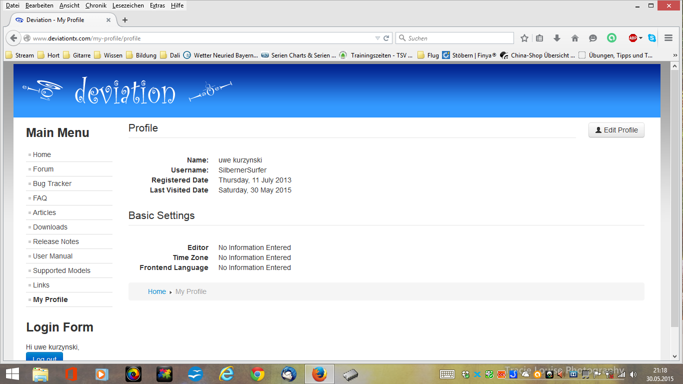

After clicking on the bug tracker i get this:
After clicking on login at mantis i get this:
After clicking on login at DeviationTX i get this:
30 May 2015 19:33 #33260 by PhracturedBlue
Replied by PhracturedBlue on topic Channel 1 should -100?
does it work if you press the 'Remember Me' button? I will see what I can figure out, it certainly should not do that.

30 May 2015 19:38 #33262 by SilbernerSurfer
Replied by SilbernerSurfer on topic Channel 1 should -100?
Yes, it works now with the remember me button.
