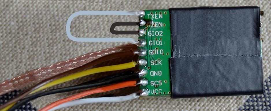

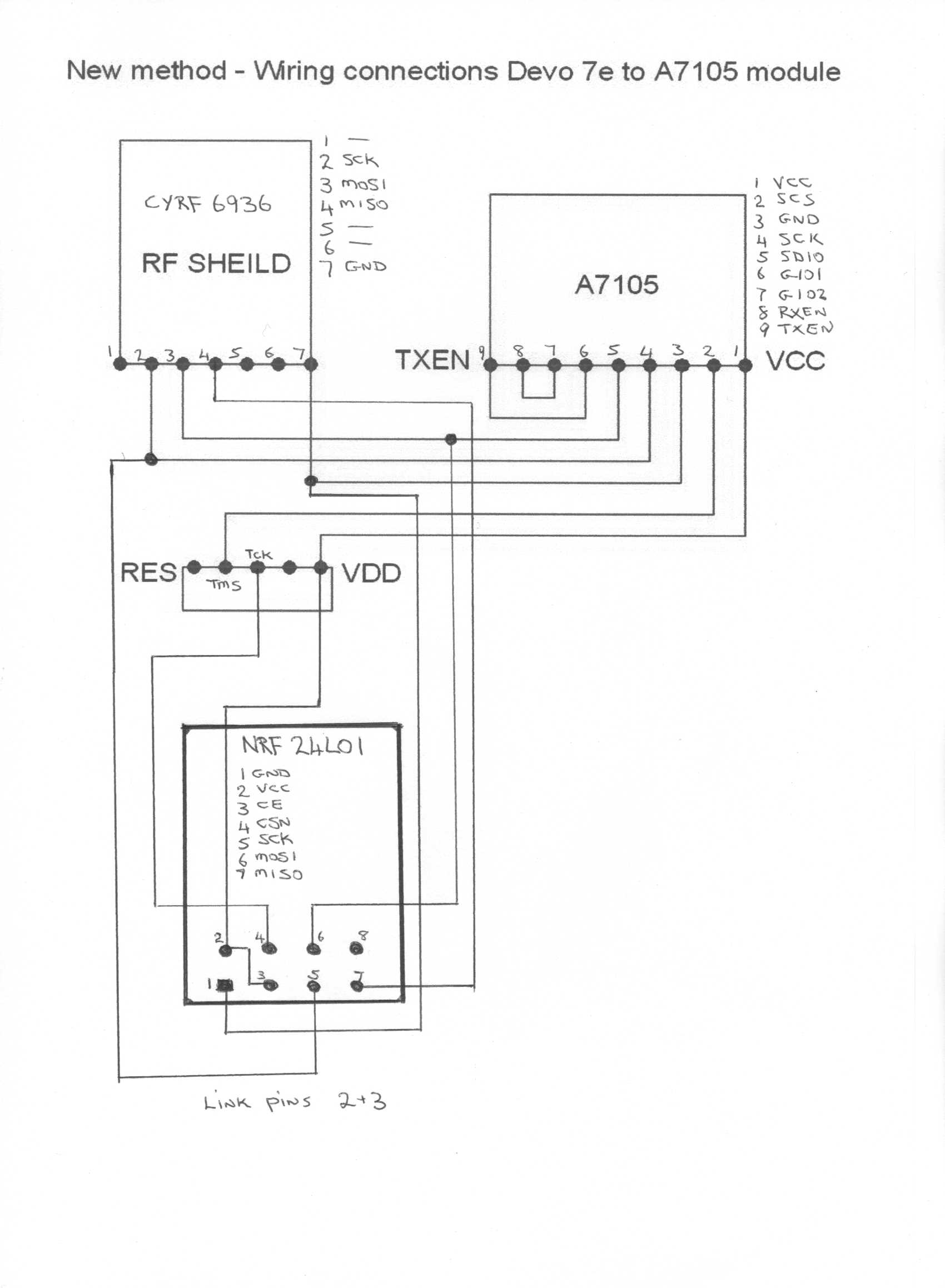

07 Jul 2015 02:51 - 07 Jul 2015 03:21 #35187
by Doug40
Replied by Doug40 on topic replacement sticks for Devo 7E
The Banggood page does not contain the latest jumpering of the A7105 that was the recommendation when I installed the same module in my 7e a few weeks ago. I don't remember all the details, but the change reduced the power consumption and something else. I think maybe the nightly builds were required to use that wiring. I used the jumpering in the photo below. I think the remainder of the wiring was the same.
Last edit: 07 Jul 2015 03:21 by Doug40. Reason: add wiring diagram
07 Jul 2015 10:51 #35196
Replied by mwm on topic replacement sticks for Devo 7E
+Doug40 (and everyone else adding any RF modules to a Devo): the proper wiring is documented in the module installation guide. That's currently the bottom link on the page you get from the Links entry in the menu on the left.
Your wiring is correct if you've installed a nightly build, and is documented as such.
The BG page wiring looks like it's the proper wiring for 4.0.1. Not clear what they mean by "Cathode", but if it's ground, that's the 4.0.1. wiring.
4.0.1 doesn't have the logic to disable the chips when not in use. So you wire enable and to ground, leaving the chips always on. So yes, changing the wiring and updating to a nightly build will reduce power output.
