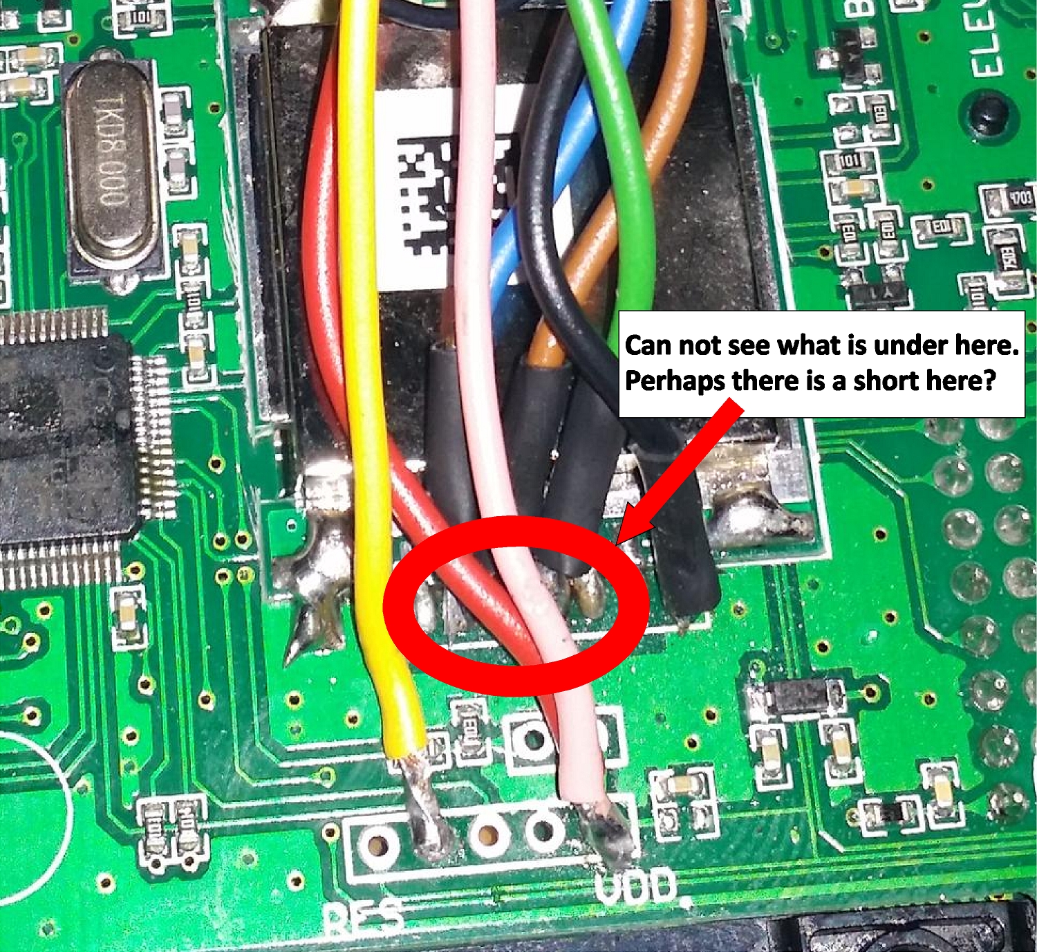

One other thing is, on a picture of your board mods that you uploaded:
Some of the connections to the CYRF module are obscured by the red and white wires leading to the 3.3v/VDD. Can not really see what is going on under there, but some of the solder beads appear to be very close to being in contact with each other. Not sure if that could result in your switch error if there was some kind of short at one of those points, but you might want to check and see if there is some tiny, stray, beads of solder causing havoc.

I didn't see a response to my question. Did you check to see if there is a short between the 2 pins I circled with the switches unplugged? If you answered, I missed it.

I'm sorry, yes the two pins that you indicated and that I have circled, the tester always give they in short circuit. Could you indicate the link of these changes? So I try to do them. Thanks
