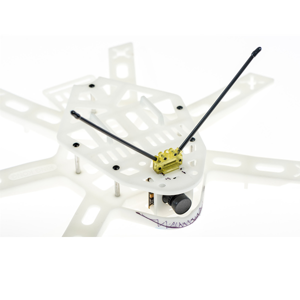

Thanks for the suggestion BirdBarber. That was actually done early on in the modding process. I initially attempted the bridge by using a solder pen but it didn't work. I ended up just removing the resistor and bridging the two pads with solder. Works perfect now.
Didn't realize that about the antenna on the AR610, MWM. That puts my mind at ease a bit. So, in theory I could use some of my 1.5mm heat shrink tube and "elongate" the antenna wires enough to work with the diversity mount that I have with the CC3D Atom.
