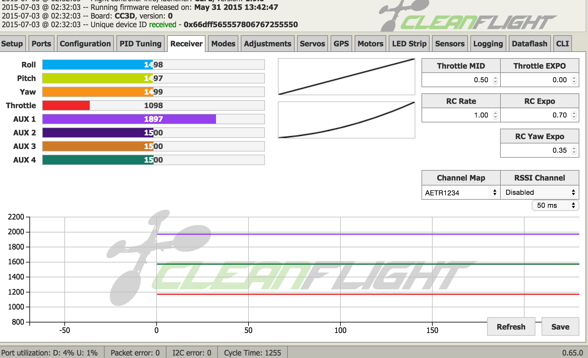

Hi all,
Does anyone having any issue with Cleanflight 1.9 (CC3D board)only able to detect AUX1 only whereas AUX 2,3,4 does not working ?
Thank you.
Thank you.

Yes, all of them working except AUX 2 3 and 4
I can't arm the motors now.

Nope. I did not enable PPM in CF (CC3D board)
All standard setting direct wired. 1 to 1.
please guide me how to get AUX2 , AUX3 , AUX4 working.
Appreciated.
(sorry for my english. asian)
Appreciated.

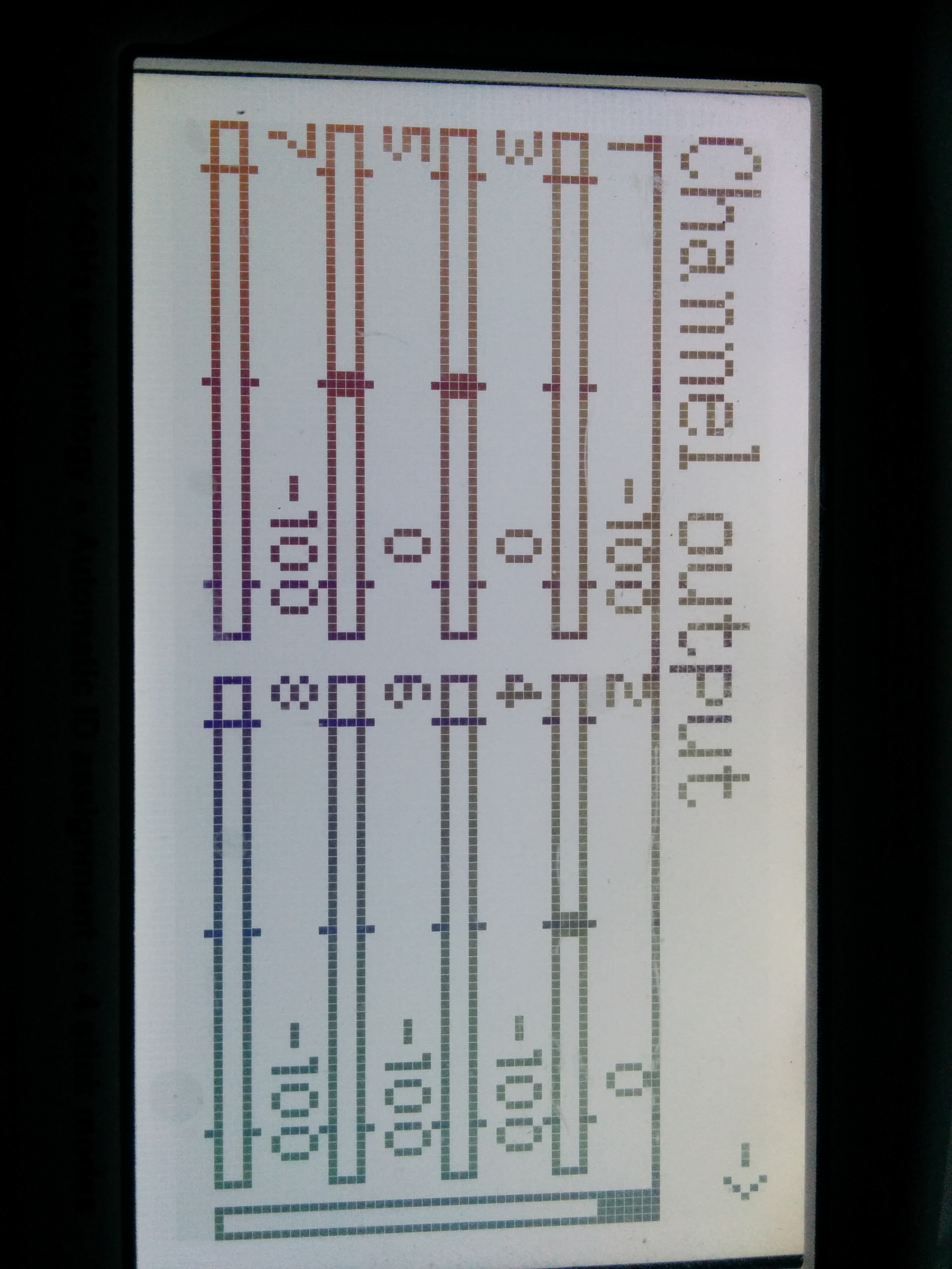

- Cereal_Killer
02 Jul 2015 17:23 #35001
by Cereal_Killer
Replied by Cereal_Killer on topic Cleanflight with Devo 10 and RX1002
Can you please go to your channel monitor page (in the transmitter) and make sure you have channels being outputted?

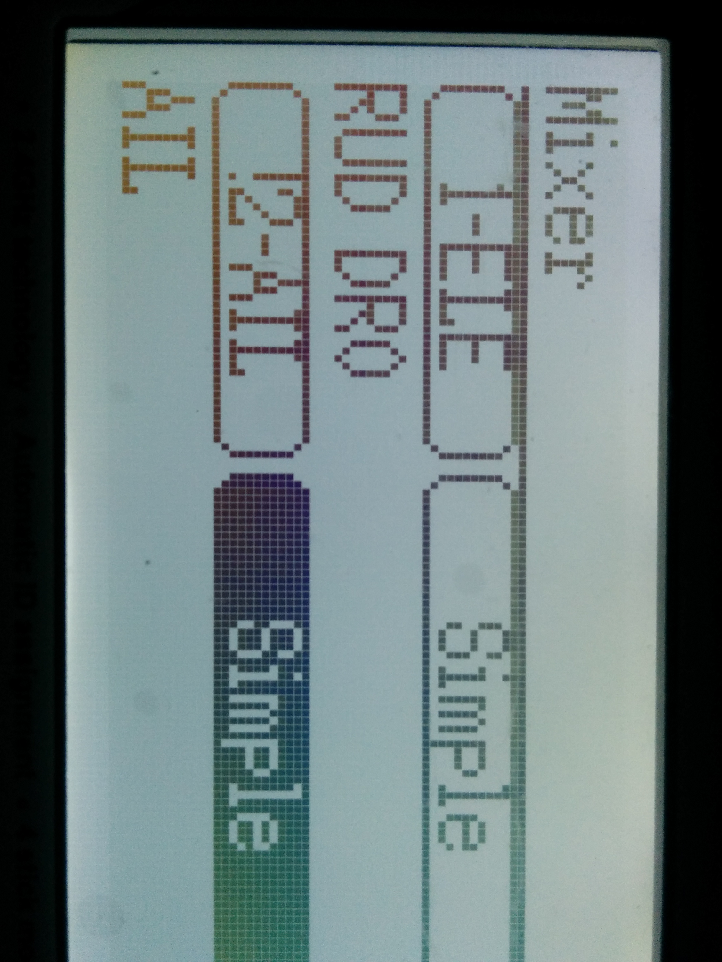

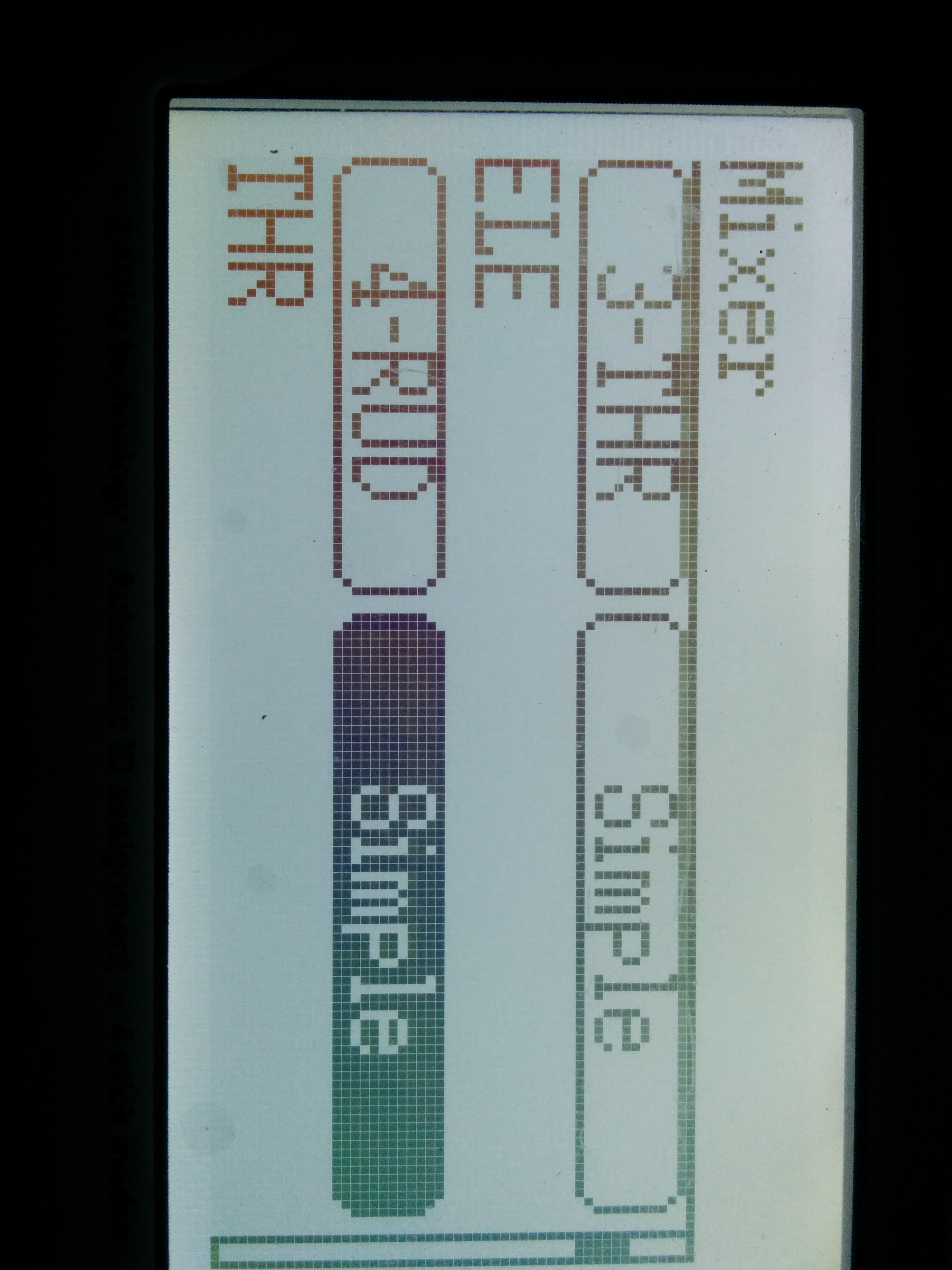

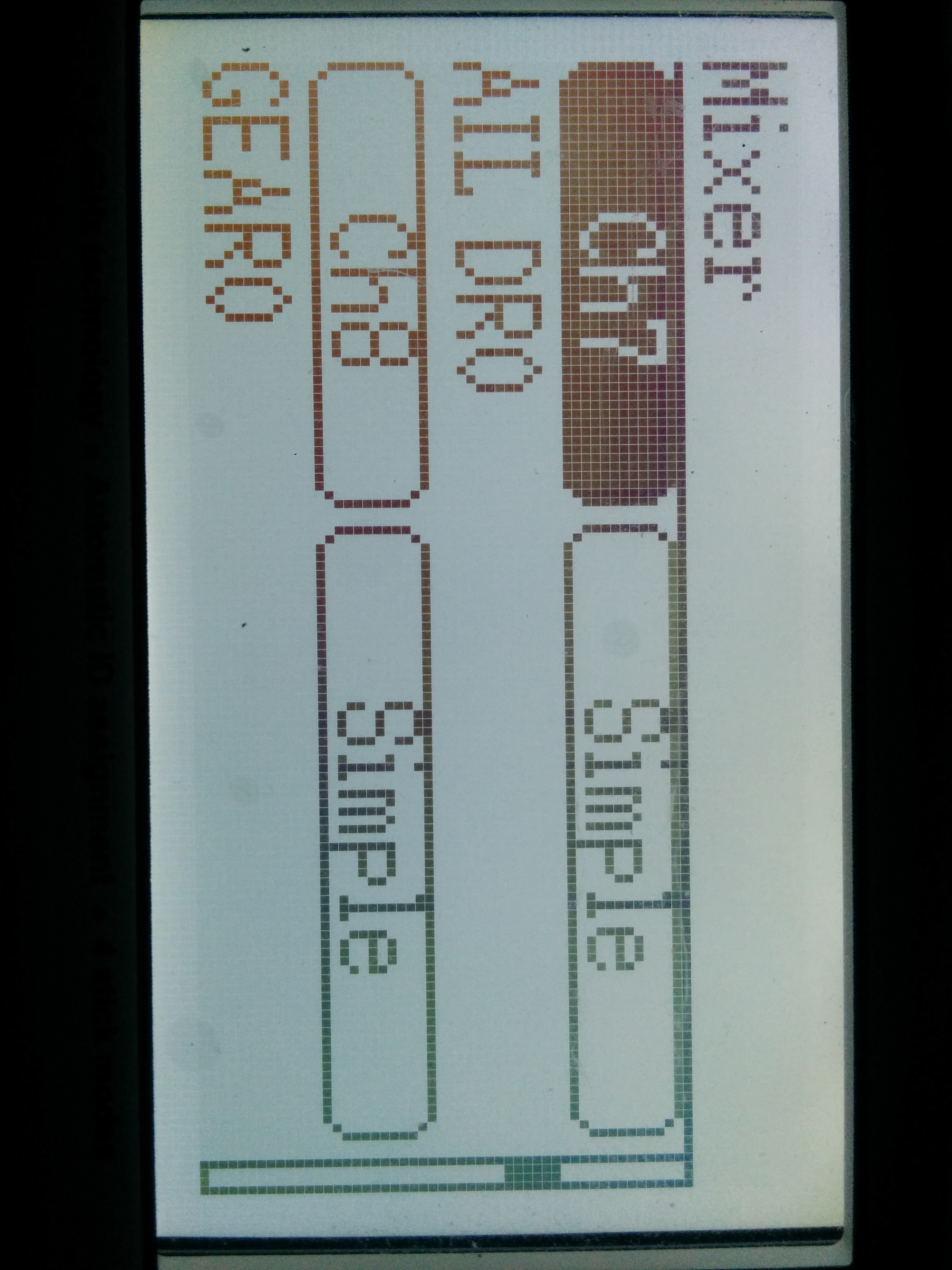

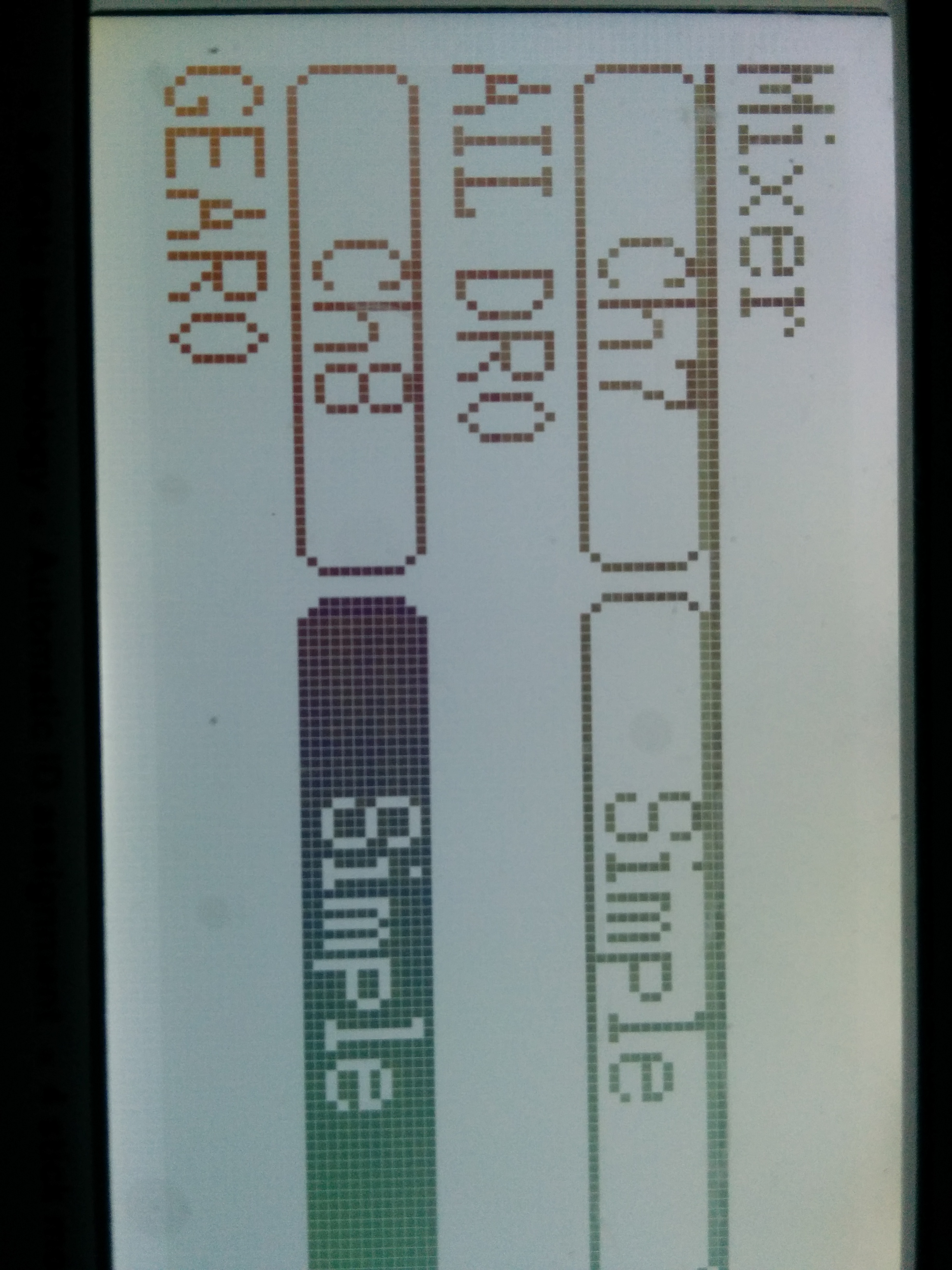

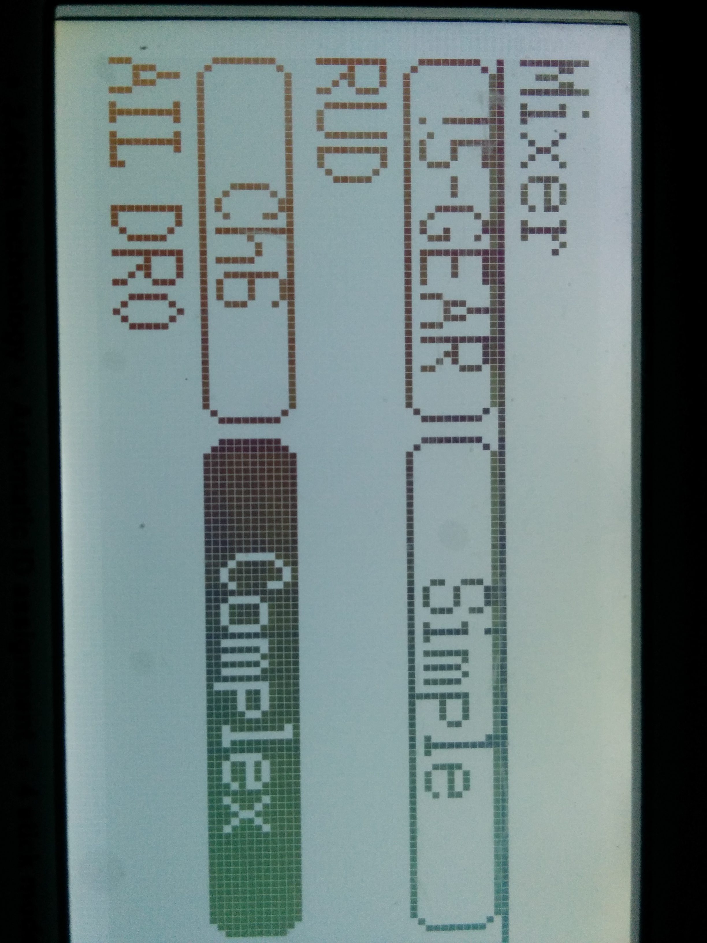

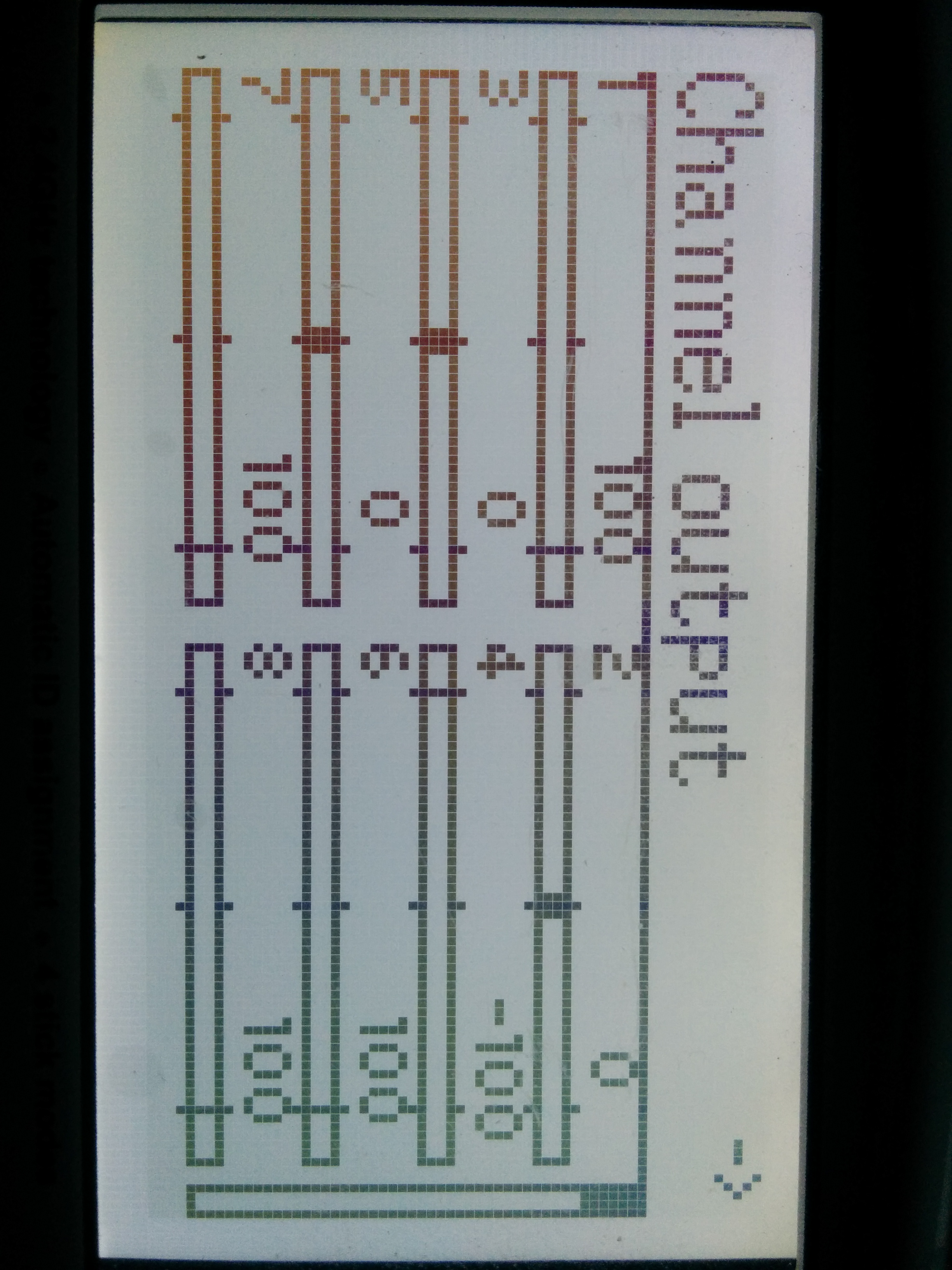

02 Jul 2015 18:44 - 02 Jul 2015 19:10 #35004
by liliass
Replied by liliass on topic Cleanflight with Devo 10 and RX1002
Last edit: 02 Jul 2015 19:10 by liliass.
- liliass
- Posts: 20
- liliass
- Posts: 20
03 Jul 2015 05:05 #35021
by liliass
with the above 2 posts. 8CH are working perfectly. but Cleanflight only detect CH2,3,4,5,6
But not CH1,7,8
But not CH1,7,8
