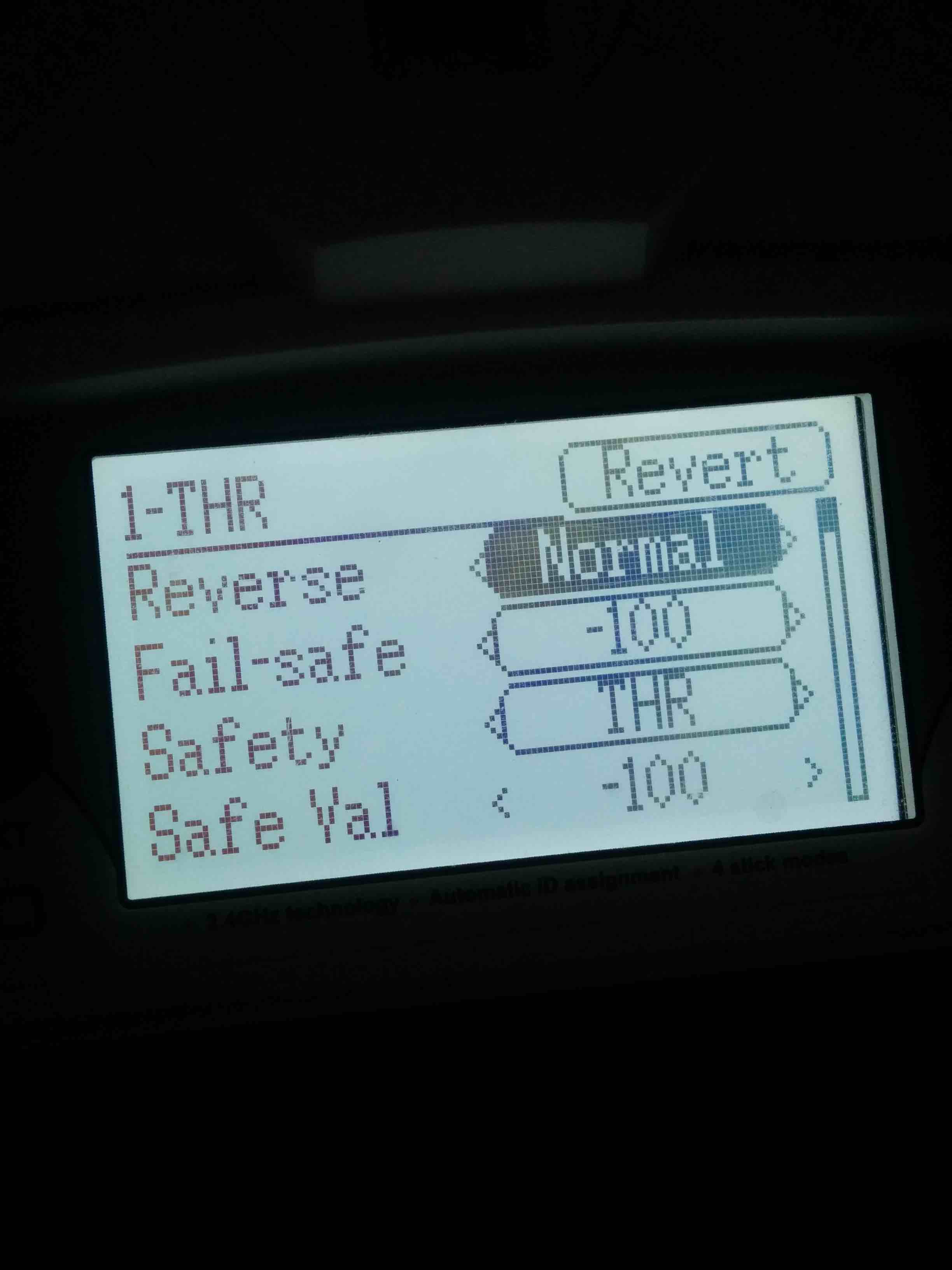

I got failsafe issue with my DEVO 10 flashed with DeviationTX connect with DSMX to my S603 RX.
This is what i did for failsafe.
REMOVE ALL PROP
1. Connect your PC to your Cleanflight, Click on MOTOR tab
2. Plug in the Battery
3. ARM your quad
4. give some throttle.
5. turn off controller.
from the MOTOR it shows that the motor #2 is running all full throttle and MOTOR 1,3,4 are somewhere 40-50% throttle.
I set my throttle failsafe are -110% in my controller. y does it act so weird ?
My setup:
Naze32 1.9.1 BETA
DYS BL20A 14.0
Walkera Devo 10 Flashed with DeviationTX 4.0.1
STORM S603 receiver
In my MIXER > THR > FAILSAFE -110
(sorry for my english, i'm asian)

10 Jul 2015 08:44 - 10 Jul 2015 08:46 #35300 by Thomas.Heiss
Replied by Thomas.Heiss on topic FAILSAFE devo 10 and S603 RX
In most cases -110% throttle setting makes no sense for electric motors anyway. Thats for gasser...
The signal should be -100% (=0% for ESC).
Thats the "safe" hold / throttle cut signal.
Not sure why DeviationTX has separate failsafe menus and letting you set concrete failsafe values for each channel.
Probably will not work with DSMx. Do they work with DEVO receivers??
For many Spektrum receivers only THR port has failsafe and other receiver ports have hold last command.
Some receivers (e.g AR8000) will let you set a PREST failsafe value for each channel.
You will need to set this up on binding.
Not sure about the Storm receivers....
So for a 4 motor quad you REALLY have to setup failsafe in the FC as Cereal_Killer described it.
But you should really set DeviationTX safety (throttle cut / hold) value to -100, otherwise the ESC might learn -110 as the lowest (0) value.
I had seen that already with auto learning ESCs...

11 Jul 2015 00:08 - 11 Jul 2015 00:14 #35316 by aMax
Replied by aMax on topic FAILSAFE devo 10 and S603 RX
Cereal_Killer wrote: Setting FS in your TX does nothing, cleanflight failsafe works great, you need to set it up. Dont think for a second that setting that in your TX is going to save you, not sure what that is but if you loose radio connection how is a setting in your radio going to help?!...........
But not with all receivers.
E.g. my 615X sets the throttle to 1126 in the case of signal loss. This is quite high because my
motors are set to 1070 for lowest spin
That's the reason why I could not activate the failsafe with this rx. Anyway, changed it for a
S603 which is at 960 in the case of failsafe.
If the FC takes over the command, it even pushes the other channels to neutral, which the rx does NOT....
For the time of failsafe_delay they stick at the last input. But I can deal with it.
Last edit: 11 Jul 2015 00:14 by aMax. Reason: typo
11 Jul 2015 00:50 - 11 Jul 2015 00:56 #35317 by aMax
Thomas.Heiss wrote: Not sure about the Storm receivers....
But -100 is not the position where the motors are off, it only prevents the tx to send a throttle command obove that value.
I calibrated the esc via gui and so the lowest command is at -112 and I had to set the hold switch for arm and disarm to -134.
Otherwise i can not reproduce a motorstart at pwm 1070 with my Devo.7e. Keep in mind, you send the throttle position
to the FC, not to the esc.
Last edit: 11 Jul 2015 00:56 by aMax.
