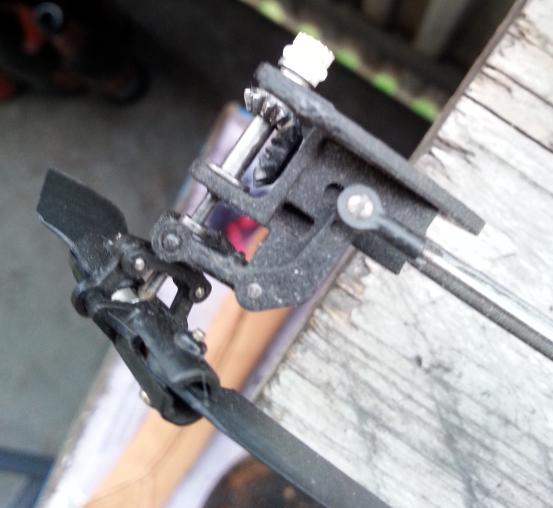

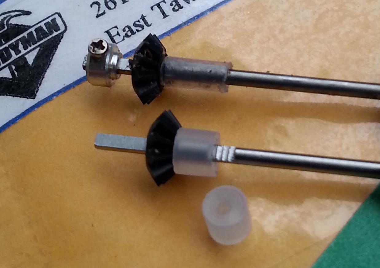

19 Aug 2015 17:46 - 19 Aug 2015 17:48 #37043 by ThomasC
Replied by ThomasC on topic Devo 10 loses control randomly?
Ah, okay, I see. With A-gear i always refer to the driving part connected to main shaft (for the Walkera, A-Gear is part of the main gear). I must admit that I don't remember part of the instruction to modify what I call C-gear. See attached photos. This is the S version?
Photo1: on top the original. Below your version.
Photo2: benmlee'd version of D02s tail. Sorry for bad quality (mobile phone camera)
Last edit: 19 Aug 2015 17:48 by ThomasC.
19 Aug 2015 18:04 #37044 by livonia bob
Replied by livonia bob on topic Devo 10 loses control randomly?
ThomasC wrote: Ah, okay, I see. With A-gear i always refer to the driving part connected to main shaft (for the Walkera, A-Gear is part of the main gear). I must admit that I don't remember part of the instruction to modify what I call C-gear. See attached photos. This is the S version?
Yes it looks like the "S" one to me. If you didn't follow the instructions and remove the tit on the back of the B gear it will not work.. As you are using the wrong gear names it's clear you didn't read the instructions where the gear names are explained so I'll guess you just didn't remove the tit there for you thought the tubing was to large.. The OD of the tubing is the same on either model just the length changes.
19 Aug 2015 18:11 #37045 by ThomasC
Ah, okay. So it was my fault - thanks for clarifying this. A big apology from my side for saying your clutch doesn't fit. The gear names I took from Ben Lee's instructions.
